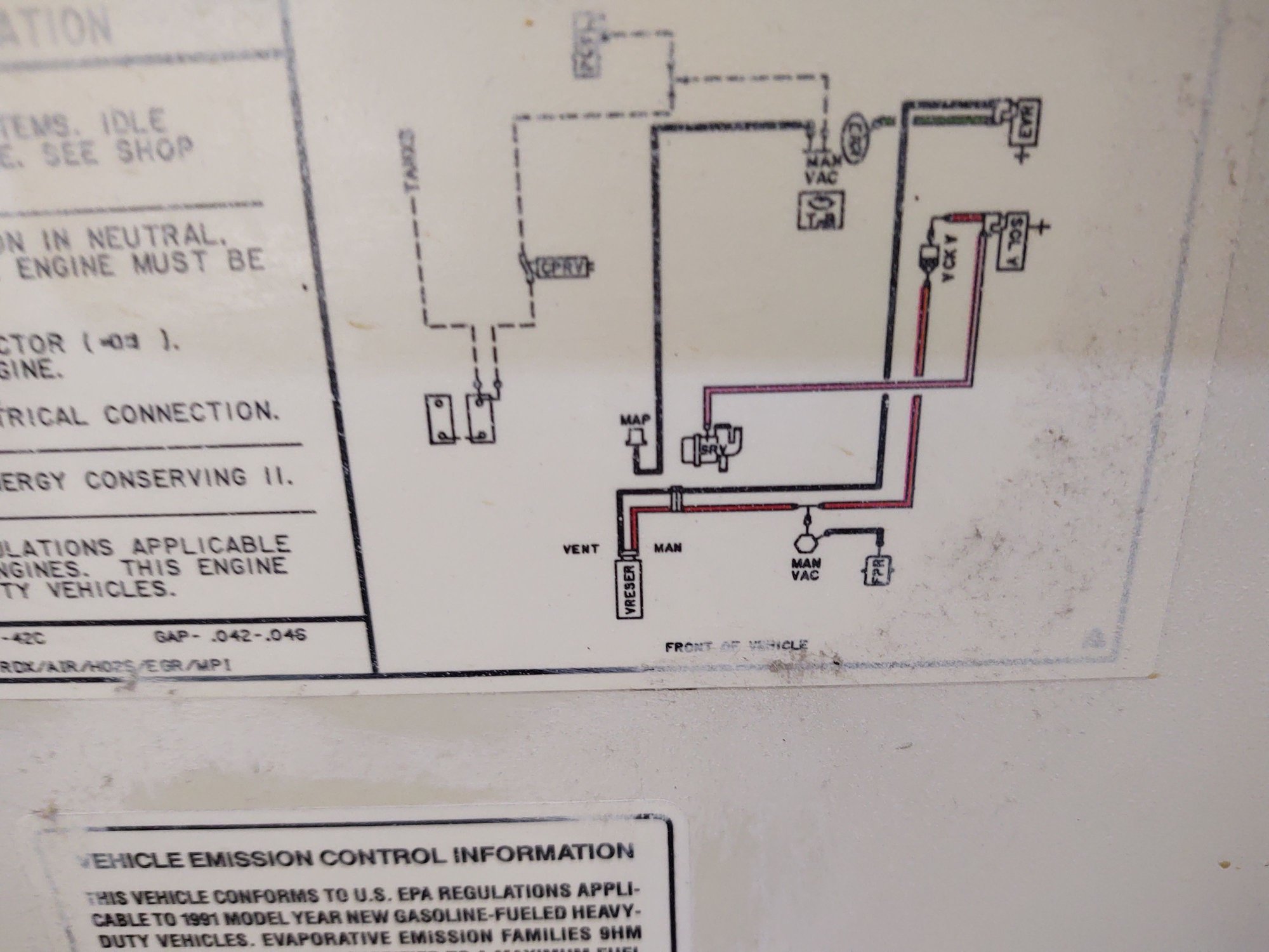

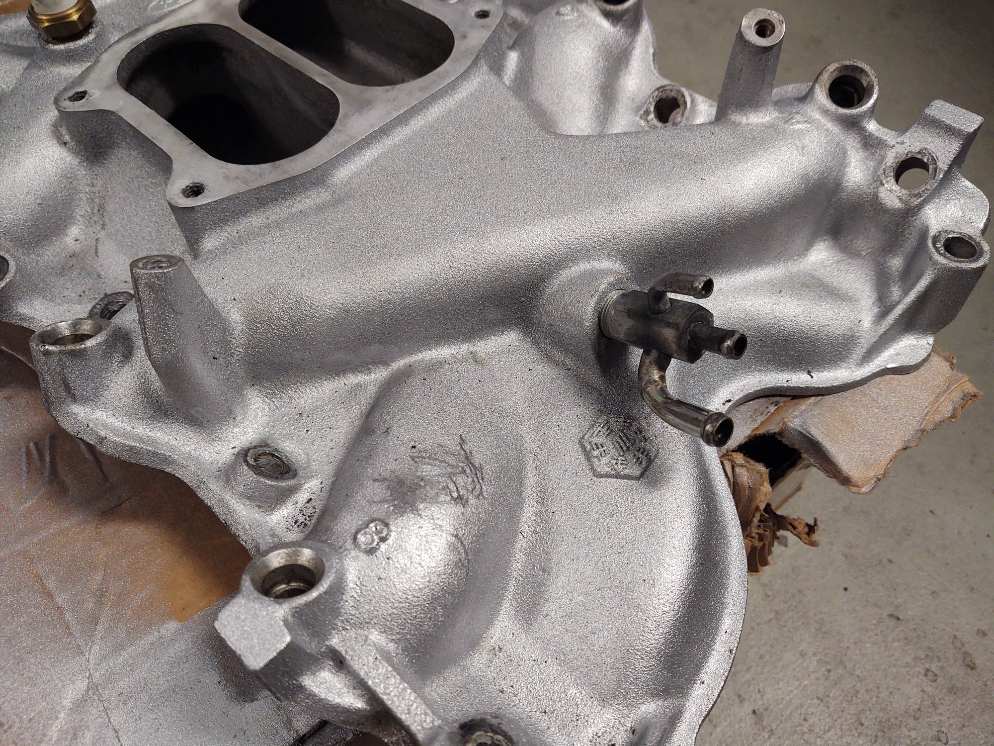

Sandymane, pic 1 is my vacuum diagram sticker. Pic 2 is the 2nd vacuum line off my vacuum tree. Could not figure out how to attach in a pm. So posting here. Hope that helps.

Here are some pics of what I have
upper intake two lines
three lines on back tree

Sandymane, you have a completly different vacuum tree than I have. Back of upper intake is same tho. Should be 1 to heater control. 1 to pcv valve. I would assume vacuum tree is similar to mine. In which case 1 to hvac box, 1 to reservoir. All else capped off. Wish I could help you more. Sorry
