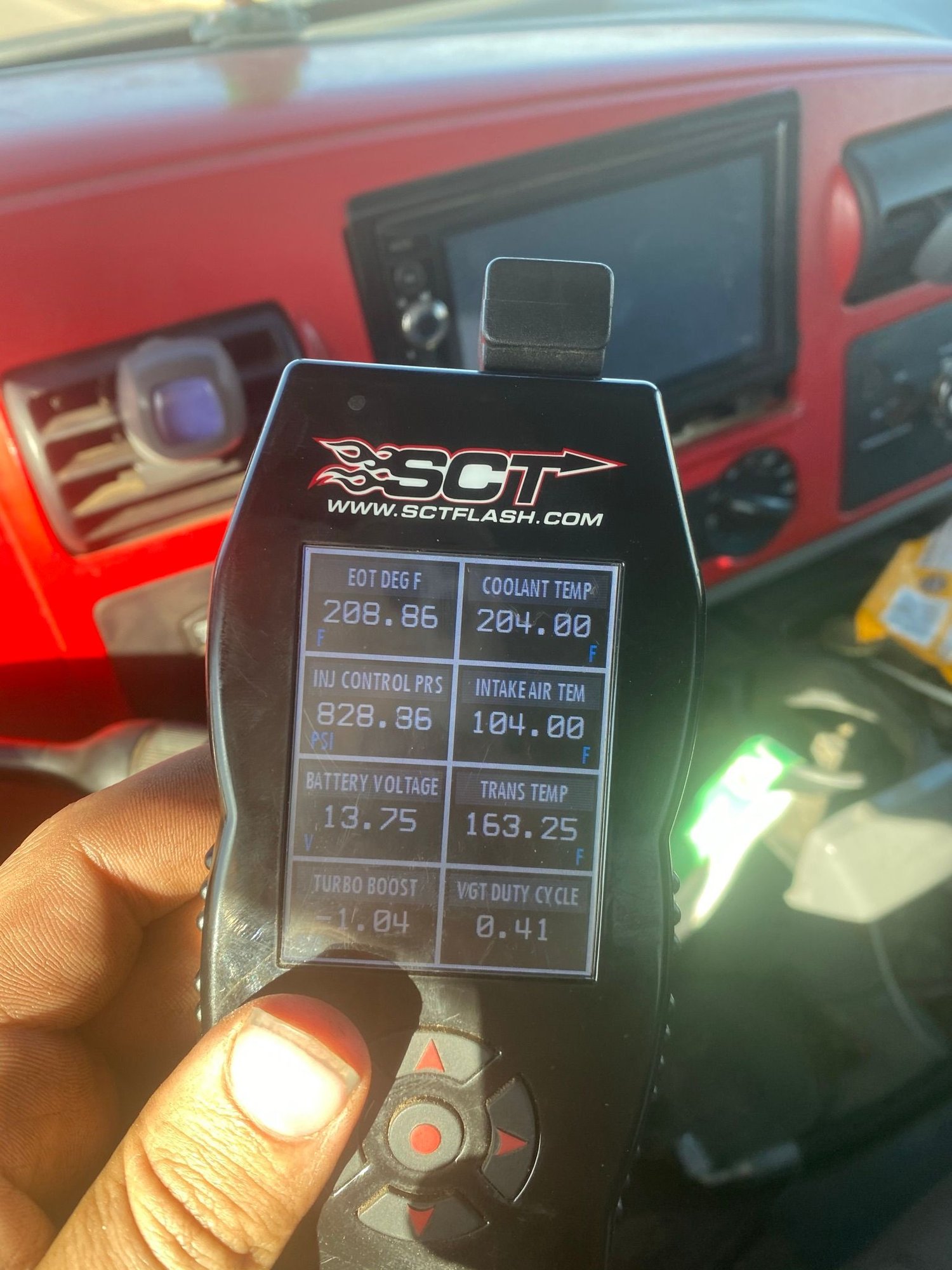

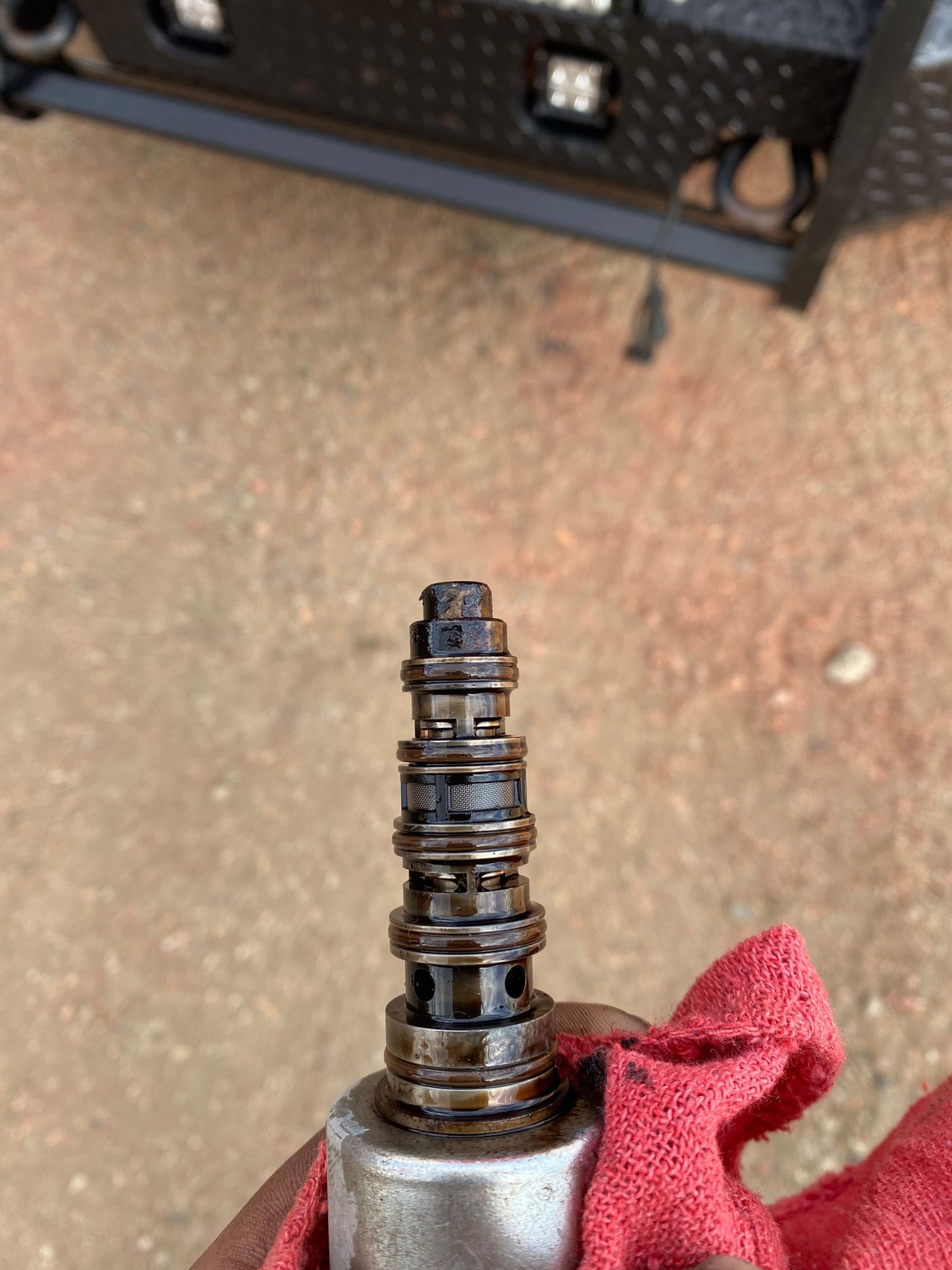

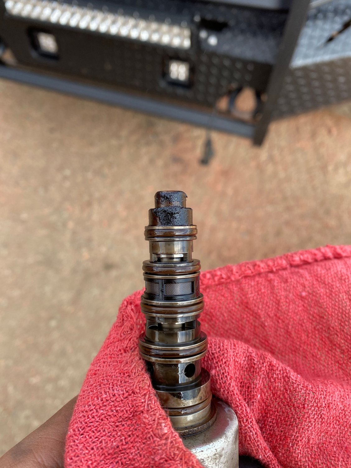

I have a 2005 f350. It’s studded, egr delete, wicked wheel in the turbo, fass lift pump, and spinster diesel turbo piping. I’m running blessed performance tunes off of a sct x4 tuner. While driving down the road the veins in my turbo seem to start opening and closing at random. This only happens some times and nothing seems to cause it. It will just start doing it then stop. Changing my tune has no effect on it and my coolant and oil temps both spike when I’m having this issue. I just put a new vgt solenoid on it which produced no change in the behavior. While doing 70 down the highway my vgt duty cycle will go up to 85% and completly close the veins resulting in 40+ pounds of boost, then in an instant open up to 30% and my boost will fall of. It can jump all over the place as well cycling from 50 to 80 down to 40 and back up in the matter of a couple seconds.
The pickup can go from running amazing to having this issues in a matter of a second. I know the vgt duty cycle is just what the solenoid is trying to push and actually not what the veins are opened up to. However I can hear the difference in turbo noise as this number jumps around and makes my boost surge and fall off. I have no explanation for this and I’m out of ideas. Ive attached a picture of my tuner with my oil and coolant temp spiked and pictures of my old solenoid after I pulled it out. Please help
