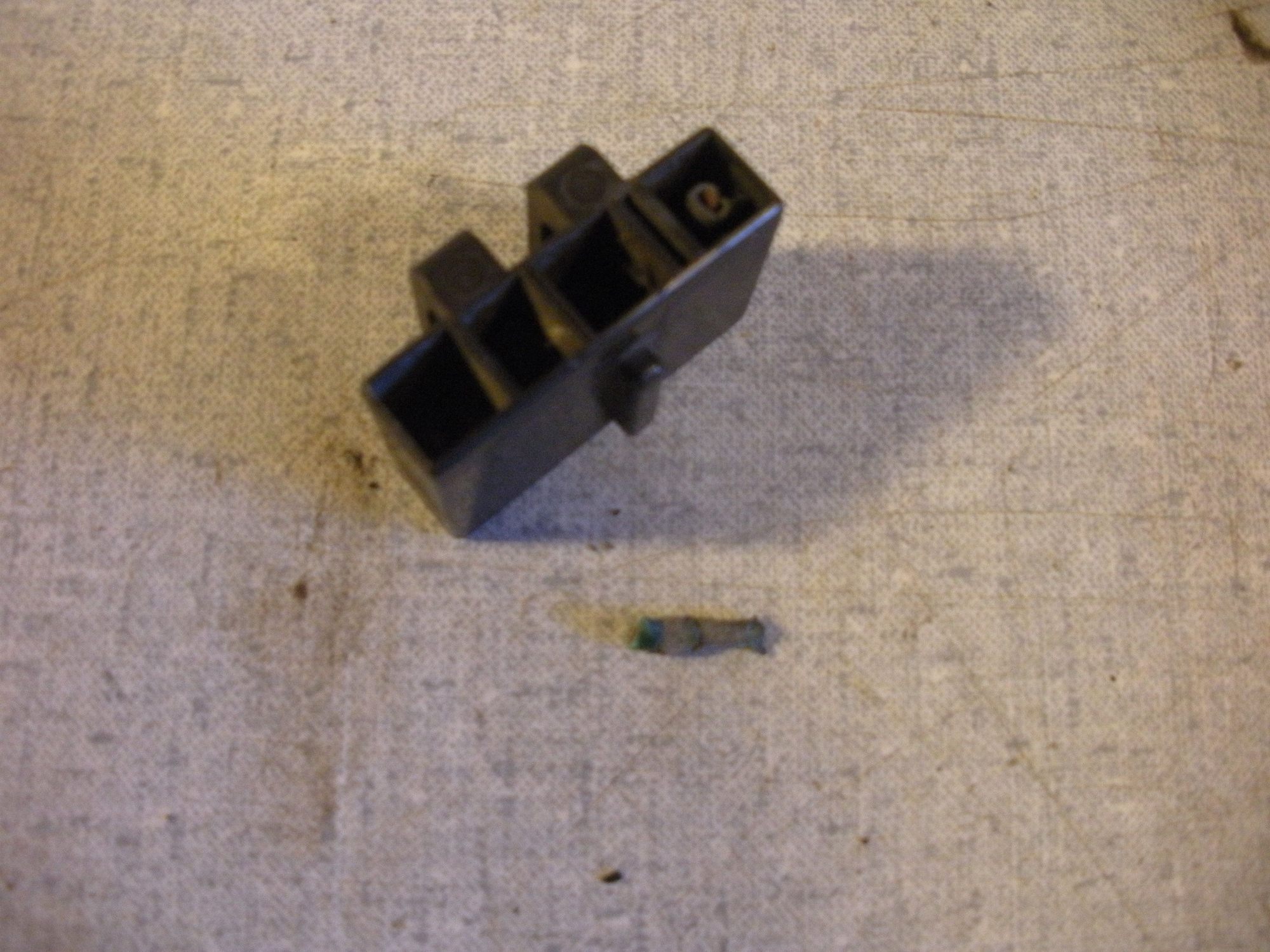

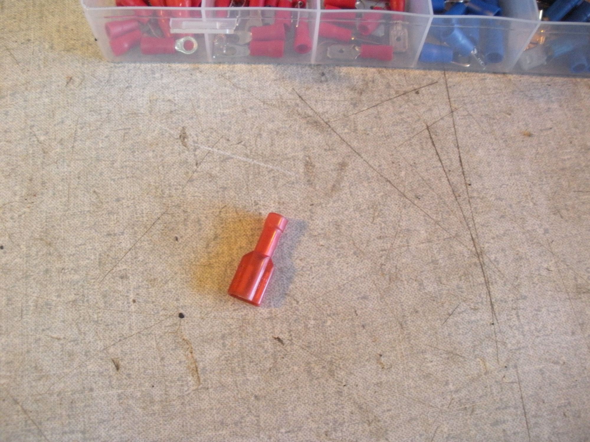

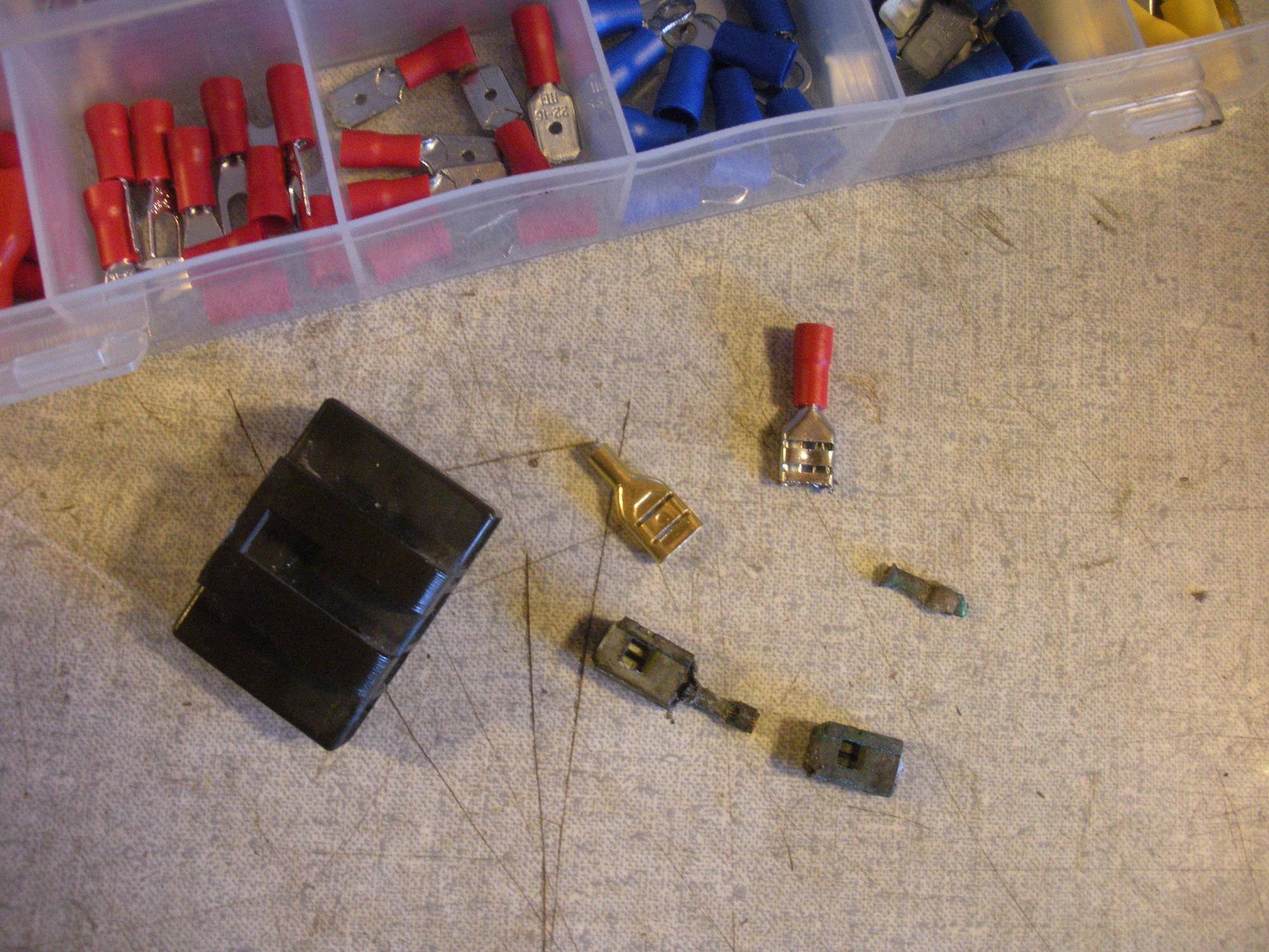

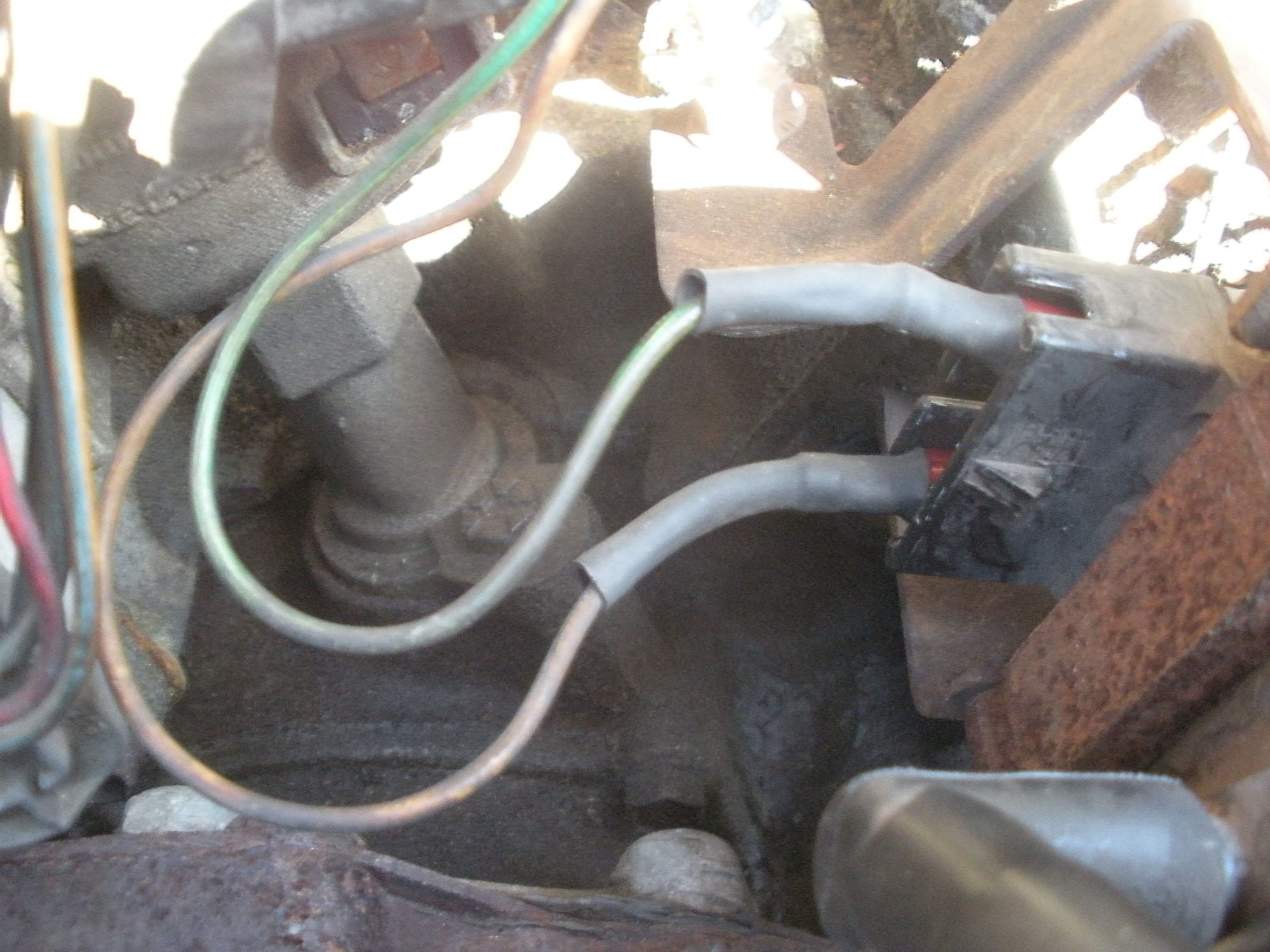

Here are some pictures of the old female from the Ford connector. The Ford ones are more of a box style. The new terminals would not lock into the Ford connector.
I did push some of the 3M grease into the end of the shrink tubing.

The Correct ones.
Just match you wire gauge and pick your terminal.
https://www.clipsandfasteners.com/Fo...e-p/a14889.htm
https://www.clipsandfasteners.com/Ford-Standard-Box-Electrical-Terminal-16-14-Gauge-p/a16348.htm
These terminals are used all over the truck so would not be a bad thing to have some on hand regardless.
