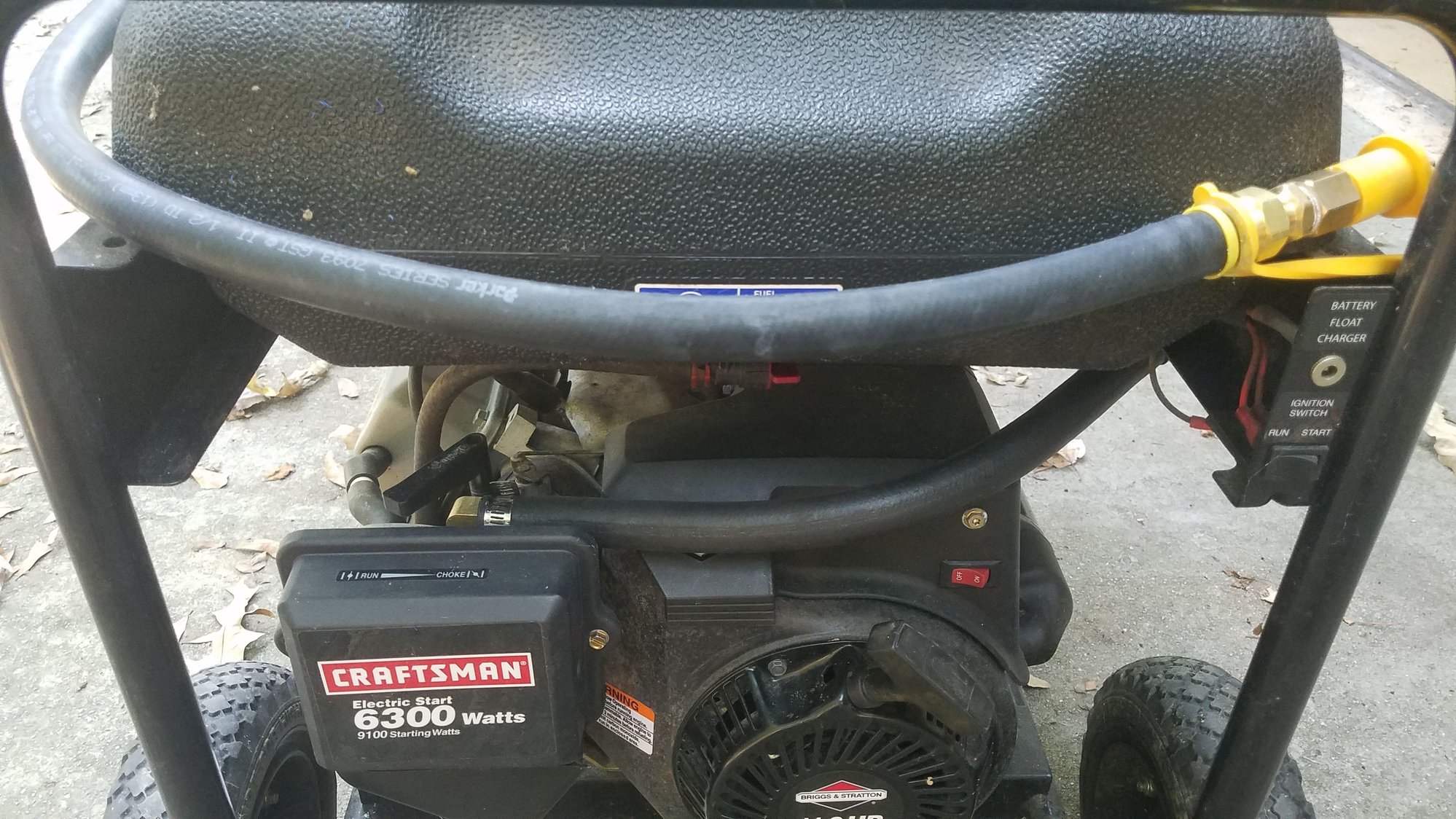

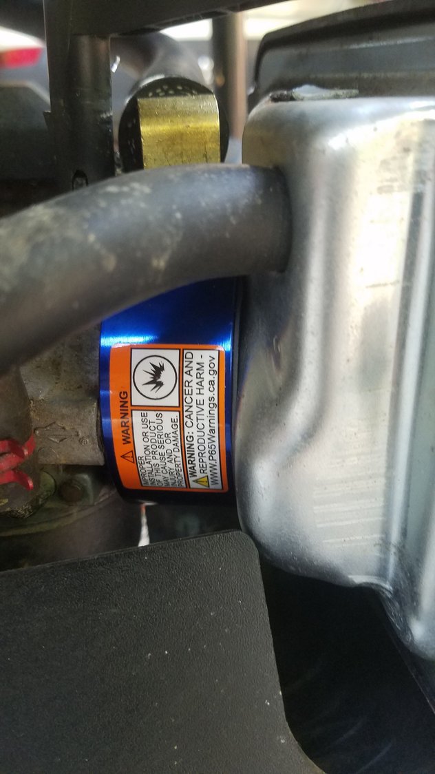

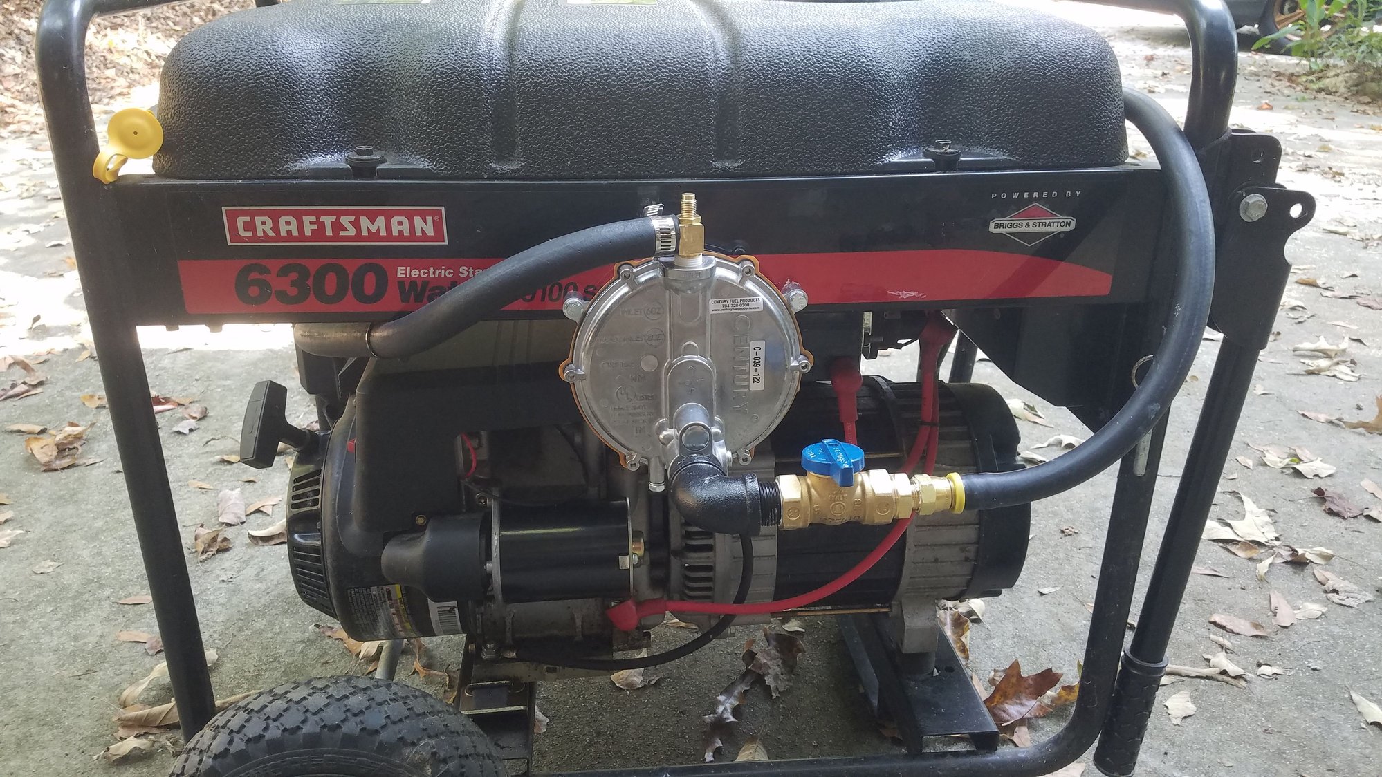

Well, that was easy!
Since I installed 3/8" quick connects on my Westinghouse suitcase generator last time, I used a leftover QD for the big generator.
Everything went together great and it fired up on the first pull.
I adjusted the throttle screw a bit and put everything away.
Nice to have the tri-fuel capability if we need it.
Regulator mounted to frame and supply hose routed around tank for storage.
Engine side with supply line going to carburetor adapter from regulator.
Carburetor adapter between air box and carburetor.
Fired up and running smooth on propane.

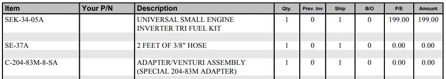

I will have to look through my email receipts to see if I have any part numbers. I originally called Zack at https://centuryfuelproducts.com/ in order to purchase what I needed since the iGen 2500 was not on the website.
He sent a kit that fit the carburetor and other parts that were universal like cutoff valve, hose, etc.
I'll update tomorrow when I have access to my laptop.
Old Jun 8, 2022 | 07:04 AM
  #28
Sous's Avatar
Sous
FTE Leadership Emeritus
Joined: May 2014
Posts: 27,357
Likes: 5,953
From: Lake Hartwell, GA
FTE Emeritus
I purchased the following kit/parts from Zack at Century Fuel Products on 2/26/21.
After the purchase of the specialized parts, I researched and selected QD fittings and adapters to use the external propane nozzle on the 5th wheel. This allows me to use a propane tank from a BBQ or the tanks within the 5th wheel within just a few moments.
I hope this helps.
