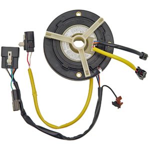

Greetings...specifically, where is this "common single brush contact in the steering wheel" located? This may aid in my search for why my horns are always blaring away. Pulled the air bag pad from my steering wheel to check the wiring from the horn switches and they all look pristine. Thinking that this "contact" may be fused. Thanks for your help...S
Old Apr 20, 2021 | 04:47 PM
Franklin2's Avatar
Franklin2
Joined: Jan 2001
Posts: 57,025
Likes: 2,756
From: Virginia
On a 1995 they called it a "clockspring". Do a google search on 1995 clockspring. Here's what it looks like. You know it's a common failure piece when Dorman makes them.

It was my understanding that, when the clock spring fails, the horns do NOT work. Whereas my horns are on ALL the time. With the Key Off, Engine Off, I get an energized horn/speed control relay with current to the horns fulltime. I remove my relay to save the battery. What is energizing the relay? A ground fault within the steering column? I doubt that the horn switches took a dump just driving down the road as I rarely use the horns. My research is leading me to possibly problems with the theft deterrant system RAPs.
Old Apr 21, 2021 | 02:35 PM
Franklin2's Avatar
Franklin2
Joined: Jan 2001
Posts: 57,025
Likes: 2,756
From: Virginia
You will need to unplug the horn circuit that goes to the clockspring, and then try it. If it still blows all the time, I agree it must be something else. If it stops, you know you are on the right track.
