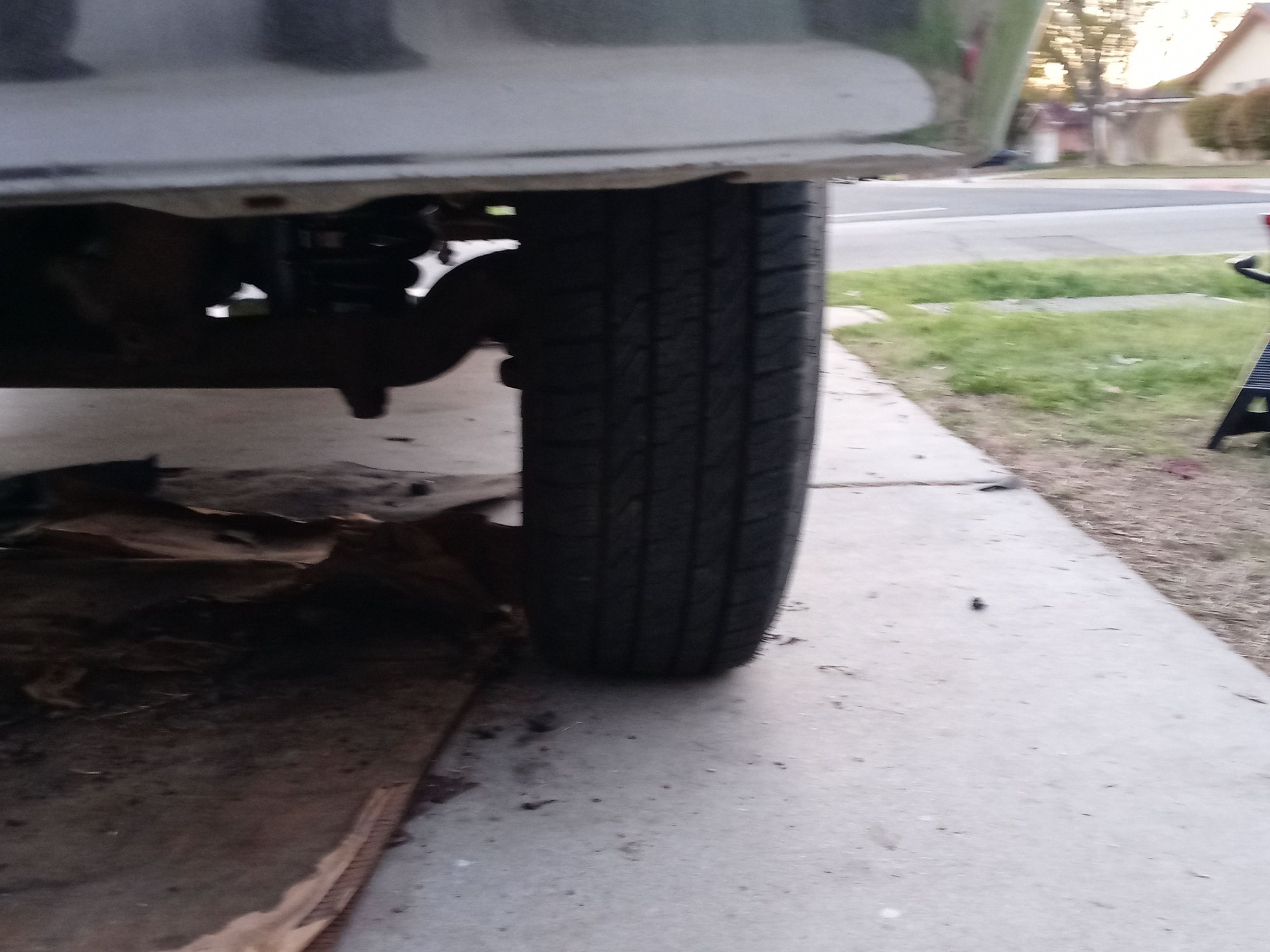

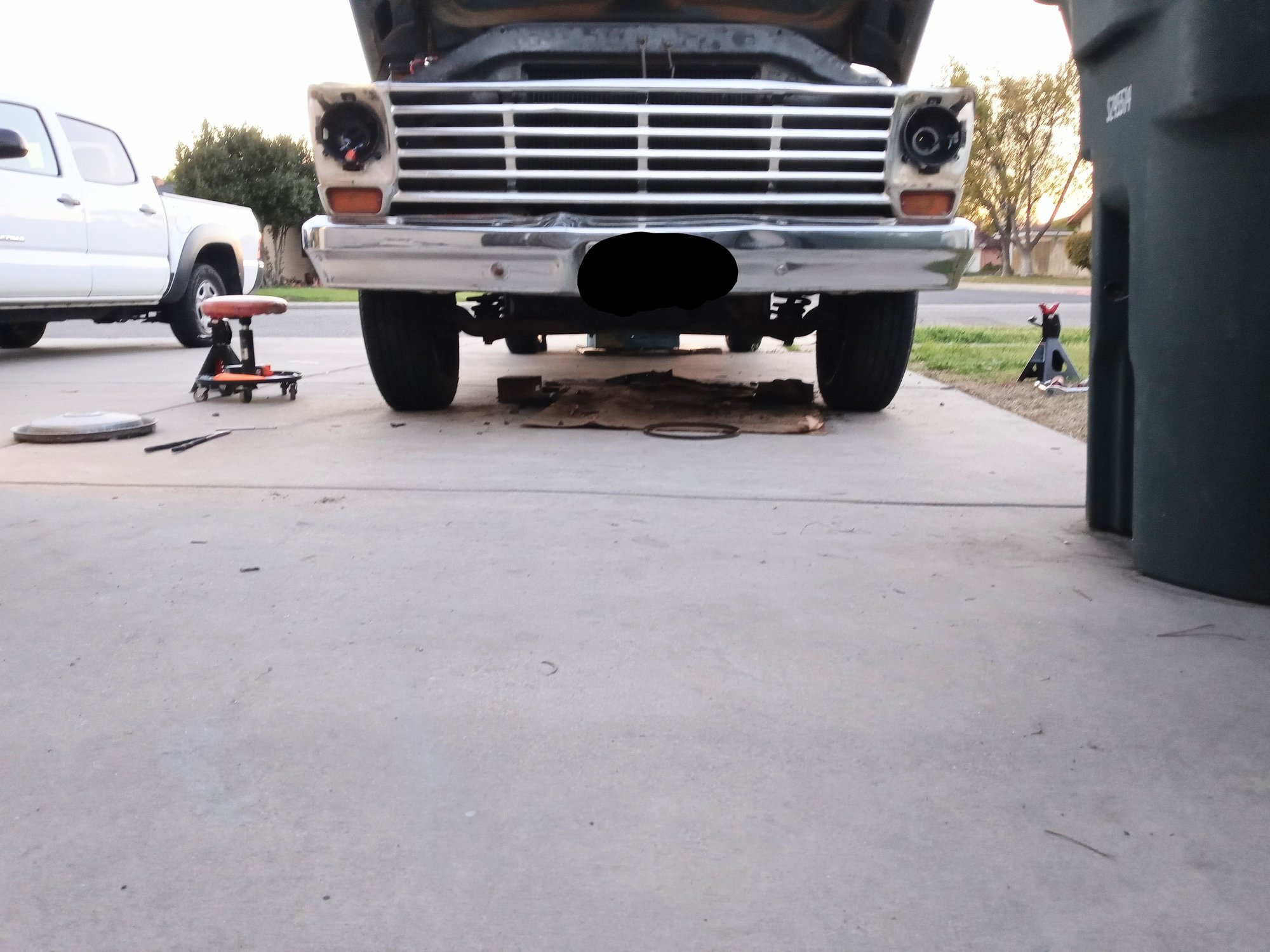

Ok just finished setting it back down. I know I still need to roll it and drive it to get suspension to settle but this is how it looks now.
The new shocks and spring raised the front about 2 inches.

Looks great! With it higher it almost looks like a 4wd!
