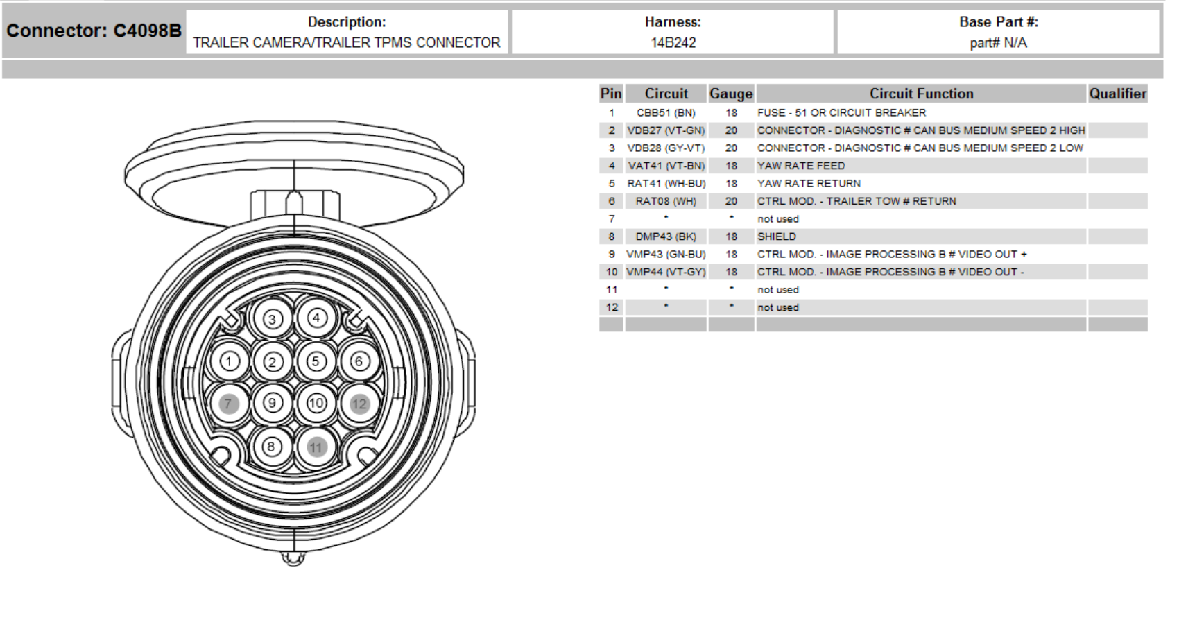

Damaged Connector
I have used this set up for the last year and love it. Unfortunately, the cable got snagged and all seven pins were pulled out of the connector. Now I need to know by wire-color which wire goes to which pin number. Can anyone help? Thanks.

@richmalpass Does this help?

Do you know which pins are the + and - inputs for the camera power? Are they the pin 1 + and pin 6 -? I have a '22 F350 Lariat. I don't have UTT and I'm attempting to add a trailer camera by "splicing" into the tailgate camera circuit and using a trailer camera kit. If anyone might have a pin-out for the 6 pin molex connector for the tailgate camera, that would be greatly appreciated. Thanks for any help I can get.
