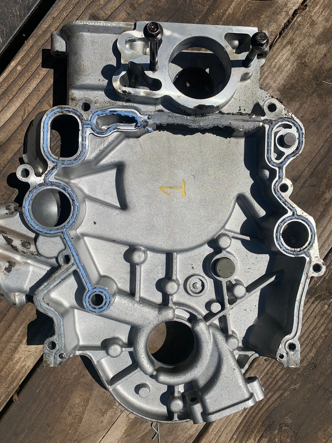

Old May 11, 2021 | 04:24 PM
F100Gasser's Avatar
F100Gasser
Joined: Aug 2014
Posts: 77
From: Sacramento
Hey guys, I’m back lol. I finally had time to pull the cover off, just undid everything and hooked it to a cherry picker. I pulled the cover off to that there in fact was silicone where it needed to be. I did find a small corner of the gasket was broken. Would that be enough to cause a major oil leak? And is this too much silicone? It looks like it spread out side the gasket slot, would that cause it to not mate well to the block?

That will cause a leak. Get new OEM gasket and slap a small dab of MC TA31

Yes, that will definitely cause a leak like you described . I think you found your issue. Keep us posted!
