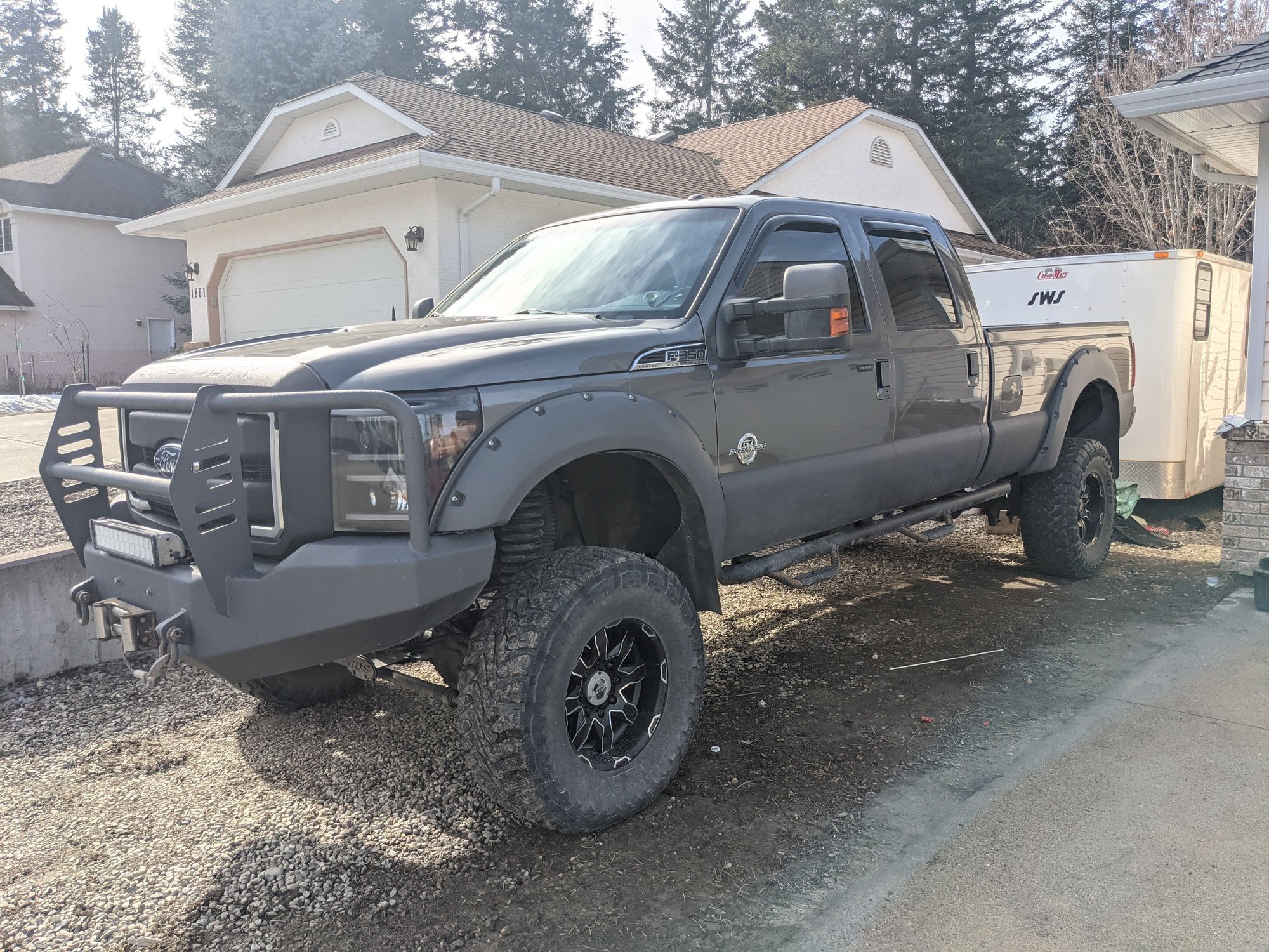

I will. All my Ford's are deleted. Have a 7.3 and 6.4. this is my first 6.7! Looking forward to it and have lots of time to work on it. No rush to get her on the road. Just want power and black smoke baby!
That's her there!

Originally Posted by h3ckler
awesome thanks brother!
That's her there!
Try to forget about the black smoke part! That is what is bringing the EPA down on all of us and aftermarket manufacturers. Save the black smoke for the track!!!
