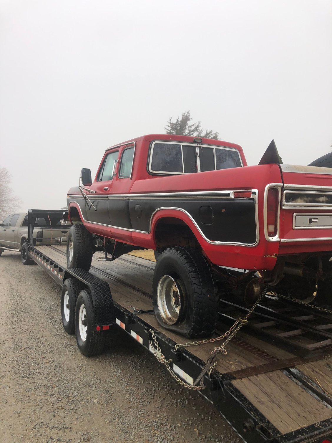

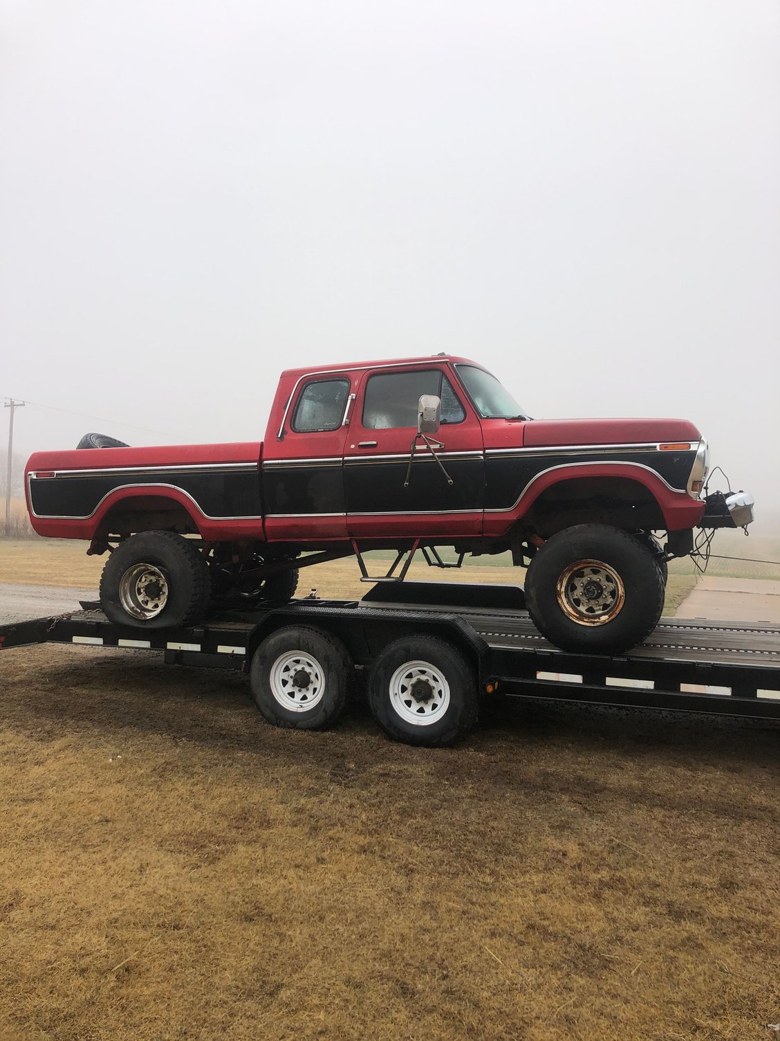

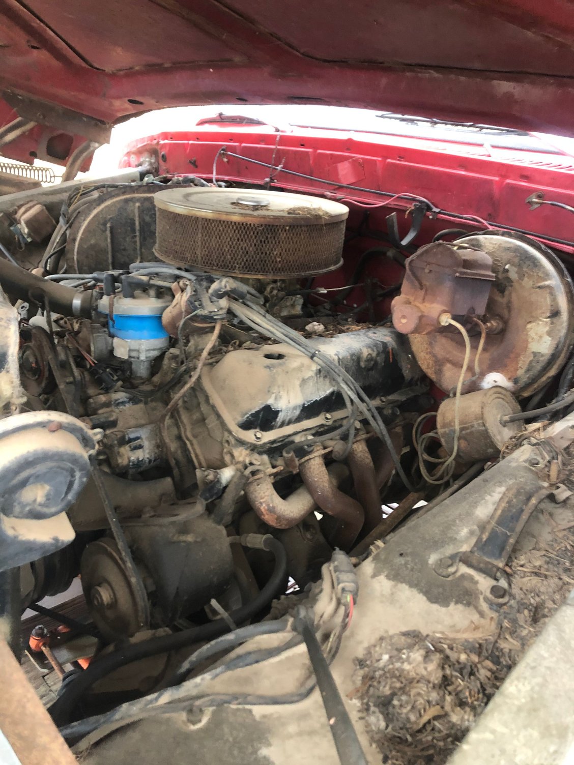

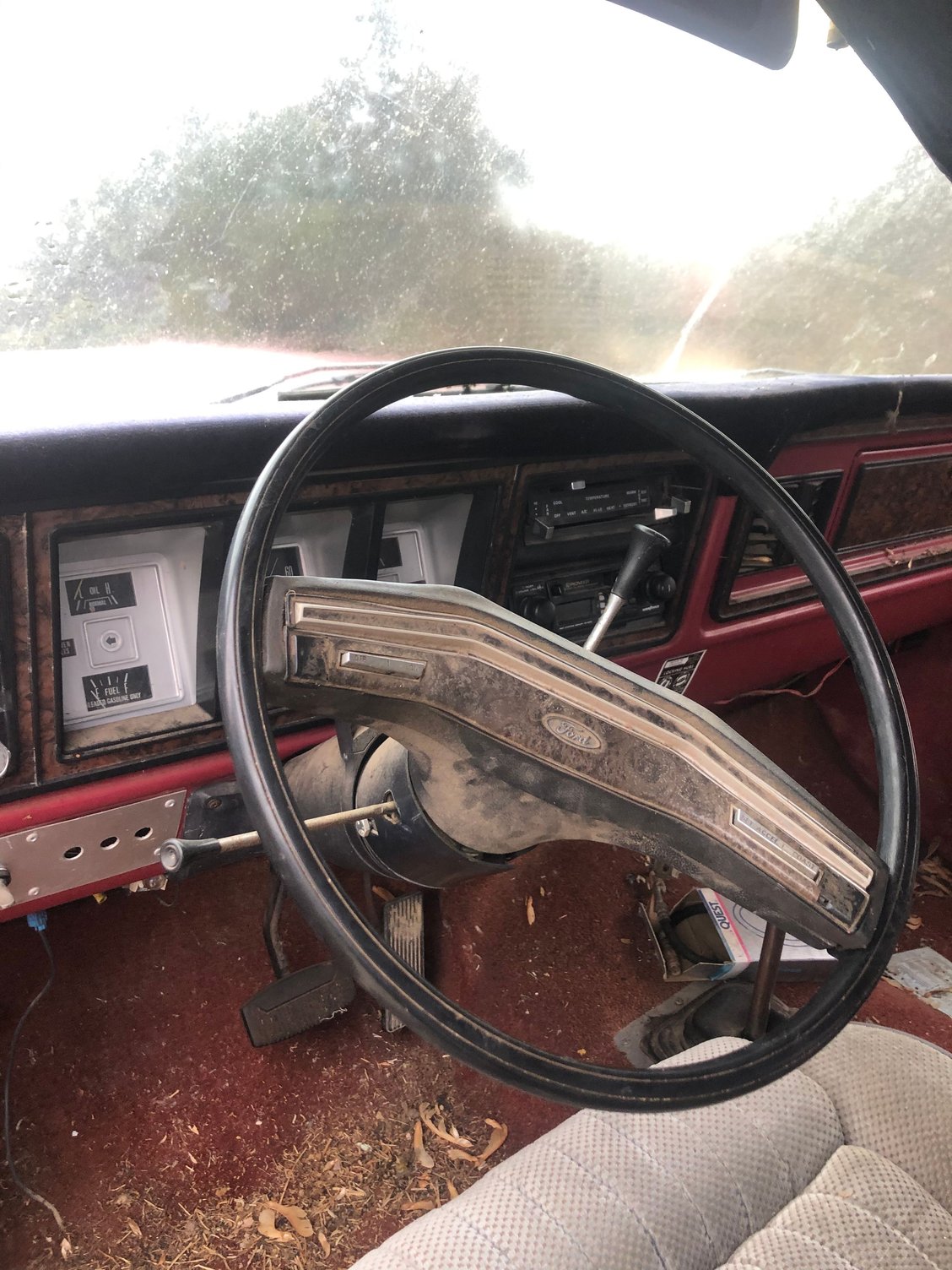

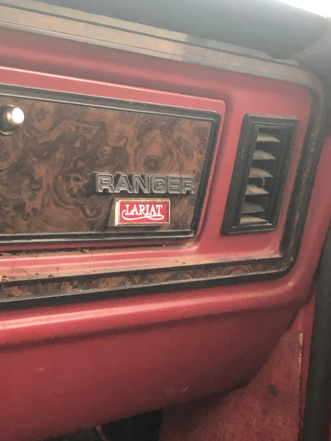

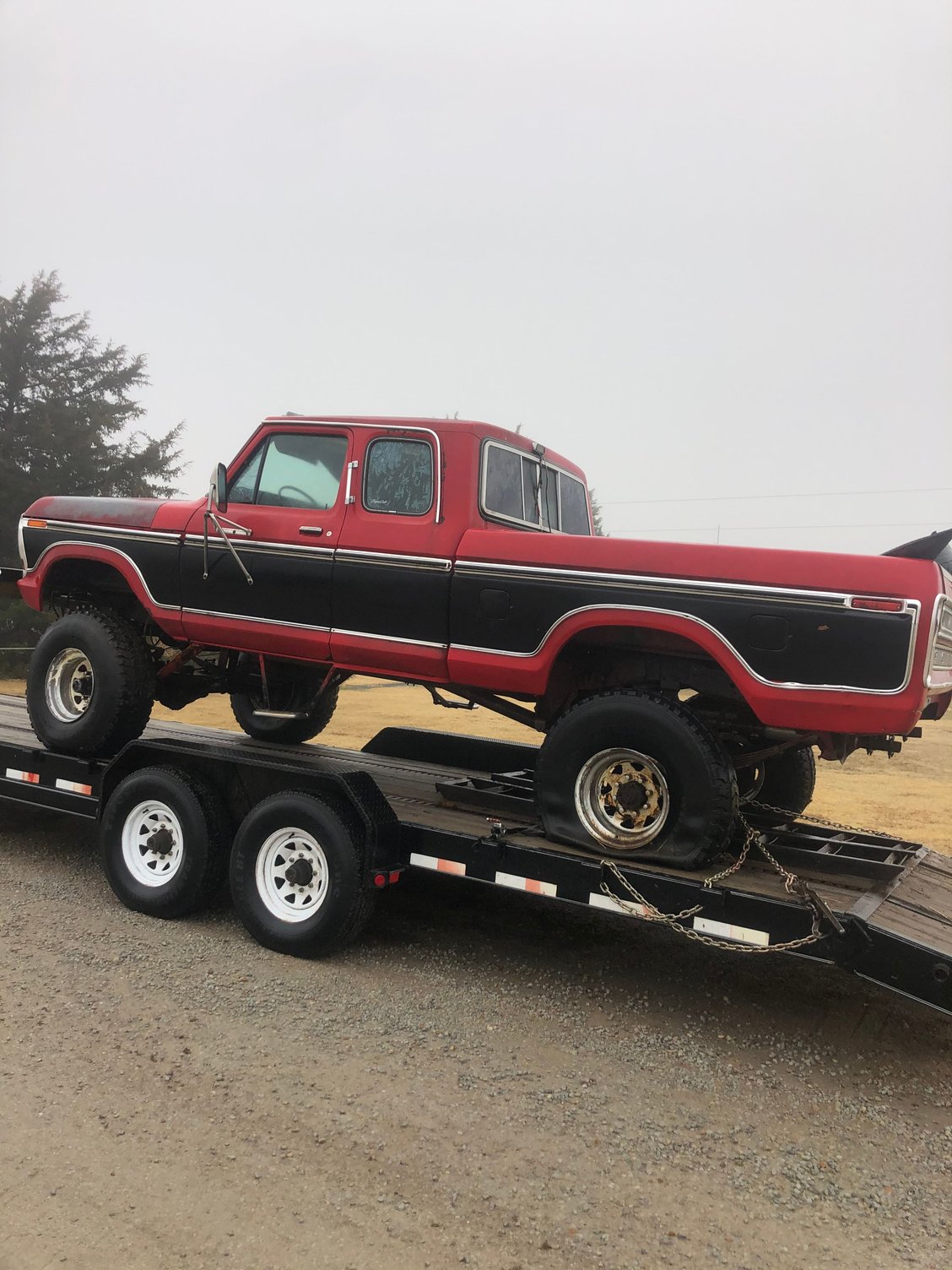

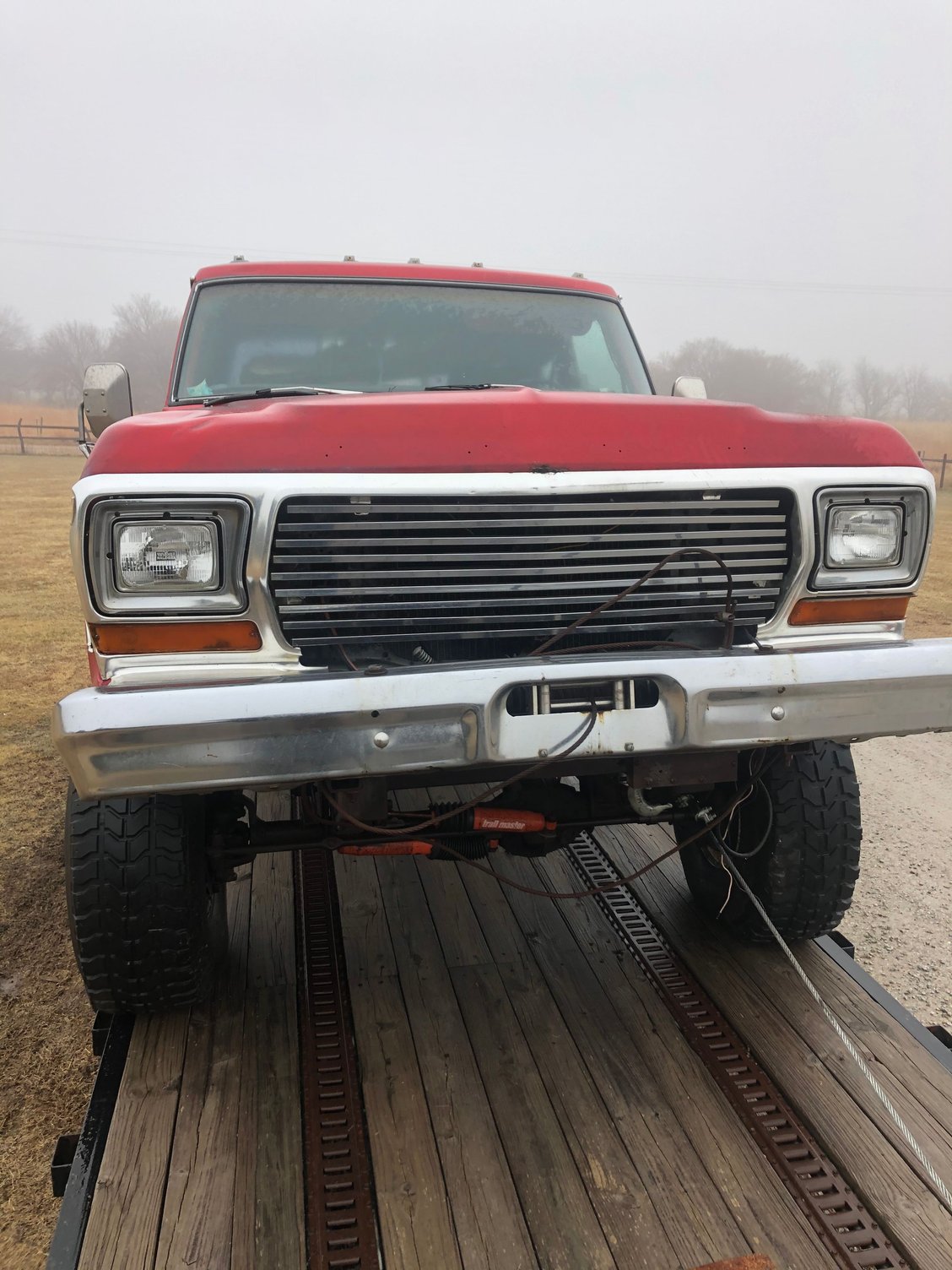

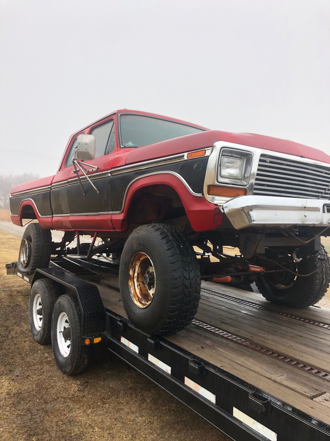

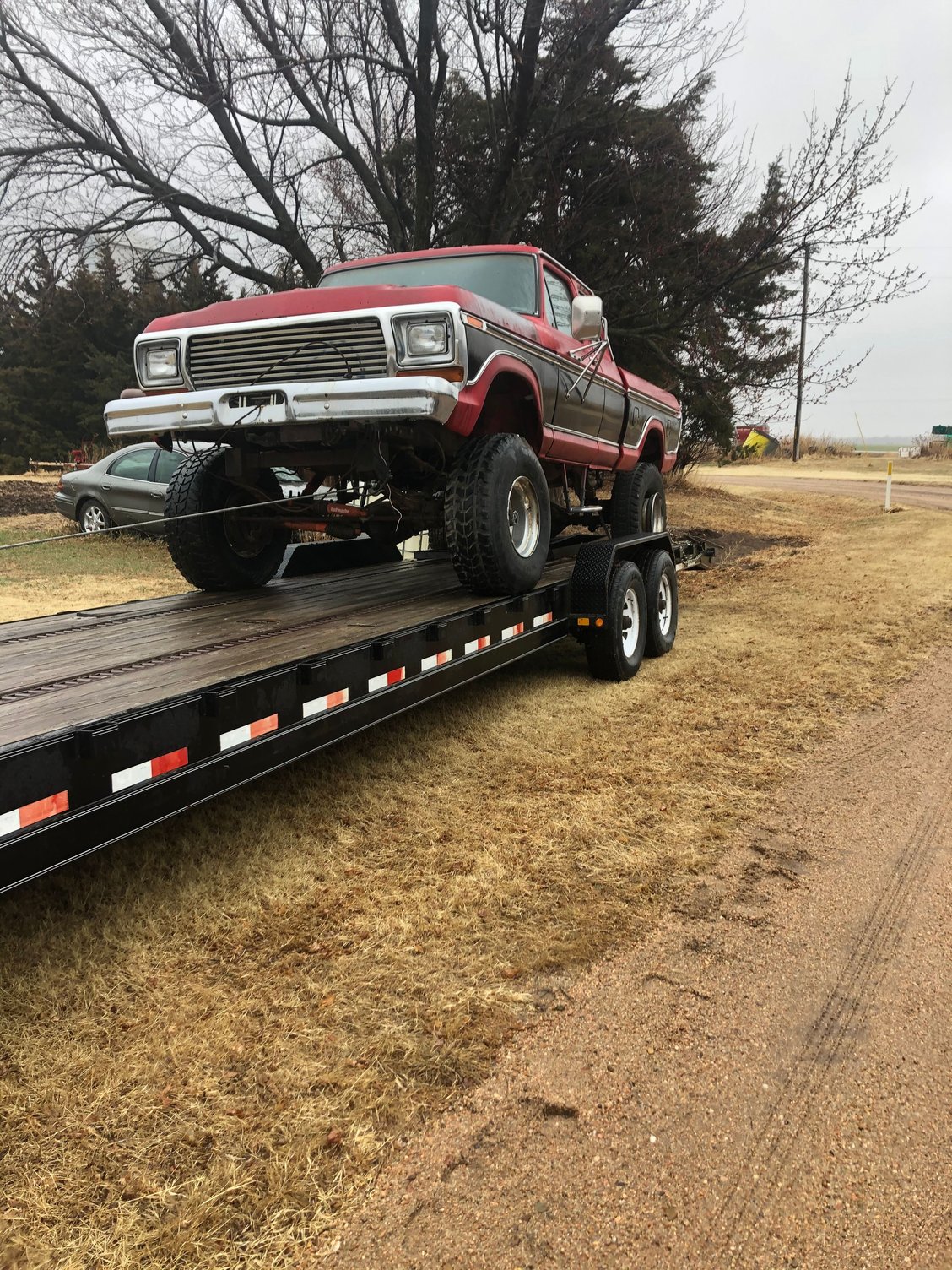

Finally was able to get a 79 super cab bought. Has a 460, blown auto trans. It’s all jacked up but will put it back to stock. Been sitting since 05. It’s a short bed with lariat package. Really pretty rust free. A long ways to go on it. Gave $1500

That's pretty amazing.... it's that rare combo of super cab, short box and 4wd that just makes it.
So, what's the plan for it? New trans, lower and drive.... or restoration? It's a perfect candidate for either really...

I’m about to wrap up my 76 highboy restoration in next couple weeks. I think the SuperCab needs a full resto job Back to original. All the original spring hanger are gone so get those bought and drop it back down. It looks hideous jacked up like that

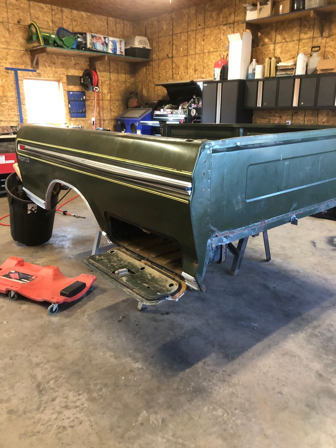

heres my 76. Hope to get bed blasted next week and paint in next couple

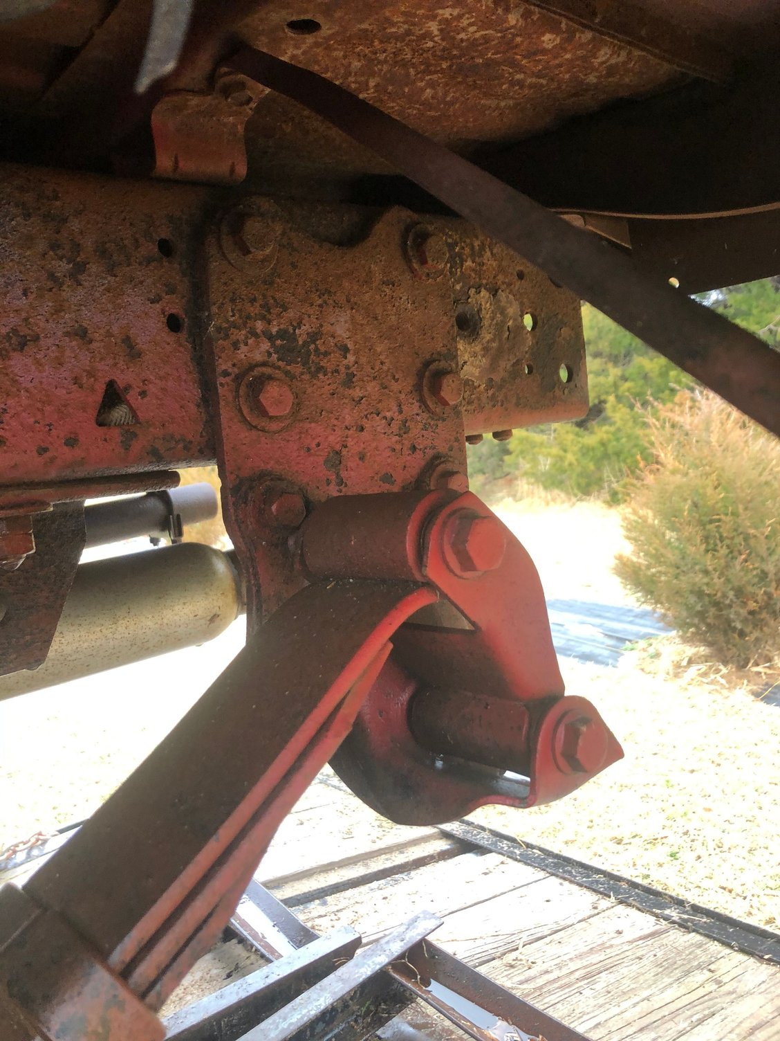

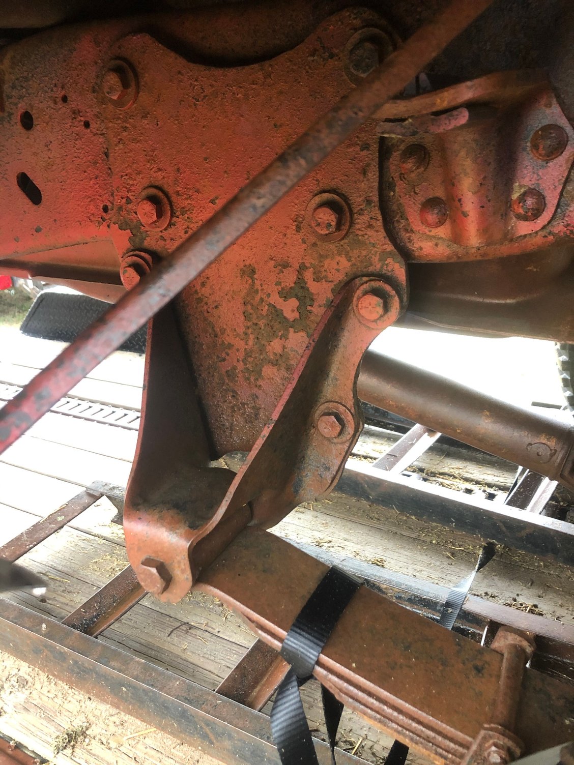

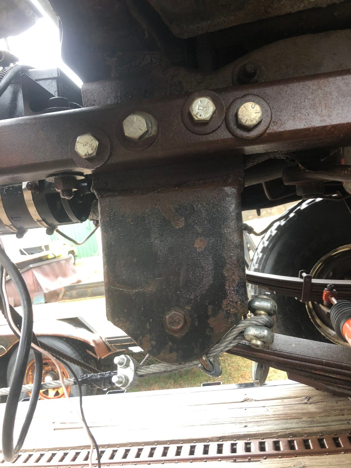

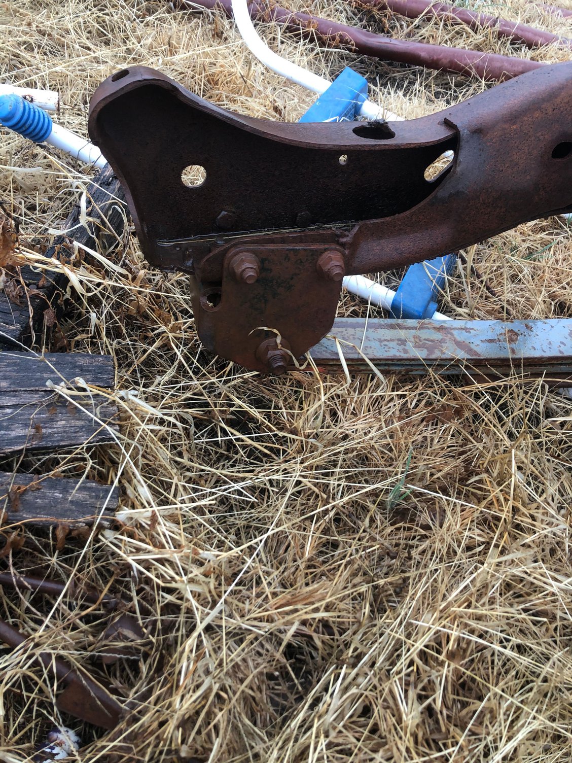

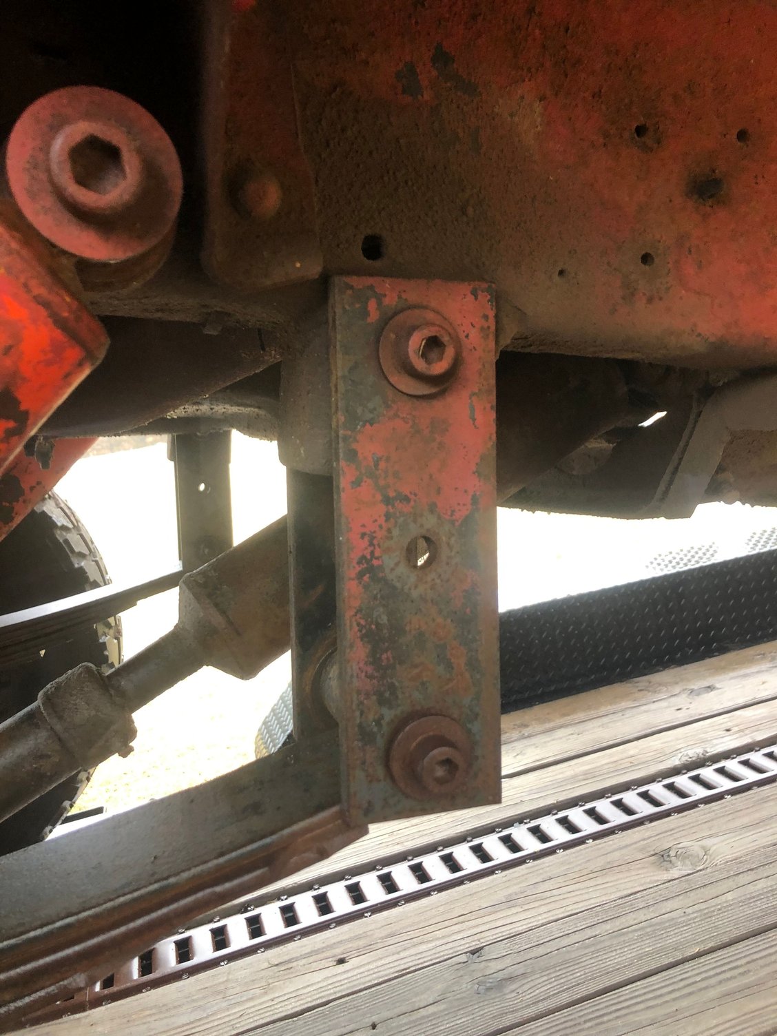

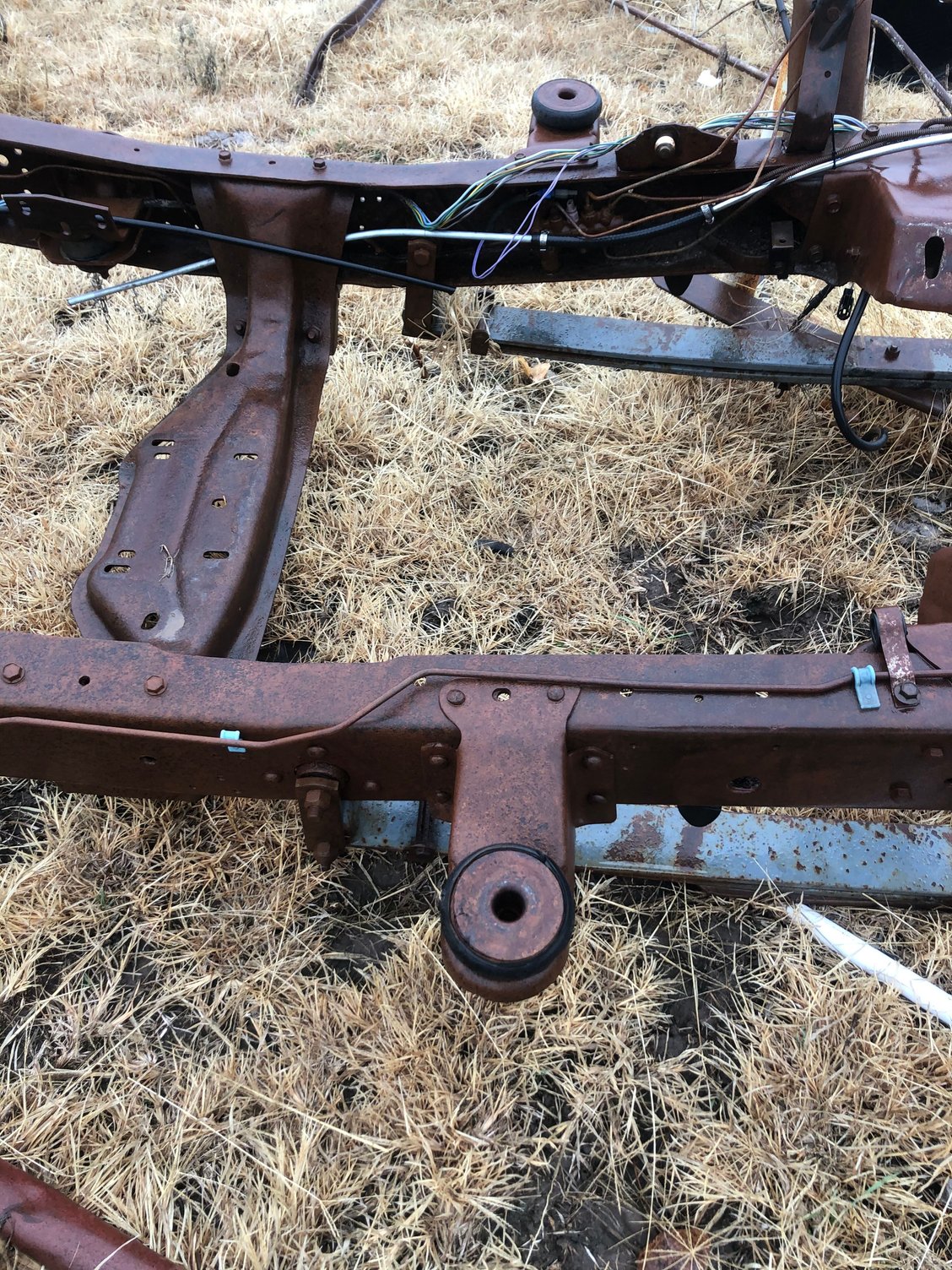

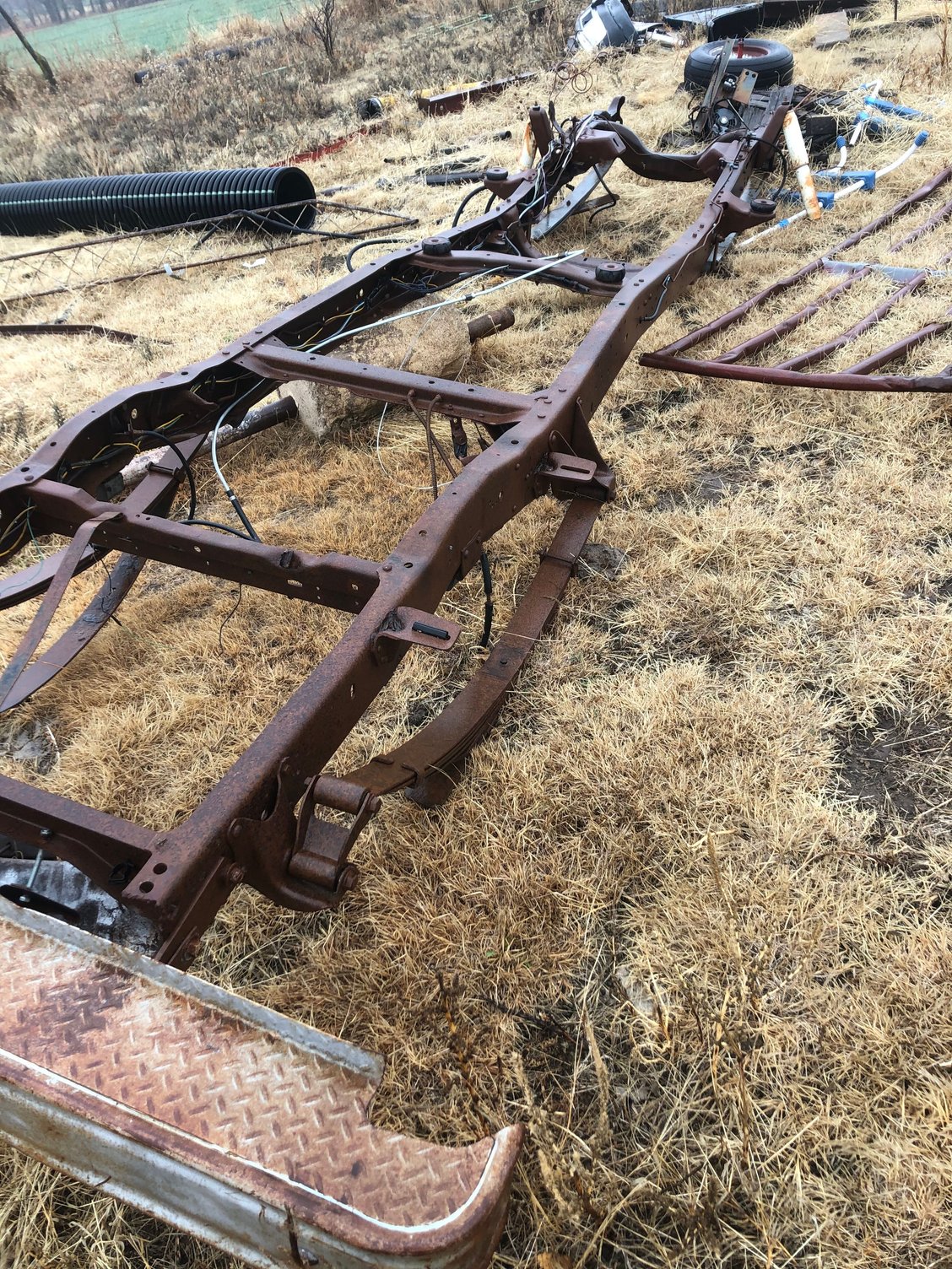

Will the hangers off a 78 f250 4x4 work for the super cab frame. Have a frame in “the back 40”

I think I can reuse rears. Looks like they just extended them. Front look like a start from scratch deal

Looks like maybe they converted a 2wd to 4wd the way they did the front. On a true 4wd scab 150-350, it shares all suspension with a regular cab 250 front and rear

you are right. It was converted. Just decoded the vin. That’s a freekin bummer

Somewhere between your super cab frame and your spare frame you could graft the two into one 4x4 frame.
the 2wd frame won’t ever be able to be lowered to stock heigh unless the original front suspension crossmember gets replaced for a 4x4 one.
my suggestion would be to stretch your spare frame to the length you need and use that
