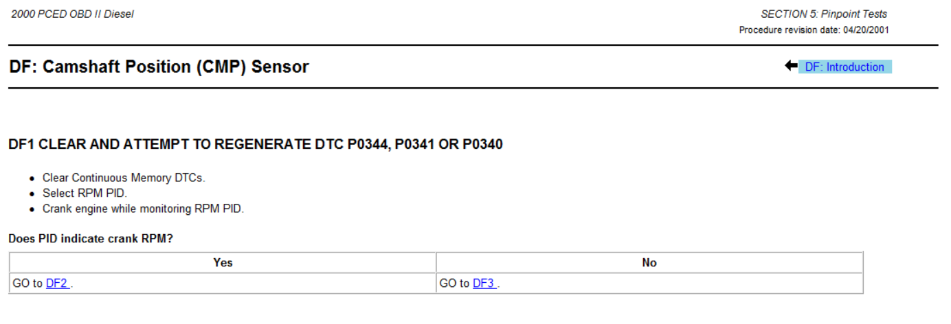

Technically One Sock is correct in referring to the CMP, not as a CPS.
A lot of times we as consumers and customers refer to something using a different terminology than what they were called from the factory or their designation in the service manuals. Cruise control is another one, it is actually "speed control" in the manual. This can be confusing at times and will often lead a procedure or pinpoint test searcher astray if they are not familiar with the right terminology.
We get it though, CPS vs CMP... Same difference 99.9% of the time, which is good enough in a court of law when reading a DNA test.
The CPS is a scapegoat a lot of the time, but can be faulty some times. Usually it will start causing intermittent failures. The earlier trucks move the RPM needle when cranking where the later ones do not until the engine has started.
