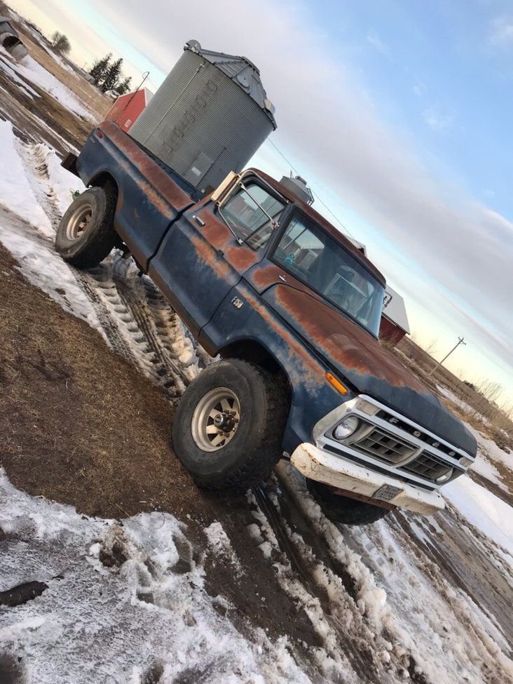

Just about have my motor swap completely finished, I put a 7.3 from an 89 into my 73 highboy. I am now on brakes and after bleeding them and putting new calipers on the front the brakes felt normal, so I plugged the vacuum line on the booster and no longer have any pedal travel, and the brakes don't work cause I cant push the pedal. I can unhook the vacuum line and apply brakes with a lot of effort and it takes time to stop, nothing I cant drive with but I really don't want someone to pull out in front of me and get run over by this monster. Do I need a new booster for the 73 body+pedal length or new booster from an 89 to match the pull of vacuum from the motor? or is there something simple I can do now with the parts I have?

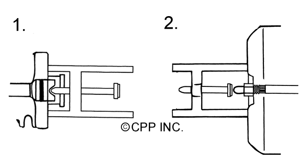

Old Mar 9, 2021 | 03:21 PM
lonewolf_'s Avatar
lonewolf_
Scope Wizard
Joined: May 2019
Posts: 6,530
Likes: 25
they make a tool for checking rod length......
The tool is easy enough to make....
here it is in use.....
most fords are 24-25mm length on the booster.. you could always use a dab of grease on the rod and test fit the MC unril you just make contact.
