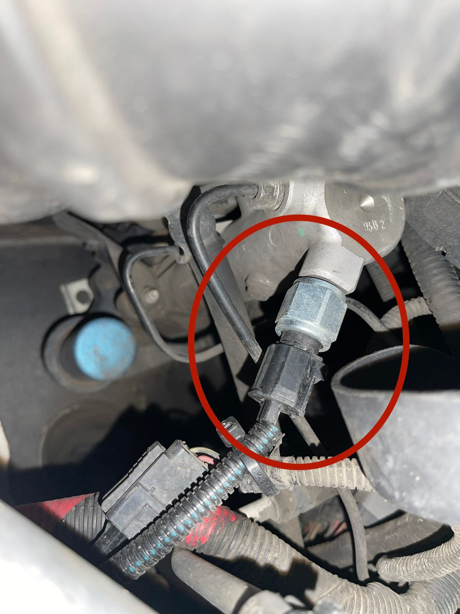

Mine did the same thing a few months ago. It was the pressure switch under the master cylinder - the one I picked up from the local leprechaun auto parts store looked a little different (sensor + 6" of wire with fuse then the plug vs. just the pressure switch with plug) but it fixed mine right up, easy fix.

@ARP2. you referring to the 3 wire flat sensor directly under the master resivoir?

This one

This is the fused jumper they installed at the recall on my 2002. If the brake pressure switch was leaking you got a new one, if it was not leaking you got the fused jumper in case it starts to leak in the future it won't burn the truck down.
