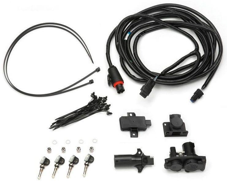

The TPMS kit will come with four sensors, replacement 7 pin/12 pin connector, a repeater box and mounting hardware. The repeater needs to be mounted on the trailer close to the axles and is then hardwired into the truck via the replacement 7 pin/12 pin connector. The sensors will require the valve stems to be replaced on the trailer tires. You can add two additional sensors for a total for 6 on the trailer if needed.

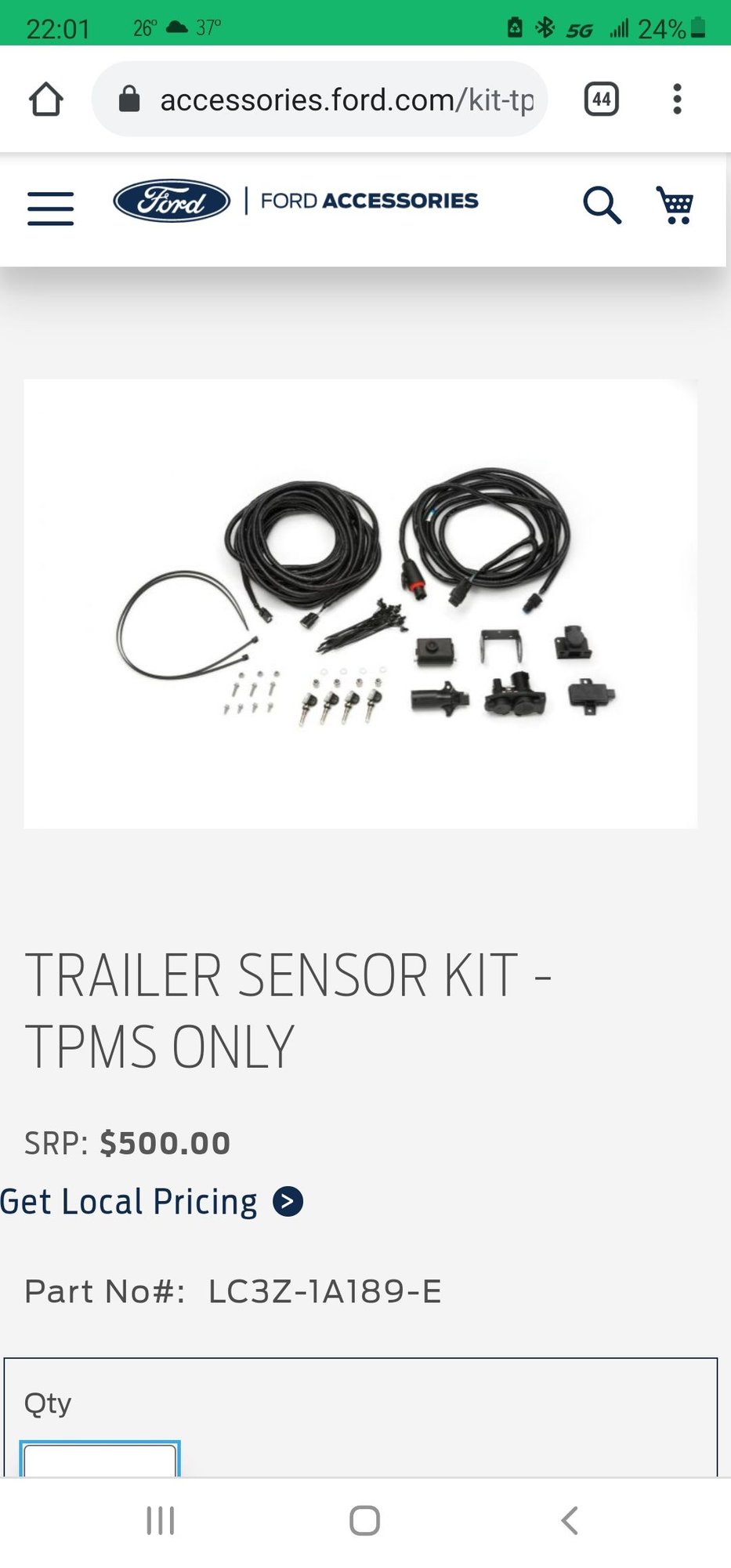

Old Mar 6, 2021 | 09:02 PM
dtingle's Avatar
dtingle
Joined: Sep 2017
Posts: 14
Old Mar 6, 2021 | 09:36 PM
ford390gashog's Avatar
ford390gashog
Joined: Jan 2004
Posts: 26,007
Likes: 575
From: Brentwood,CA
Originally Posted by encmerk
any chance you could scare up the part number? I would be very interested in adding this to my 5er!
Good luck, those are on 6 month backorder. Check ebay, but be prepared they don't go cheap.
