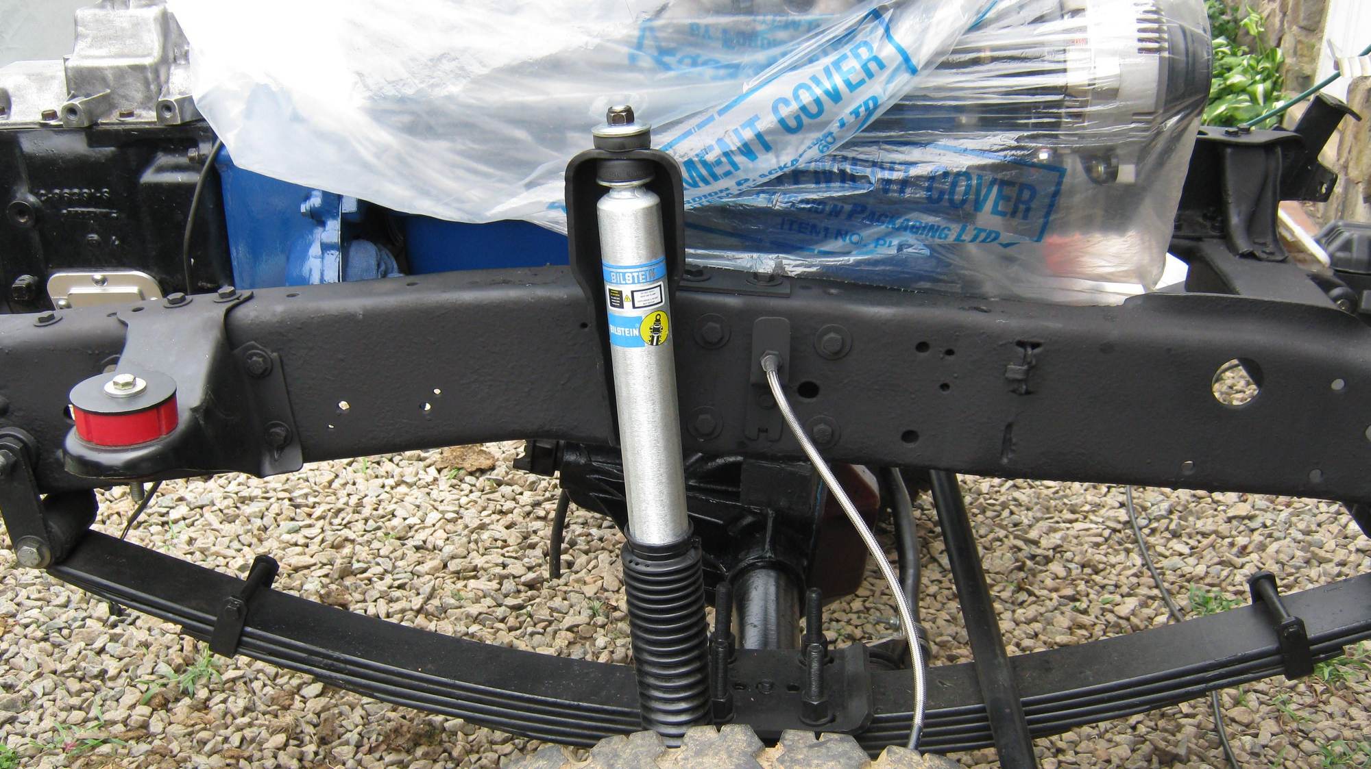

Old Mar 17, 2021 | 09:25 AM

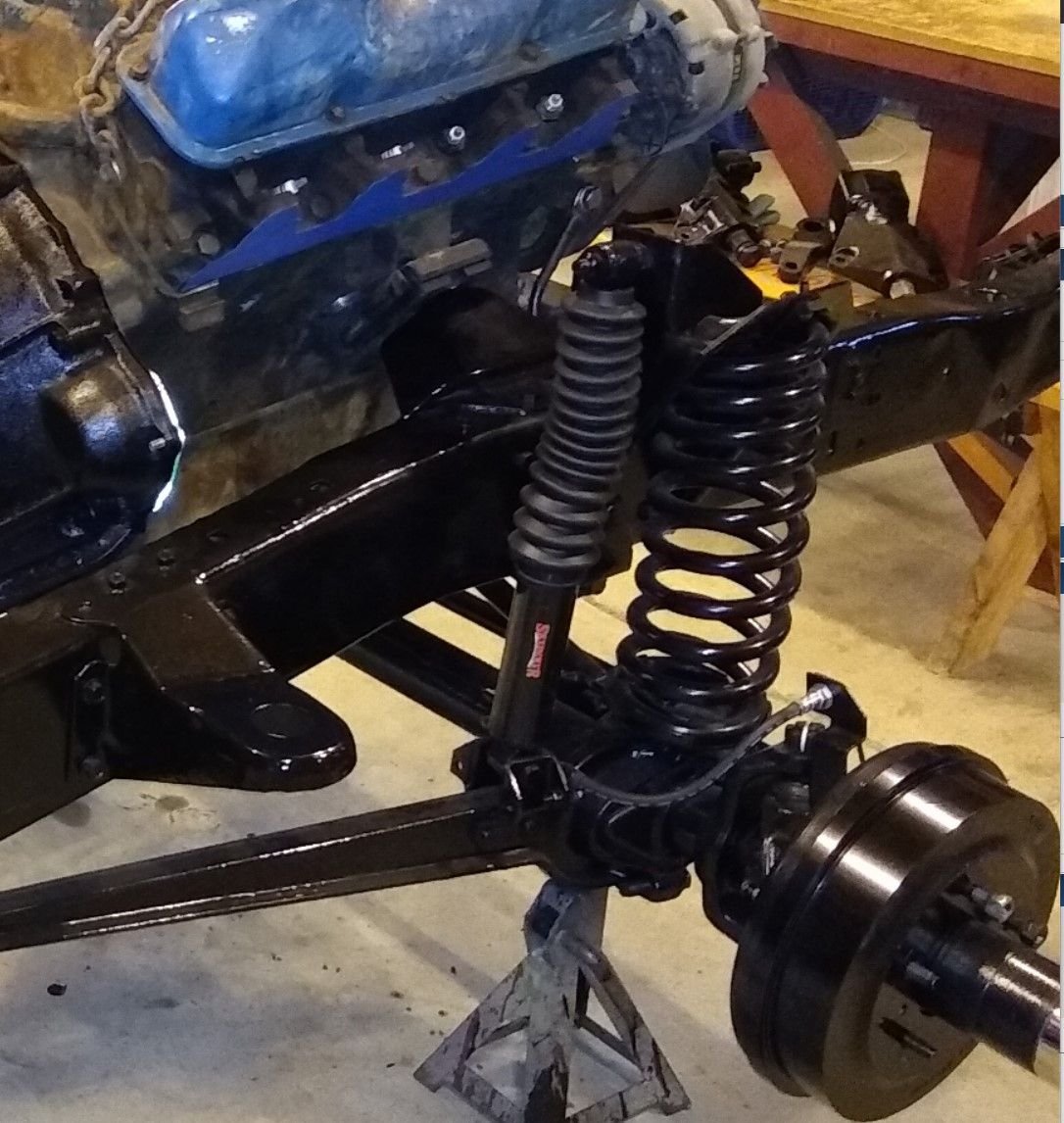

I'm restoring 1974 f-100 4x4, here is some of my research that I got from this site:
- 1966/76 F100 4WD & 1975/76 F150 4WD use the same front shocks. There are several different types of these.
- 1977/79 F150 4WD are different. There were no F100 4WD's after 1976.
Stock Height, no lift:
Front:
Extended Length: 19.69"
Compressed Length: 12.51"
Mounting: eye / eye
Rear:
Extended Length: 24.3"
Compressed Length: 14"
Mounting: eye / stud
I purchased Skyjacker shocks all around for my project:
Black MAX twin tube shock absorbers, with black boot.
Front: B8512
Rear: B8555
My truck is still in pieces, so I haven't been able to try them out yet.
Here's the fronts:
You can check out my original question about this, the same as yours here:
https://www.ford-trucks.com/forums/1...1974-f100.html
Hope this helps.
