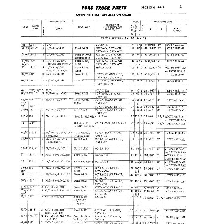

In the case of a two piece driveshaft one of the two tubes is called the "Coupling Shaft" - the Master Parts Catalog doesn't list any "Coupling Shafts" for a short bed truck. Any chance you can post a picture of what you have so we can make sure we are all on the same page?

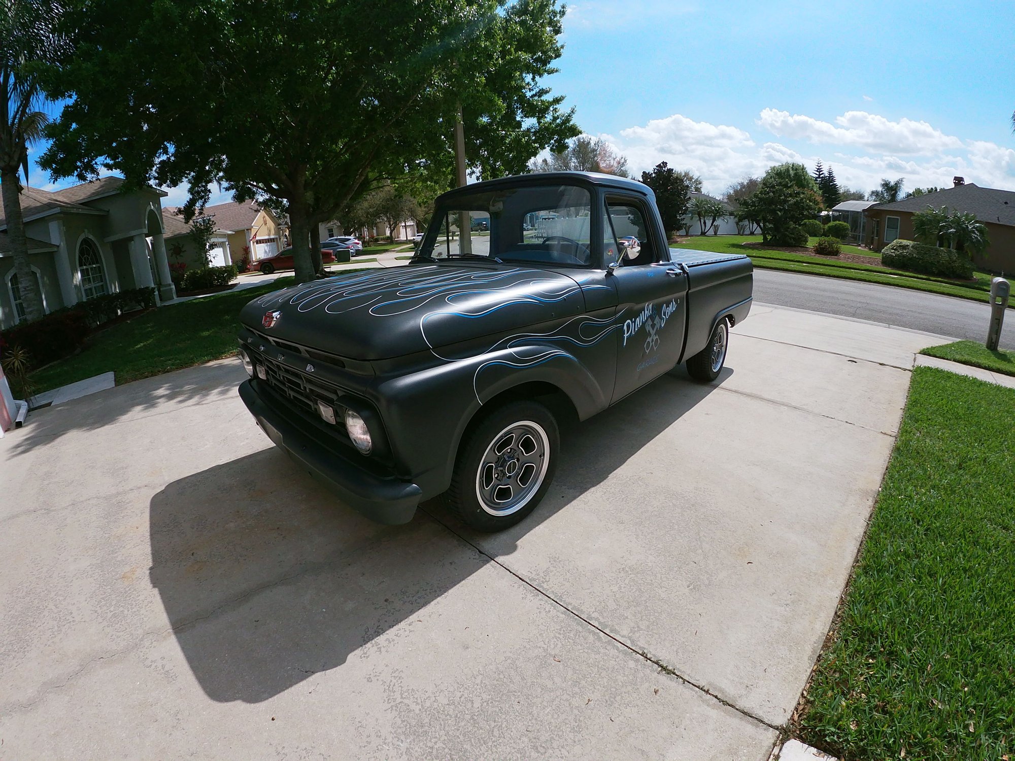

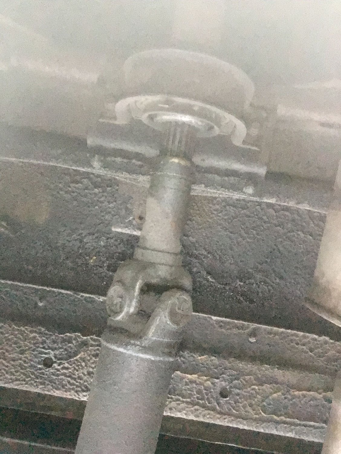

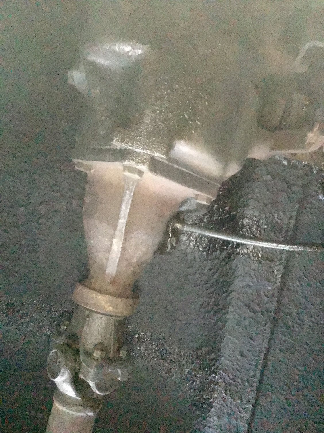

here are some quick pictures. First showing it’s a shortbed, then the carrier bearing, then the 3 on the tree tranny...

Interesting - not sure how a person would order the correct replacements for that one, but a single piece should be fine. You can see in the list there are no coupling shafts for 114" wheelbase in 1964 or 115" in 1965/66.
