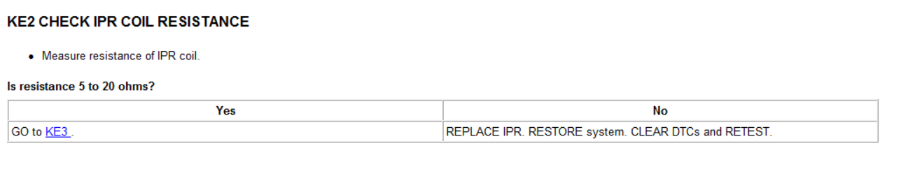

You can test the electrical part of the IPR. Grab a voltmeter and check the resistance, should be in the neighborhood of 10.5 ohms. And as mentioned above if it responds to cooling that's a good sign the IPR is dying.

If you decide to replace the tin nut on the IPR, you can get a more substantial one of the following size: 1/2-20 UNF
Just to piggyback on what David has said, below are the specifications Ford says the IPR coil should be within.

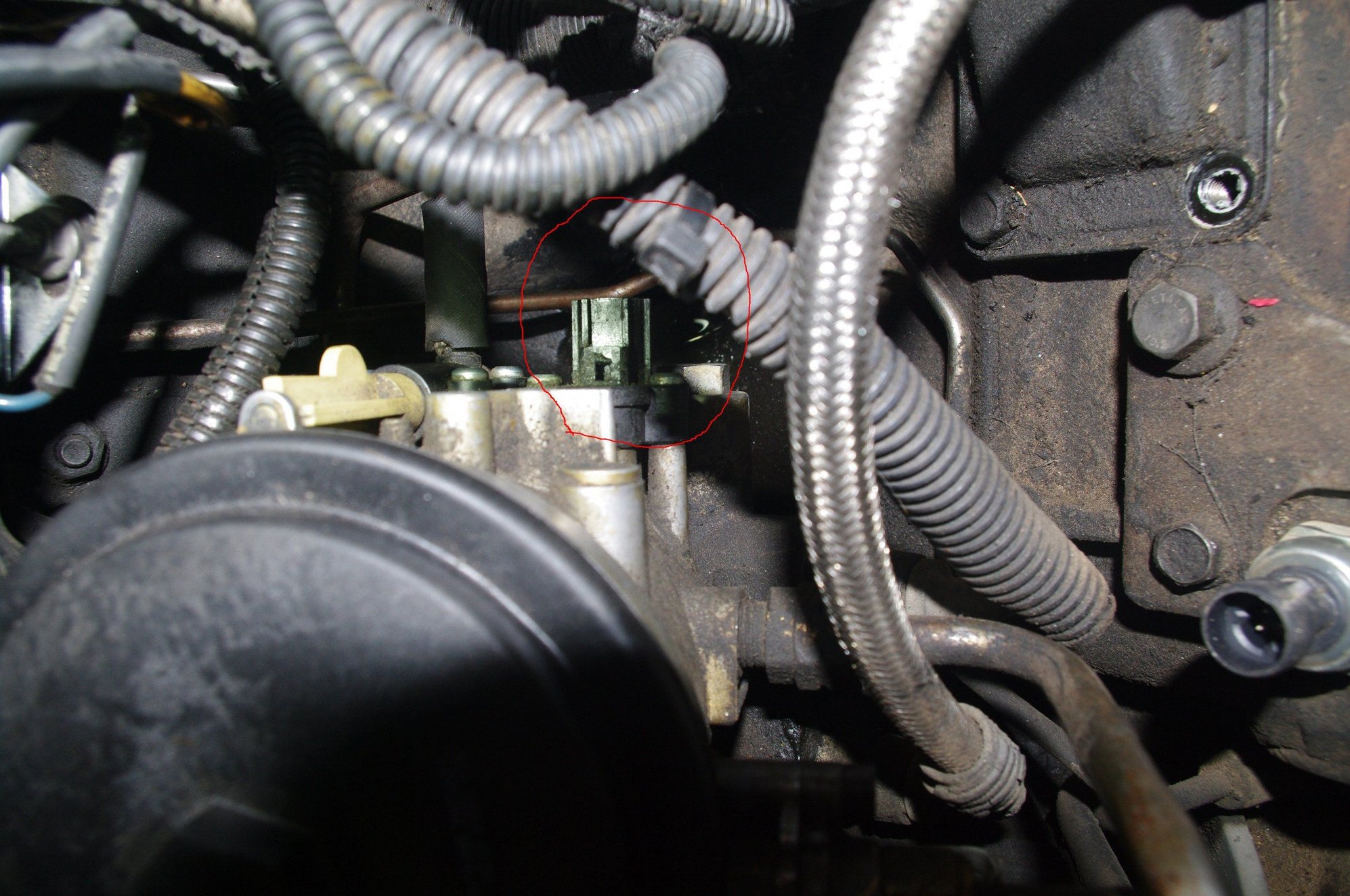

The ipr appears to be leaking slightly. So at least I need a rebuild kit for it. The coil ohms well within specs. I think I will try heating it in the oven and see if it still ohms good.
The ipr pigtail needs replacement as well. Also there's another pigtail that I don't like (circled in red). What is that one?

Water in fuel sensor/fuel bowl heater
Unless you live in a cold climate, and upgrade to the updated heating element just leave it unplugged
