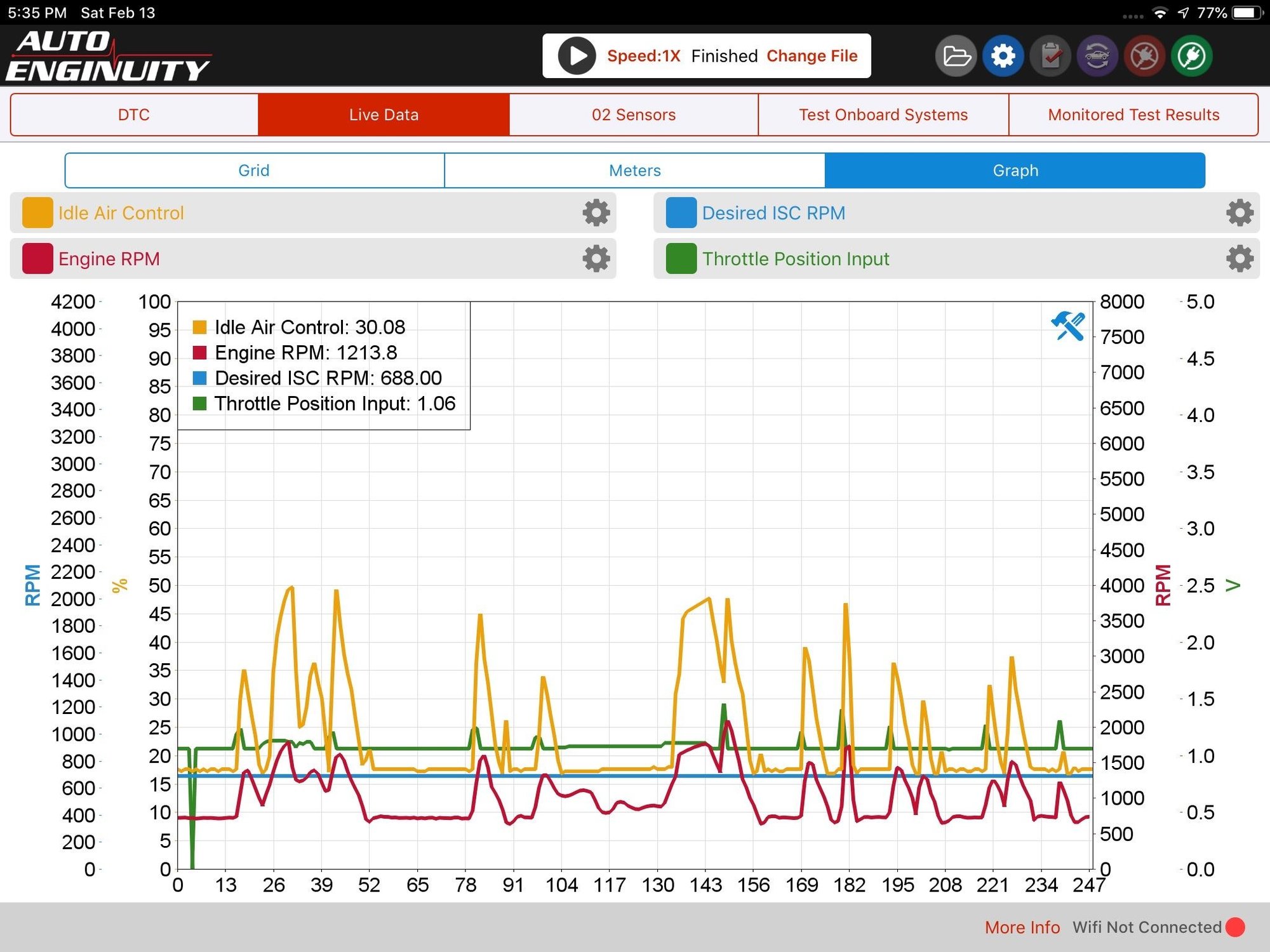

He’s pretty good with AutoEnginuity and has data logged and graphed (see below) desired rpm vs the actual rpm as well as the TPS voltage and the IAC duty cycle. Additionally, when the TPS voltage equals the TP RATCH PID the TP MODE PID shows C/T, indicating the PCM is recognizing the closed throttle position. Just gotta be logging the data some time when the throttle hangs.

I’ll have him add the TP MODE PID to the data he is logging.
When it shows “C/T” the TCC should be unlocked.
