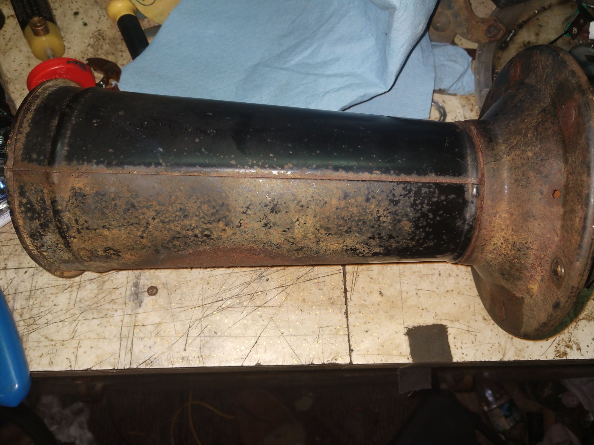

Last Friday I drove from NJ to CT to pick up a wheel from ct50f1, Dan. He was kind enough to drive an hour in my direction and save me 2 hours of drive time. He brought along other parts he was looking to get rid of, including a horn that didn’t work. He said he was giving it away, and since the PO of my 48 put in a little squeaky horn, I figured I could fix it so I grabbed it. Heck, I have a paper that says I’m an electronic engineer so if I can’t fix a simple electrical/mechanical horn I should give it back.
over the weekend I pulled it apart, but some screws were rusted so I soaked it in PB Blaster. That and some heat got the screws loose. The points were frozen, one of the wires was rotted away, and all the solder joints were bad. I cleaned up everything, resoldered all the wires, replaced one.
Today I hooked up my battery charger and after some tweaking of the points adjustment, and some big sparks that scared me to death, I have some noise from it. Once I install it in the truck I’ll tweak the tuning but I’m confident it’s working now.

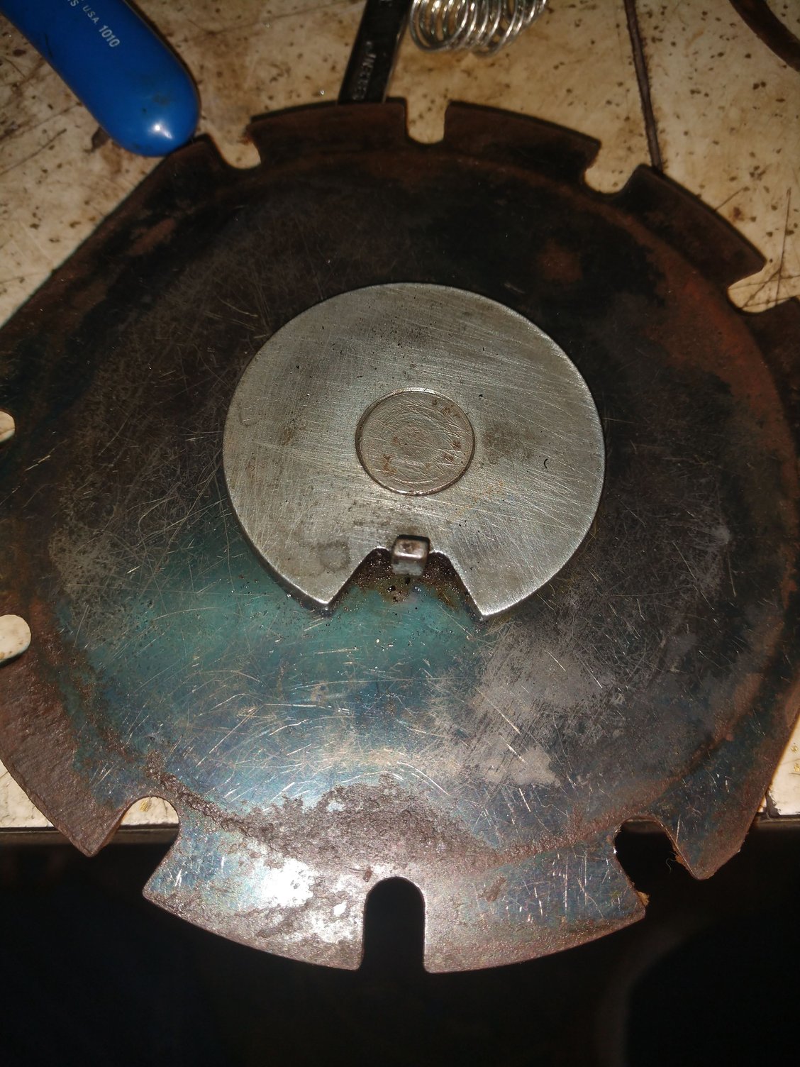

Mr. Bob -
Two questions with reference to middle picture:
Is that a paper gasket that looks completely perfect that lies about 11'clock from the horn assembly? Anyone have any suggestions on replacing the paper gasket. I was going to try some cardstock, which relatively speaking, is quite a bit thicker than the paper.
So is the paper cup in the 2: o'clock position something to eat?
There are 2 gaskets, one on each side of the diaphragm. One came off perfectly, the other in pieces. I reused the one gasket and used RTV on the other. I would think any heavy paper would work as well, but cardstock seems too thick to me.
Thats not a paper cup, it’s plastic. You might not want to eat that, it’s solder flux.
