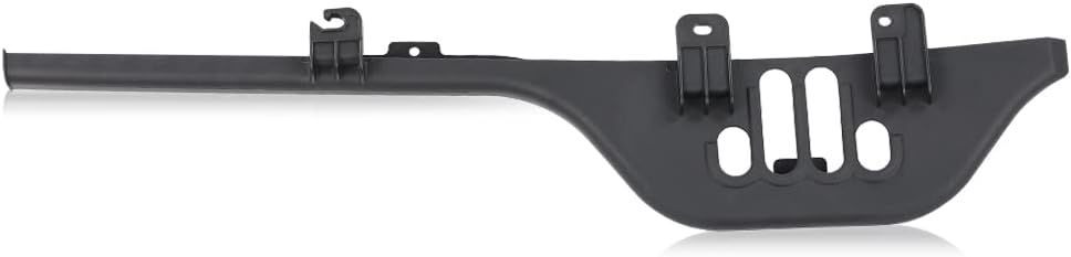

Originally Posted by Heckler
This is what I ended up doing...
I had 1 of the 3 upper tabs broken off completely and the one next to it was cracked on the underside (the far left one was fine), I started to design a replacement to 3D print but being my printers print bed is only 12" x 12" I would have had to print it in several pieces and assemble it either by screwing it together or gluing it, but glue would not work with the material I wanted to use, a carbon fiber nylon that is extremely strong and should be able to take the heat.
Then I figured why not just fix the broken tabs, I designed replacement tabs and a template to get get the holes drilled accurately in the original cowl, then took my Dremel and cut off the original tabs and drilled the holes.
Gave it a light coat of bedliner spray and mounted the up with stainless M4 hardware, good to go worked out perfectly. I didn't do the far left one that is on an angle since there isn't much material there to drill into and would have likely made it pretty weak in that area and when I was thinking through the design of the whole part I was thinking of not even extending it that far anyways, I would have just matched the far right side and used some wire loom or high heat wrap over the remaining wiring.

I purchased the $20 "PIT66 Hood Cowl Panel Wiring Shield Compatible with Ford Super Duty F250 F350 F450 F550 2003-2010 3C3Z-14A099-AA" from Amazon (
link link
). The quality seems okay. Only time will tell how long it lasts.
When I installed it I decided to eliminate those stupid plastic Christmas tree plugs from my life. I despise those things. I used the holes for the plugs and installed some U-nuts/Speed-Nuts and then bolted the support down. I was very happy with the results and the whole thing just feels much sturdier.
