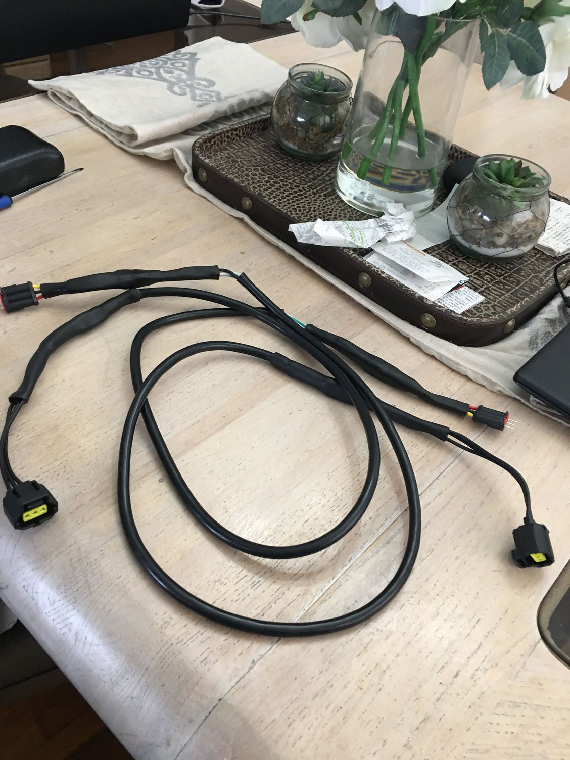

Putting it out there in case someone knows for a fact that I’m going to smoke my pcm today if I do this.
thanks every one
making the cables now
should know something in about an hour
unless some gives me a good reason to stop

Cables completed
since no one has given me a reason to stop
going out there now to set it up
Wish me luck

Well
ny test is not going to happen
cant get the pcm connector on the secondary alt off.
the primary came off no problem.
looks like this is the end of the diy adventure
was hoping to verify a primary alternator problem and I would of probally replaced it my self rather than do the out of state warranty appt.

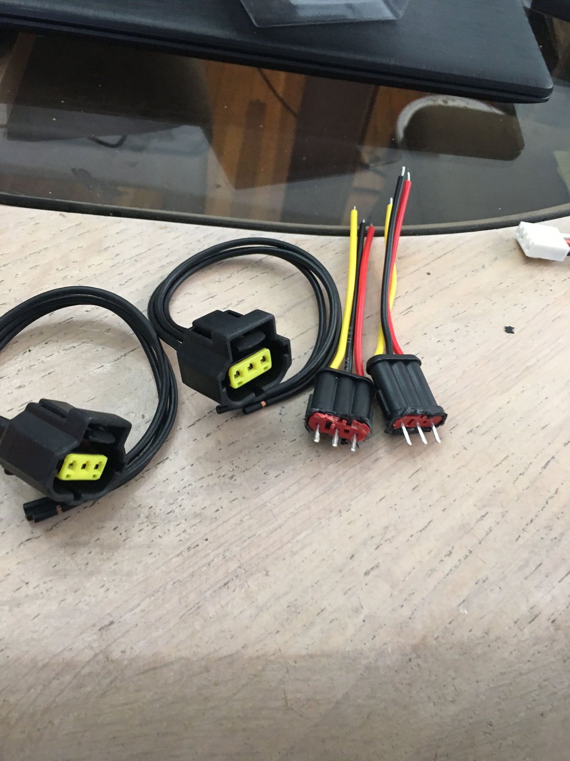

Originally Posted by speakerfritz
Received the parts for the extension cables
cables will be used to swap alternator roles
prinary will be secondary
se o dart will be primary
question will be did the faults follow the alternator suggesting bad alternator
or
did the faults remain suggesting pcm circuit problem
Why do the male ends of those cables look so chewed up?

The female ends are actual alternator plugs
couldnt find an exact match male end so I bought a plug that was close and peeled back the plastic
the purpose of the cable was just to trouble shoot for a few minutes
couldnt do the test ....couldn’t get the secondary connector off
