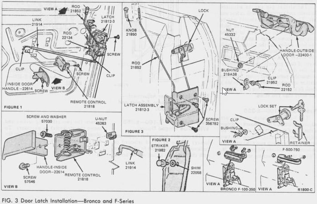

You can get the door panel off with the seat installed, but what a giant PITA. And you still can not really easily get to the back corner of the door panel. X2 remove the seat, (to get the slider tracks rear bolts straight on, slide the seat all the way fwd, then tilt it fwd and get behind the seat with 12" extension). Get them kids back there. Lol
Then remove the door panel and get an eye in there. I bet the rod (21914) going from the interior handle to the lock assembly or rod (22152) outer handle to lock assembly came off. The little yellow plastic retainer is a culprit many times. Also when you try to open it from the inside, have some one sort of push on the outside slightly to take the pressure off caused by the door seal.

Man you guys are all awesome! I have always had an old friend who has helped me with things like this and I did all of his welding. He stopped working on cars a few years ago so now I have to do my own. Just a little bit of a learning curve for me. Thank you 72rtchallenger for the illustrations that will help me on the repair.

If you have to use a slim jim to get to the lock operating rod, lower the window first - the bottom of the window will definitely be a hindrance and you will have a much easier time with the window down. If you can get the door panel off (yes, it IS a pain) raise the window all the way up to give better access to the lock - you can see in the drawings above that if the door operating rod is your problem, it's easier to reach from below.
