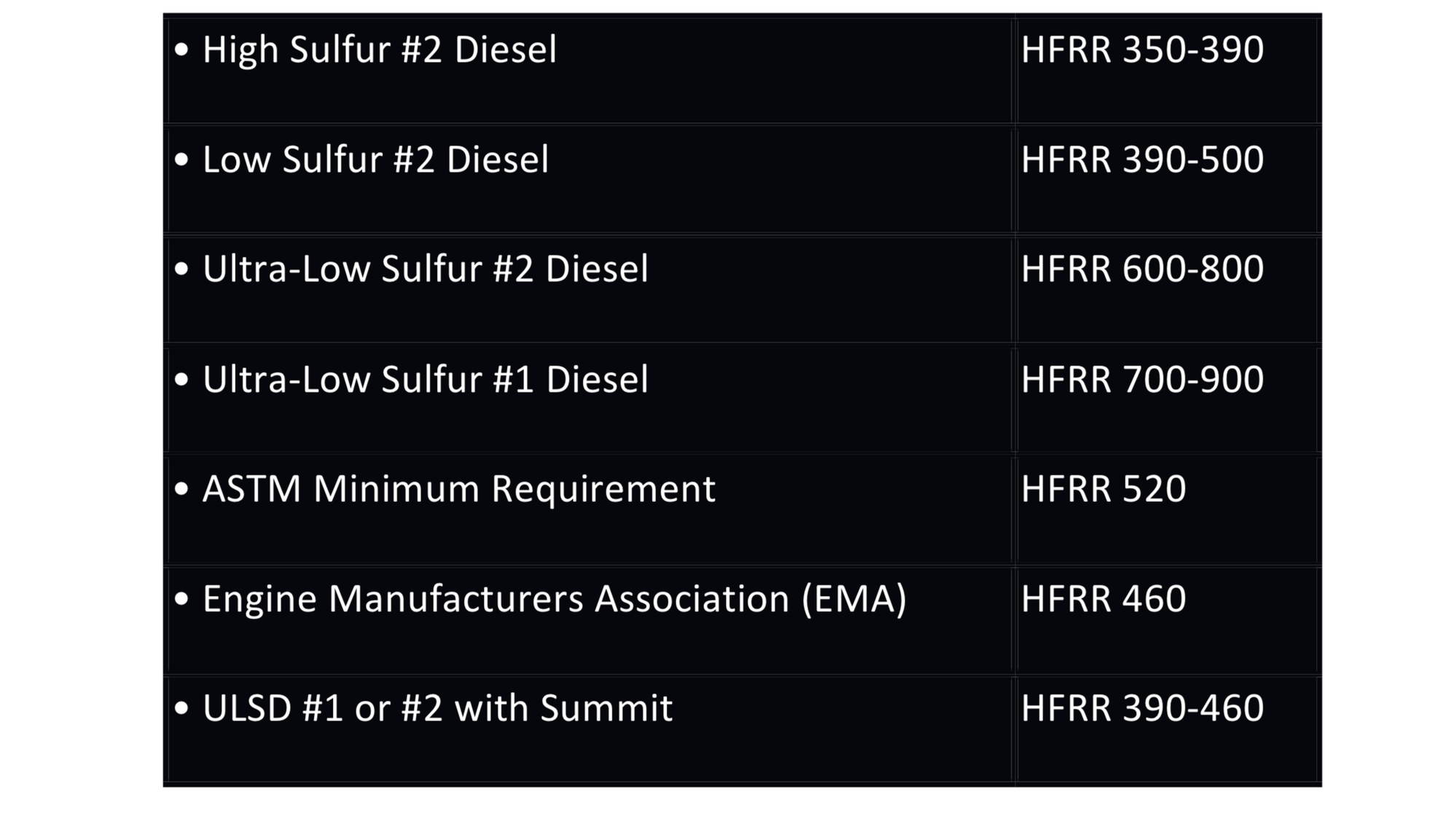

You guys saying #1 diesel is a poor lubricant may be wrong. I can't find anything from a reputable source to agree with what you're posting.
The downsides of #1 diesel is lower MPG and higher cost.
https://www.papekenworth.com/blog/di...t%20the%20pump.
https://www.cenex.com/about/cenex-in...premium-diesel

The lower the number the greater the lube value. I think 520 is the target number. untreated #1 diesel does not meet ASTM or EMA min standard.

The sites I could find on this issue all mentioned that #1 diesel always has an additive.
