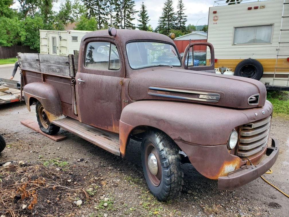

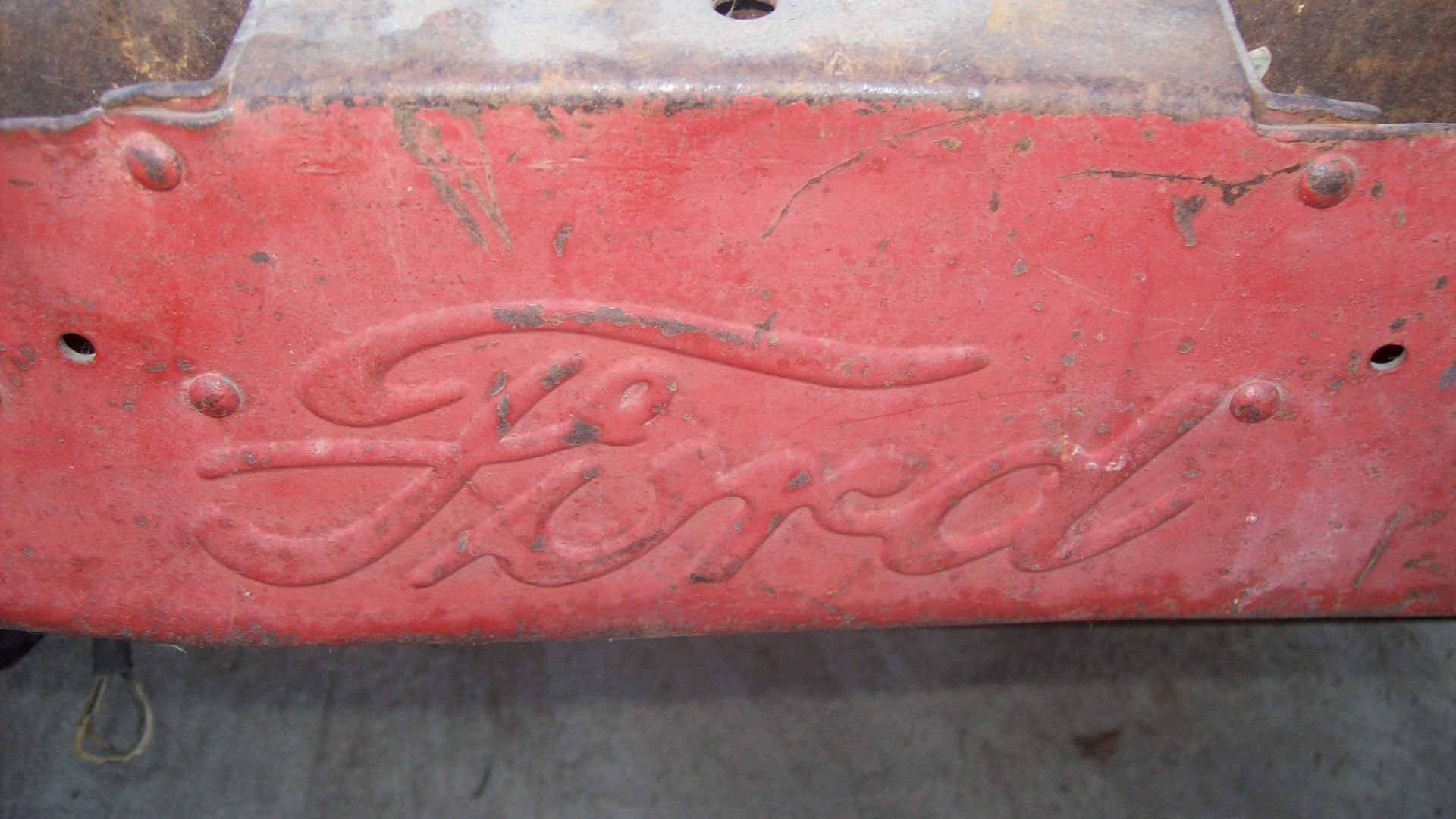

Ford made stake flatbeds with Ford script on the back. Most of the flatbeds I’ve seen were all either farmer built or custom built by local companies of the time. I have never personally seen a Ford script flat bed locally in Alberta. Never seen one for sale either. Not sure why that is other than most of the trucks were bought for hauling grain so a stake bed wasn’t much use. Most of the trucks were modified with hoists and high sideboards like yours. Cut a hole in the tailgate and there you go, grain truck. So I think you would have to build one. I have one here that I pulled off of on old truck. It’s been a while since I looked at it but I think it’s in not bad shape. I will never use it. Chris If you want to come look at it and see if it’s something your interested in. You can have it for nothing. Doug.

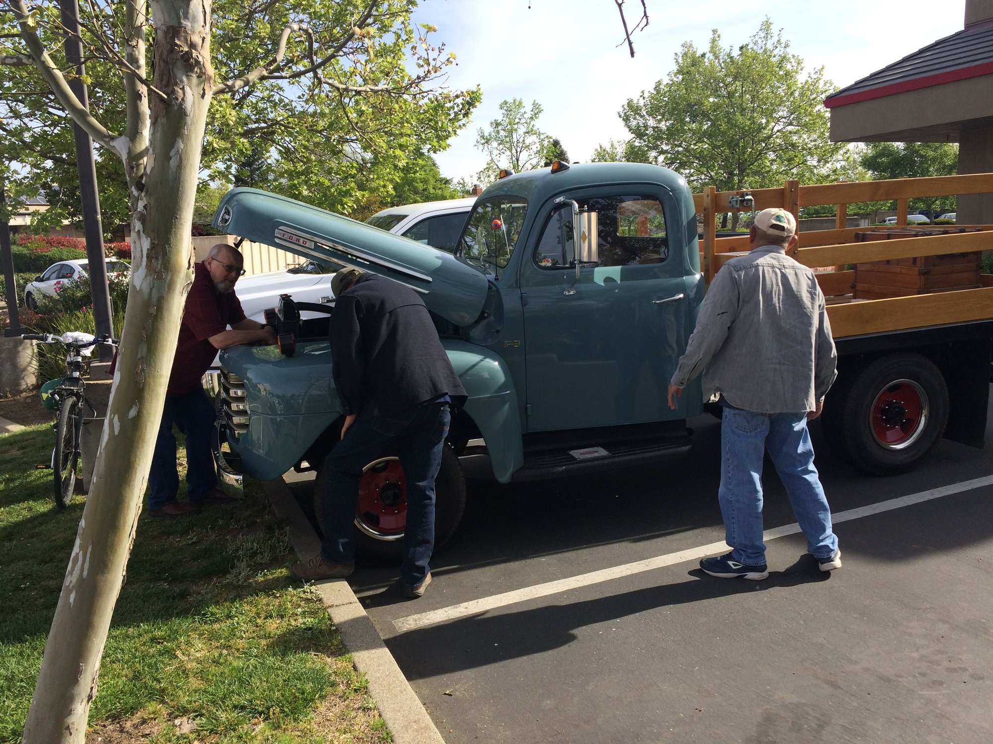

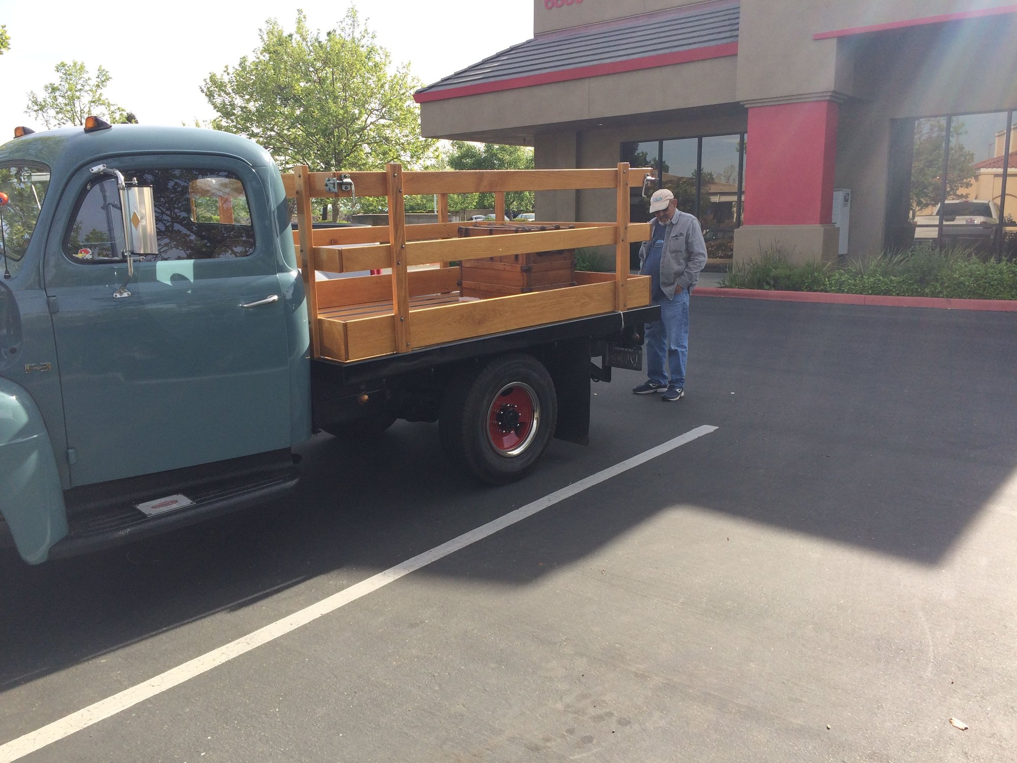

Here is marks 48’ f3
Dan at the front marks back under hood

Script beds are hard to find, I met a guy in tucson a few years ago that was cloning a script flat bed I think his was a 63’ f100 I don’t remember his source for the script.
Old Feb 24, 2021 | 04:28 PM

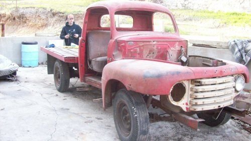

52'F-3's Avatar
52'F-3
Joined: Dec 2006
Posts: 670
From: south-central PA
schoo... thats a good looking F-3...
for reference, I put a flatbed that is about foot longer than it should be on mine. (moved the axle back about 8" also)
Old Feb 24, 2021 | 06:05 PM
49F1Ken's Avatar
49F1Ken
Joined: Jan 2021
Posts: 399
Likes: 338
From: Conneaut Lake PA
That is a sharp truck. Awesome color, graphics, 4x4 and even a winch!

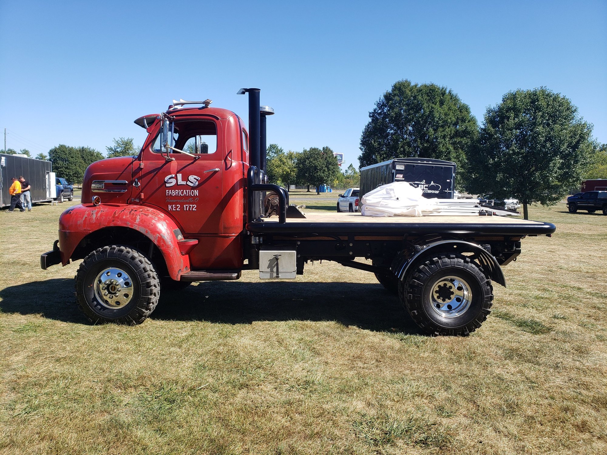

Old Feb 25, 2021 | 06:53 AM
Donco1's Avatar
Donco1
Joined: Apr 2020
Posts: 112
Likes: 32
From: Sagamore hills oh

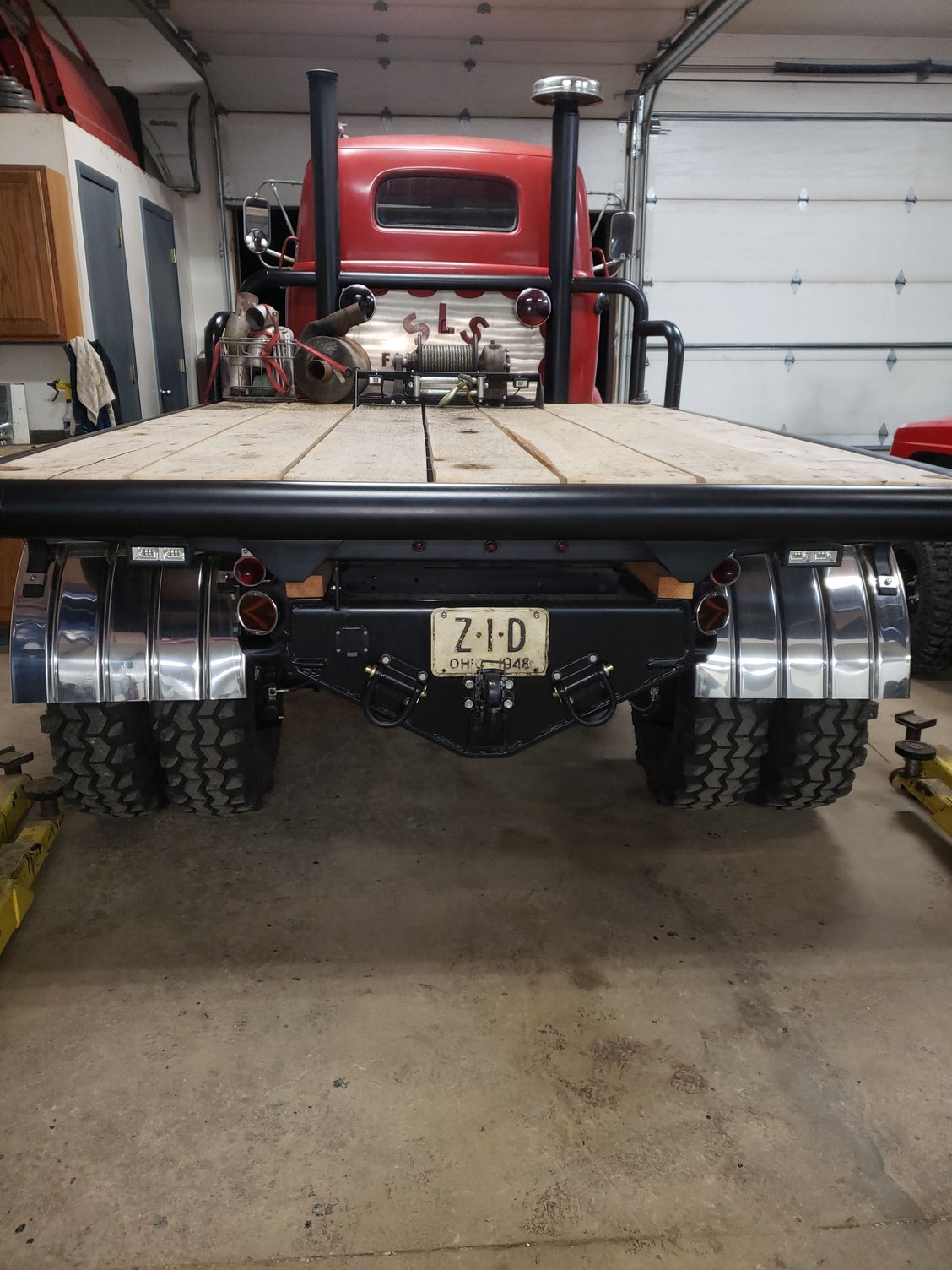

I built my flatbed with a utility theme. 4" round tubing double as an air tank. Tie down anchors in each corner. 1 upright is air intake and other is exhaust. PTO winch. I want to build some type of short removable side.
1st time out last year. Indy 4 wheel jamboree
Truckstock last fall next to Nick's truck

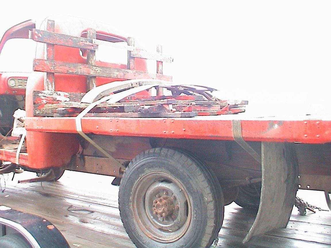

Old Feb 27, 2021 | 04:17 PM

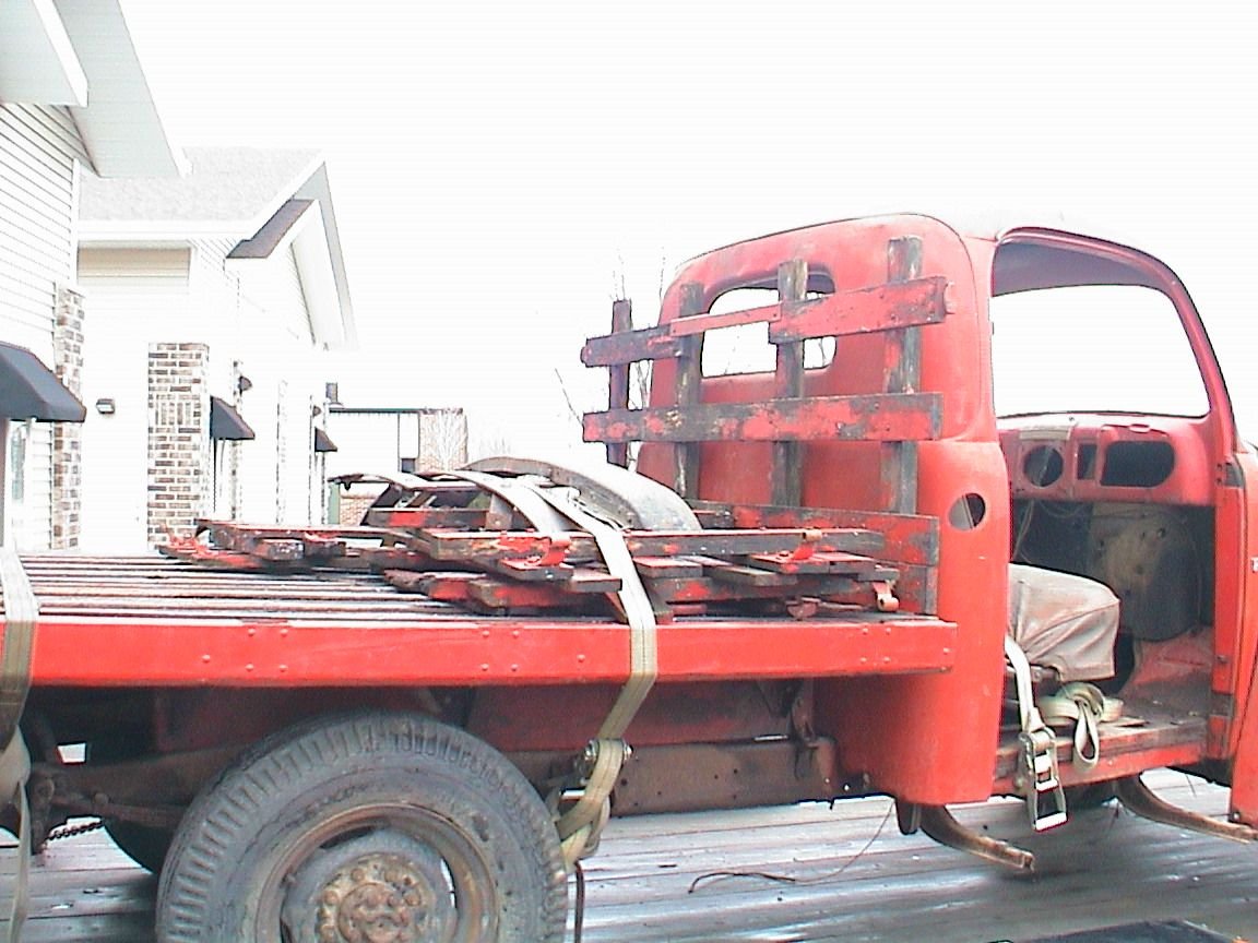

bobj49f2's Avatar
bobj49f2
Joined: Jan 2001
Posts: 16,887
Likes: 3,129
From: SE Wisc. (the Rust Belt)
These are pictures of a '48-50 F-3 I bought a few years back. The bed was in almost mint condition. I parted the truck out and sold the bed to a fellow FTEr.
