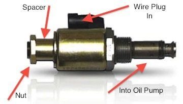

Just to be "Mr Picky" the IPR is not a sensor, it's a valve. Still could be the problem in two ways; first the tin nut holding it together could be loose/gone, and second the magnetic coil on the IPR solenoid can fail when hot. You can test it with a multimeter, resistance should be about 10-11 ohms, see below.

They are talking about trying to run with the ICP unplugged, not the IPR. It is located towards the front of drivers side head. This is also where to look for oil in the connection.
When they talk about the IPR being loose they are referring to the timnerman nut on the back of it. I got this photo from another post here on FTE by HKusp.
