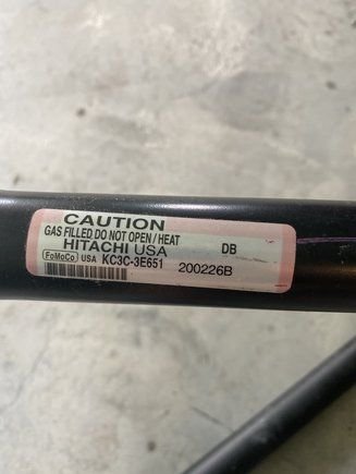

Mine said Hitachi USA. It was still junk.
Reference picture from another thread.
The label is made in USA, lol

Is this suppose to be gas charged?

Yes it is supposed to be charged. Mine was leaking and had no charge in it.
I noticed the note about being gas charged on that sticker in the photo. The made in Mexico version from the 17-19's were not a gas charged steering damper. I wonder if that was a conscious decision on their part to make that change in type of damper, in their efforts to mitigate the shakes.
