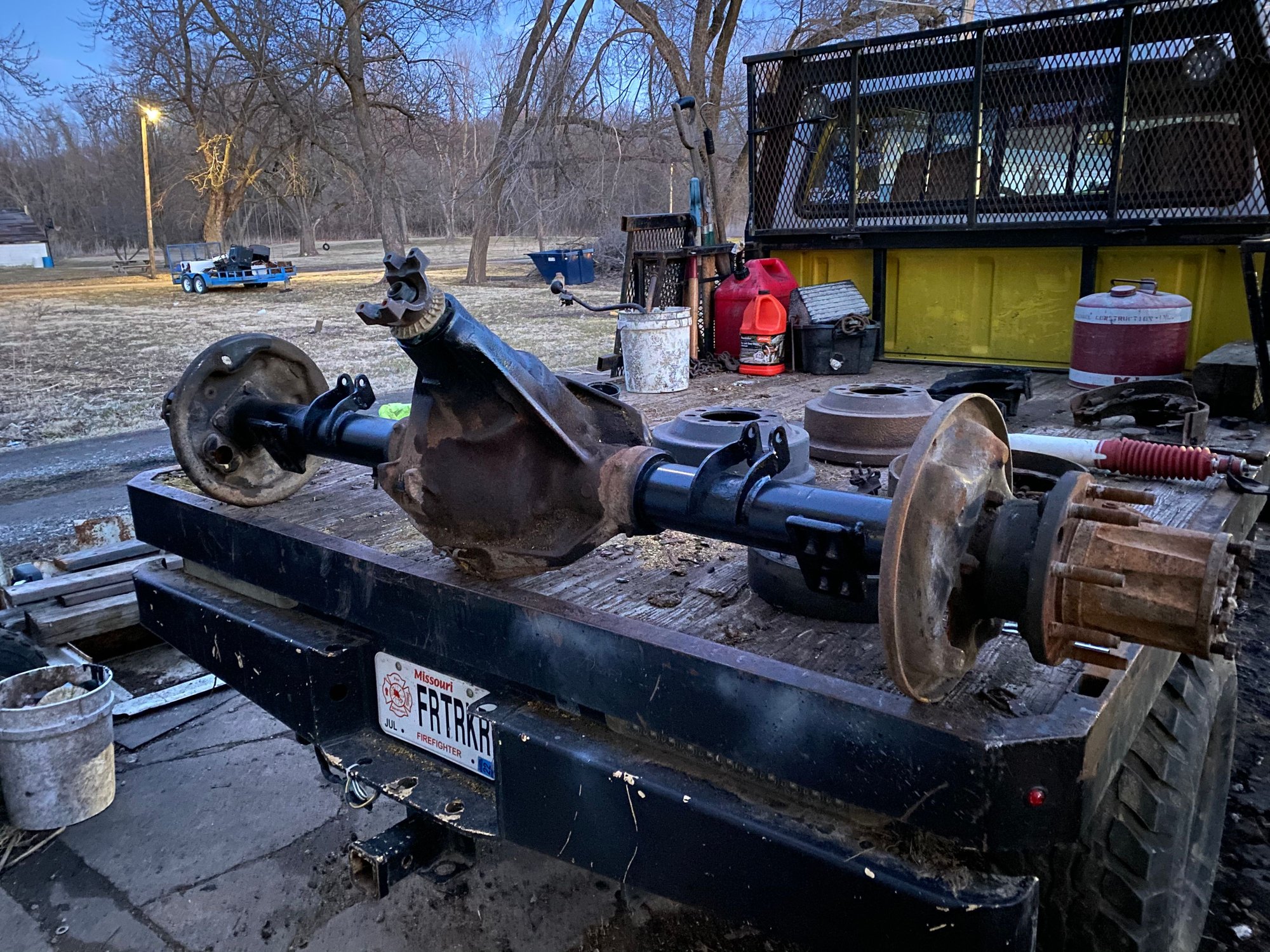

So, as an update. I got the axle. 4.10, trac lock 10.25. Needs seals and brakes before I can install it, but it’s identical to the one I have under my bed/trailer so it will
work fine. Hopefully ill
have it in soon and can report fully.

As some updates;
the yoke is identical to my d60, so driveshaft should be no issue
i should have ubolts and seals this week so I can get it under truck
here is a comparison of a Dana 60 axle shaft and a 10.25
