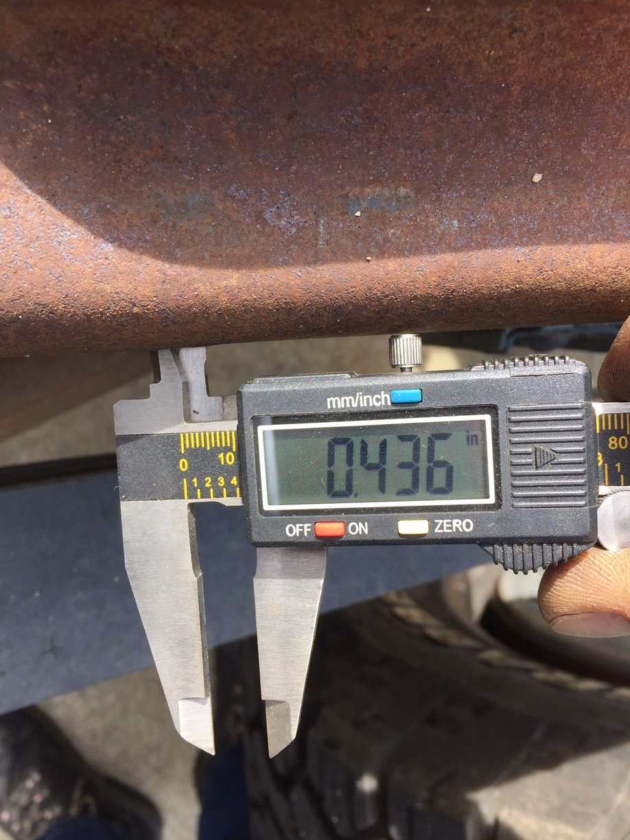

I came up empty searching online. Anyone know what size rivets hold our frames together? I'm looking to replace what needs it on my spring perches when the motor comes out this year.

Seems like they are 7/16". at least that is what bolt size I replaced them with.

Thanks! I recall putting half inch bolts in a 78' when I installed extended radius arms. I just can't remember if that required drilling to 1/2" or not. I might bump it to half anyways for the hell of it.

7/16 on mine. 1996 F250.

I’m not sure how drilling a larger hole in the frame is better. The six 7/16” grade 8 bolts holding it on are more than strong enough.

When I replaced mine, the holes seemed sloppy for a 7/16, so I opened them up for a 1/2" grade 8 bolt. The fit was better, and the fastener cost is pretty much moot.

7/16 is dead nuts on.

Found some common holes. 7/16s is the winner. Thanks guys
