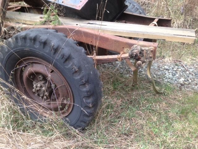

I read this quote this morning in ad and boy did it hit home. I’ve parted out trucks and saved what I thought I should, then recycled the rest. But this time I got burned. One of the first tasks on my tonner M-H is to add in rear frame legs where the originals were lopped off by the electrical coop. I’ve saved some frame pieces from other trucks, but not these pieces. Worse comes to worst I can “cut and paste” pieces together to match the originals but it’d be a whole lot more straight forward to beg you guys for pieces you might have saved. The secondary benefit of the original pieces is ability to perfectly line up the bed mountings. So if anybody has a dead tonner or later 48-52 F-2/3 frame sitting behind the barn I’d pay for those pieces. I have the rear cross member. Thanks. Stu

I just may have what you need. I bought a bobbed off tonner chassis and the bobbed of section was included in the junk pile. I will try to find it in my heap. If you butt a tape measure to the rear spring hanger what does it measure now? Here's to hoping!

OK, I think this is it. All I had had to do was move a couple of crab pots and some tongue and groove pulled from and old house and there it was! I can run it in on Monday to our freight house. Of coures you just pay freight. I could cut metal off that you don't need to save shipping weight.....Heck, with all you've done for me I'll pay shipping. Least I could do.

Hey hey!! That’s exactly what’s needed, the whole thing. Looks like a deal, but you paid shipping on the stuff I’ve sent you. If you didn’t keep my address I’ll email you, and either PayPal you or send a check. Many thanks. Stu
