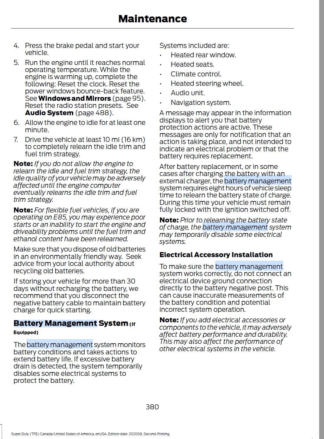

Here is what you should do. Looks like let it sit for 8 hours and you are golden.
Battery Management System (If Equipped)
The battery management system monitors battery conditions and takes actions to extend battery life. If excessive battery drain is detected, the system temporarily disables some electrical systems to protect the battery.
Systems included are:
  • Heated rear window.
  • Heated seats.
  • Climate control.
  • Heated steering wheel.
  • Audio unit.
  • Navigation system.
    A message may appear in the information displays to alert you that battery protection actions are active. These messages are only for notification that an action is taking place, and not intended to indicate an electrical problem or that the battery requires replacement.
    After battery replacement, or in some cases after charging the battery with an external charger, the battery management system requires eight hours of vehicle sleep time to relearn the battery state of charge. During this time your vehicle must remain fully locked with the ignition switched off.
    Note: Prior to relearning the battery state of charge, the battery management system may temporarily disable some electrical systems.

Me neither as read somewhere that it wasn't on these trucks, but after the above and then looking in OM it's page 380 of the 2021 manual:

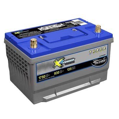

I put a pair of these in my 19.

Good batteries. Same thing as the Odyssey ODX-AGM65. Just put a new one in my offroad truck yesterday. After 10+ years it finally decided to not hold charge anymore.
I had never heard of this battery relearn stuff, but it makes sense. Not really that big a deal though. Change the batteries in the evening, lock the truck, fire it up in the morning. if you have a scangauge or some other monitoring device, just look at the voltage. Fire it up, if it reads 12.9 that's right. As you drive, it should go up to somewhere between 14.2-14.6 I think when the alternator(s) kick in.
Oddly enough my '09 truck appears to charge it correctly, where as my 2015 Civic Si never reads those voltages. No mention in the Honda manual about any sort of Battery Charge Relearn. AGM in both.
I would just do the relearn to be on the safe side.
