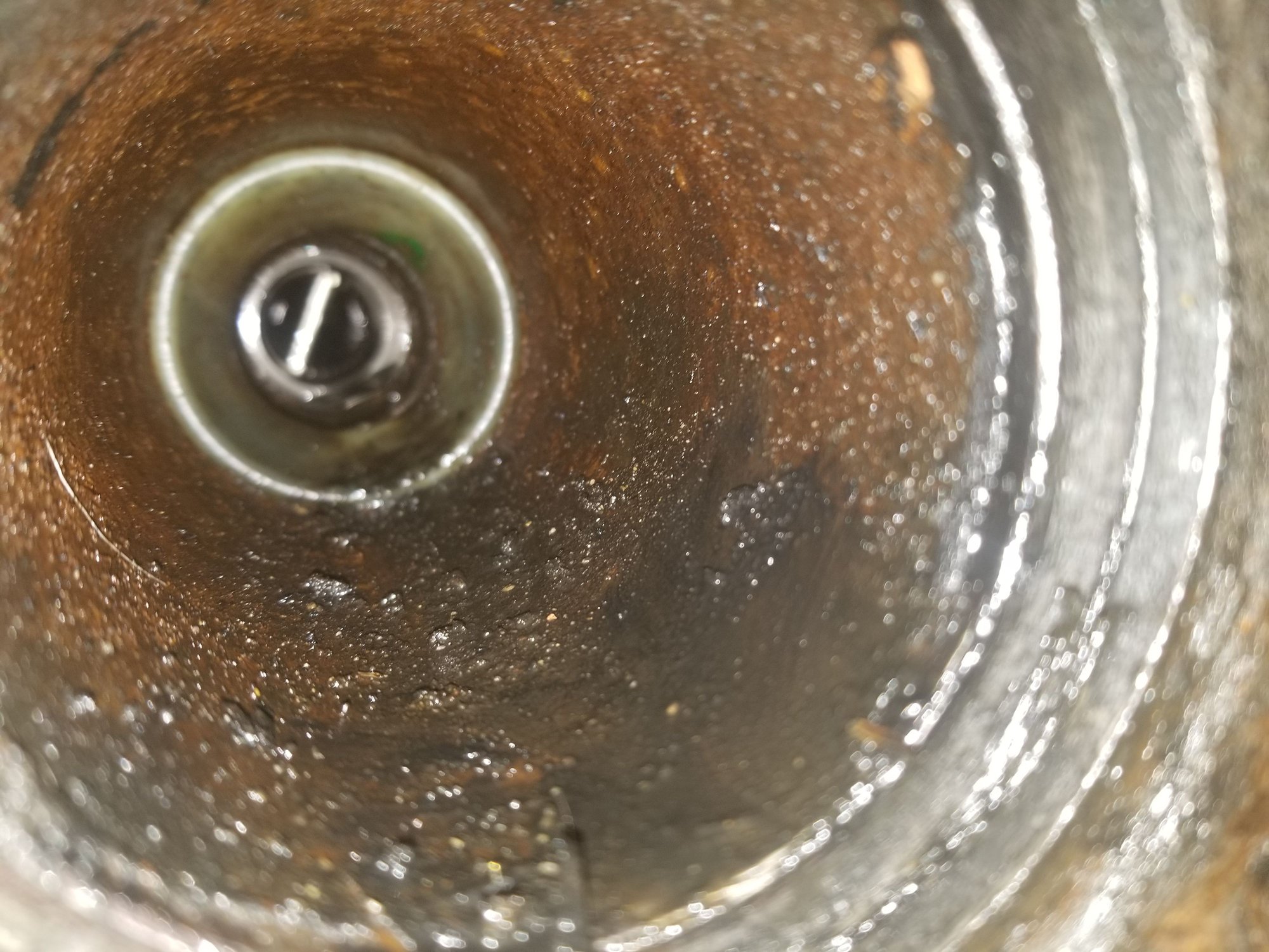

Axle housing/ the tube leading to front diff? Full of gunk

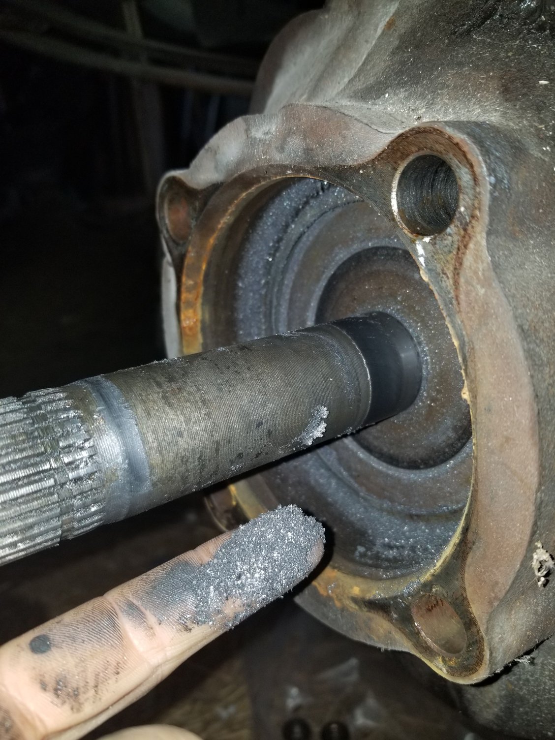

The pic w finger in it is the part I had replaced the wheel bearing assy. I only drove the truck 50 to 100 miles after it was replaced prior to this pic.

The picture with your finger. There looks like a groove in the shaft about 1/4" from the splines. Is that correct or camera angle. I'm not talking about the retaining ring groove. I am referring to the shiny spot on the shaft itself.
Good eye, but also why does it look like I'm seeing a nasty bur back where the needle bearing rides? And it almost looks blued from heat....maybe
But I agree the groove behind splines looks not good, although I'm not sure what would put it there...lockout maybe?

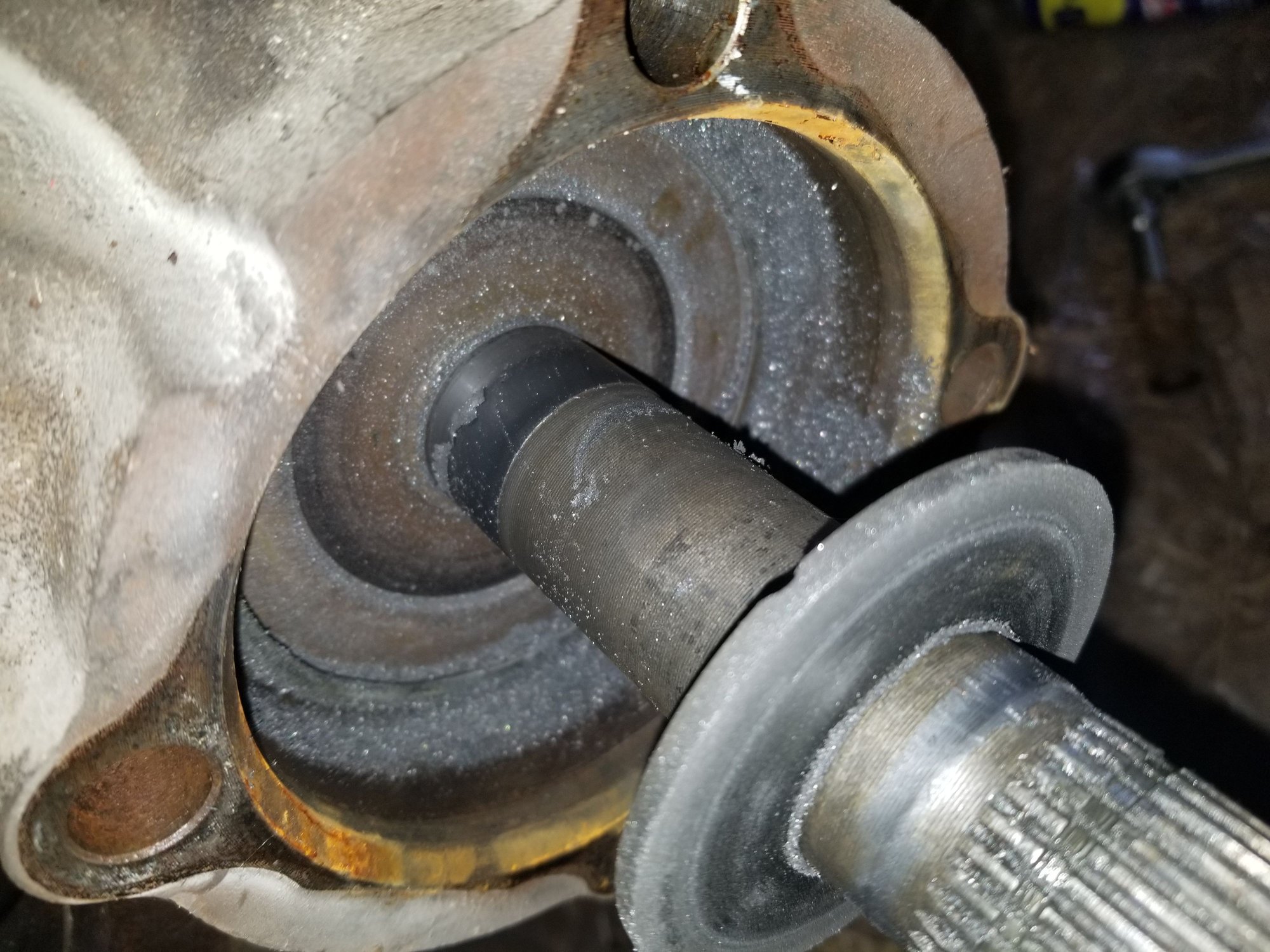

Yikes, metal shavings where they are not supposed to be. What's cracked in the first pix from the bottom?

Replace the big seal.. check the bearings..new dust seal on the axle. Check u joint...
lube needle bearing if ok. replace if not....make sure you have the 3 washers and circlip...
Lets see the back of the bearing. washer and needle get grease....If you don't know what you are doing get someone to help...too expensive to be fooling around in there.

ty. When I look at the shaft naked eye I dont see anything but when I reviewed all my many pictures after your question the rub is in all of them. If I run my finger over the area I can feel a lower spot or slight change. I had the middle of the 3 washers was broken. The 1 shaped like octagon had maybe 1/4 of ot missing.
a burr do u mean on the shaft or? Sorry I want to be sure I understand and I am seeing what you are referring to
