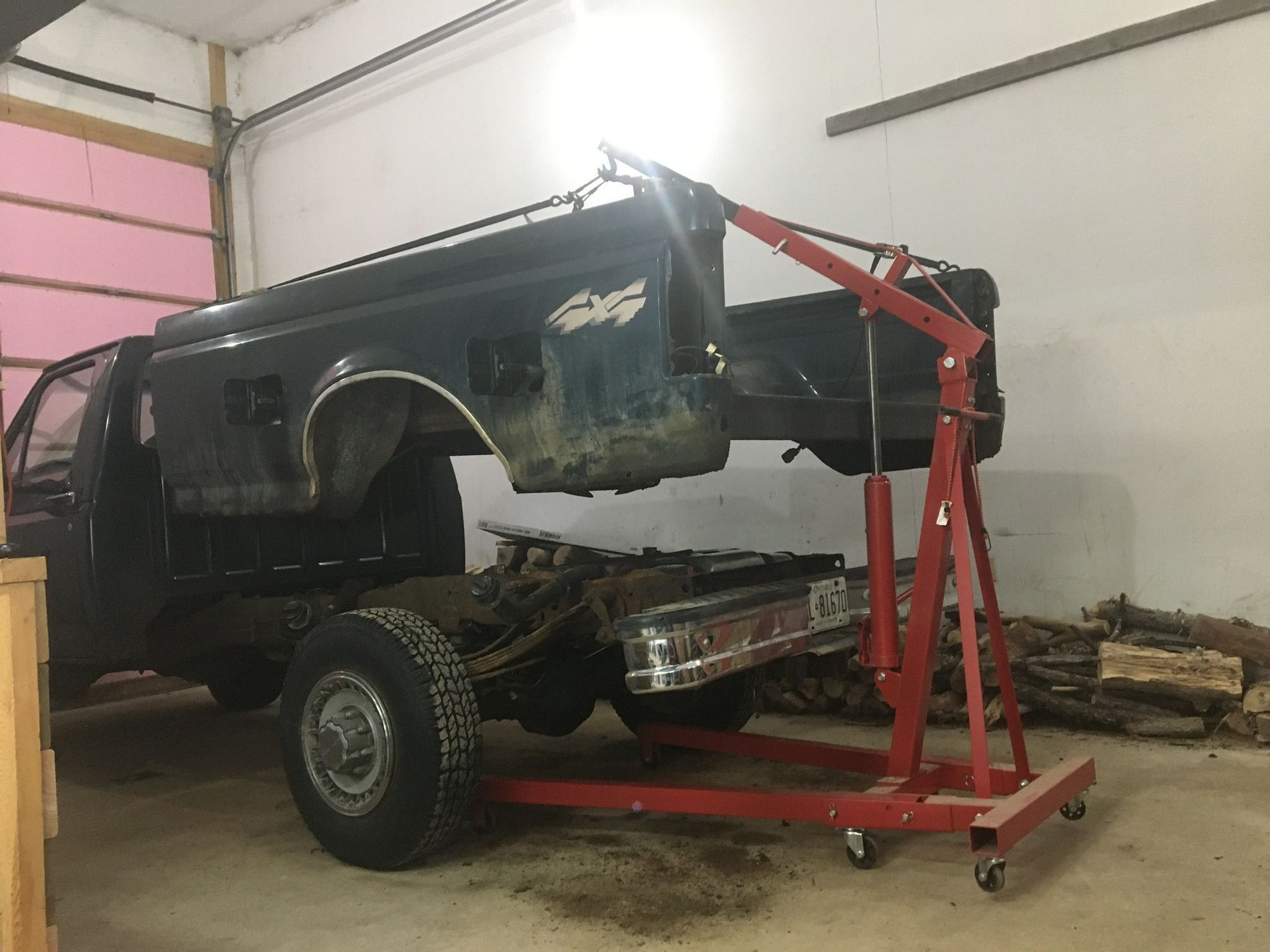

OBS, but same concept. Thought a picture might help. As above, I’m a lone diy’er too.
Cheers, 🍻

Did my short bed by myself, tailgate still attached, with my engine hoist and two ratchet straps crossed in the X style as shown above. Just make sure you get all the bolts out and you should be good to go!!

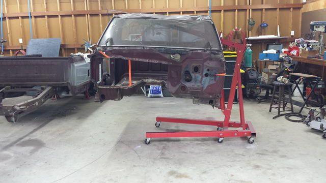

A Bull Nose, because of room and not caring that the hoist hit the bed side, other side of bed was crushed in a roll over, I did it from the side.
I have also used ratchet straps over the rafters in my garage to lift on and off the flare side bed when I was making a custom metal ribbed floor from the bed above.
You can also use the hoist to remove the cab, Guys make a wood jig to fit on the roof and the hoist/
I have also used the hoist and straps to pull the nose, less hood, off this roll over truck.
When you are a team of 1 you do what you have to to get the job done
