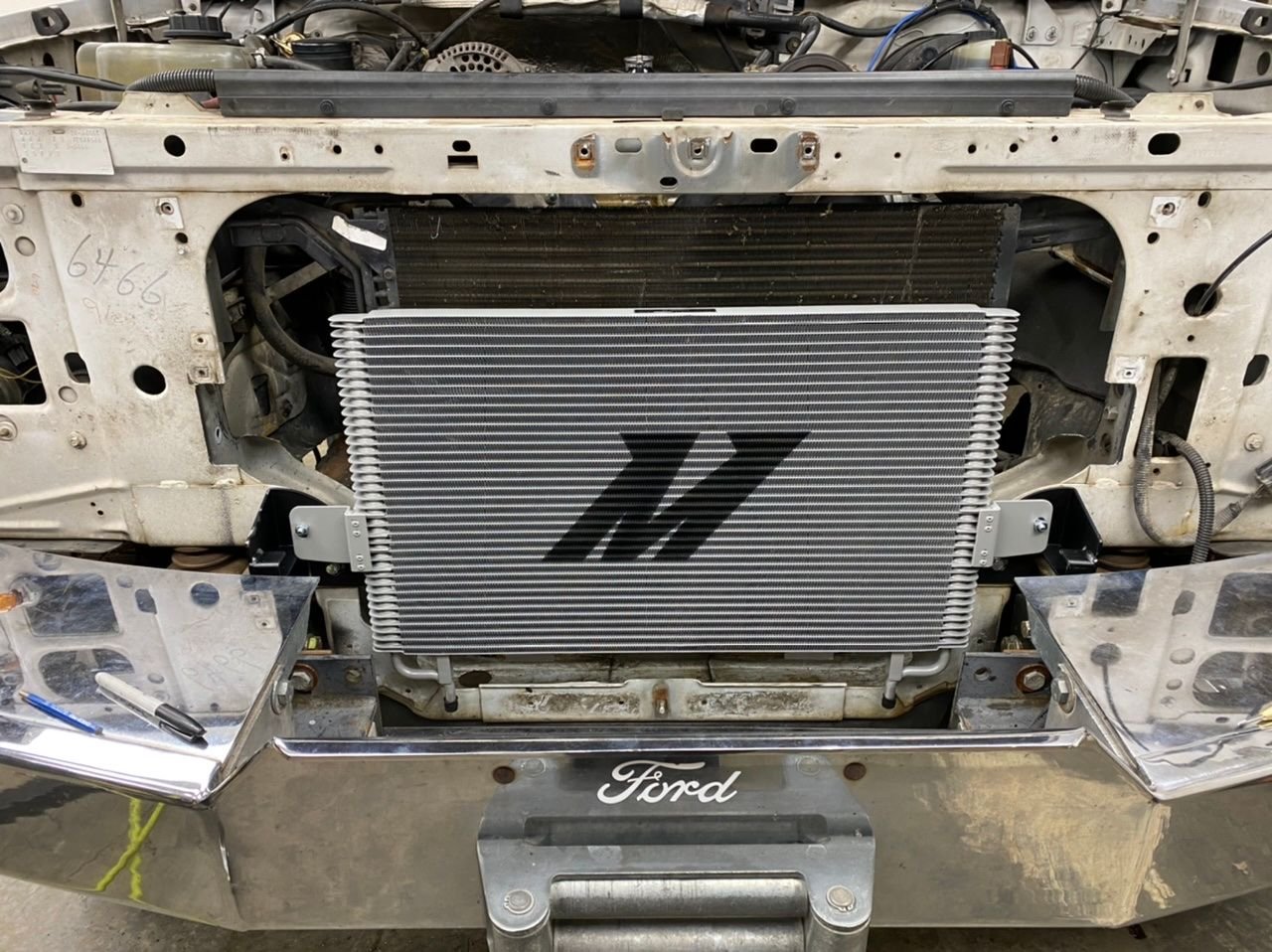

I don’t have a great photo because I avoided removing my bumper. But here are the lower brackets holding my trans cooler. The intercooler sits in front.
I had mine powdercoated which was dumb, you can see a few chips where I scraped them up before I realized my intercooler tabs were too wide. If you run a trans cooler you are constrained on the bracket placement width so I just shaved my intercooler tabs down to fit.
