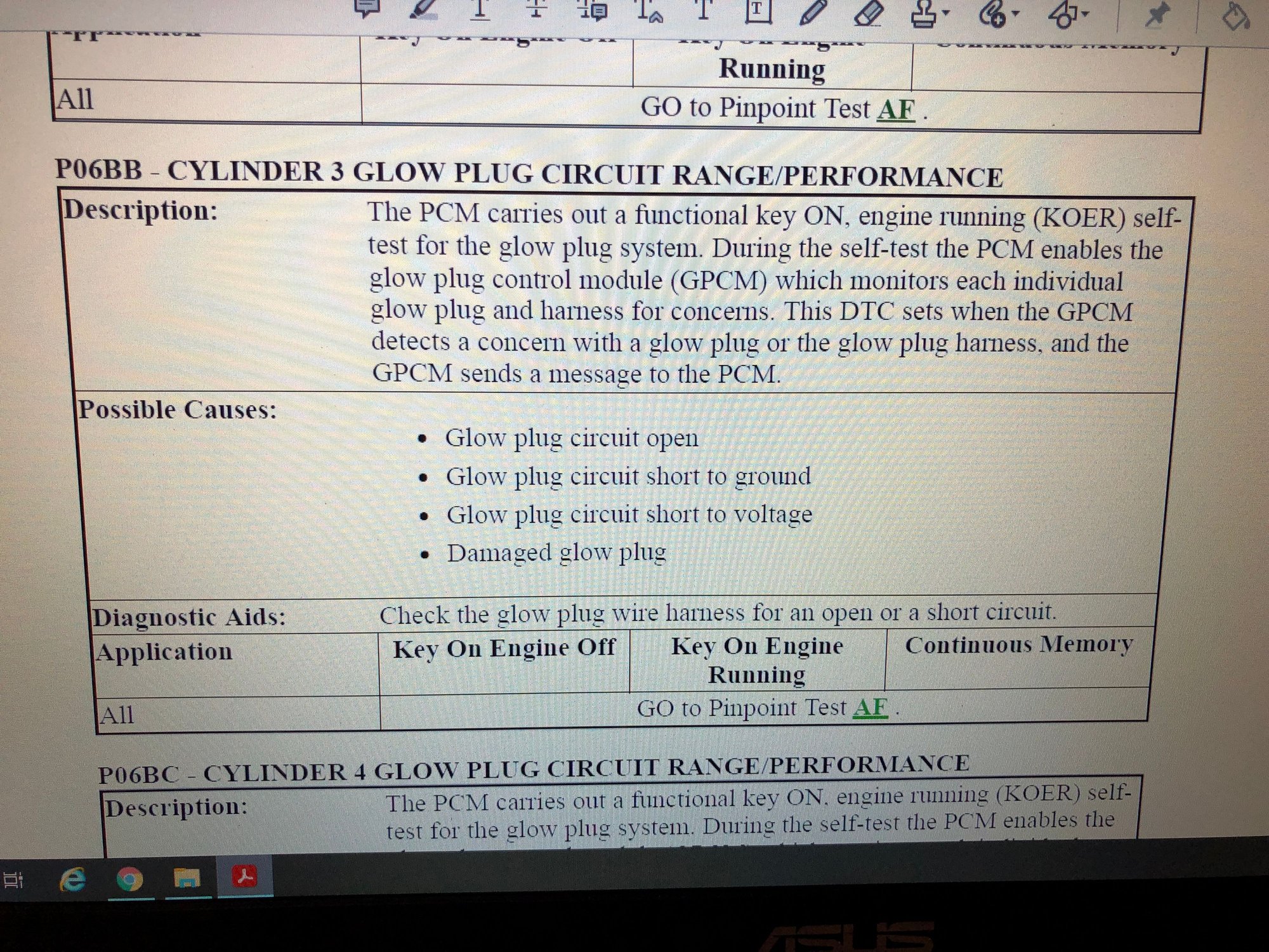

I'm about to take off the fender liner to do my #3 plug as I got a code saying bank 3 misfire. But before I dive in, curious if anyone has done their own plugs before? Any advice? They look buried so wish me luck! I'll take pictures.

Code is P06BB.

So I don't think it's a misfire, just a code for that glow plug. Are you getting other symptoms?

Cool, thanks for looking that up! Maybe just bad fuel milage around 14 mpg. And check engine light.
