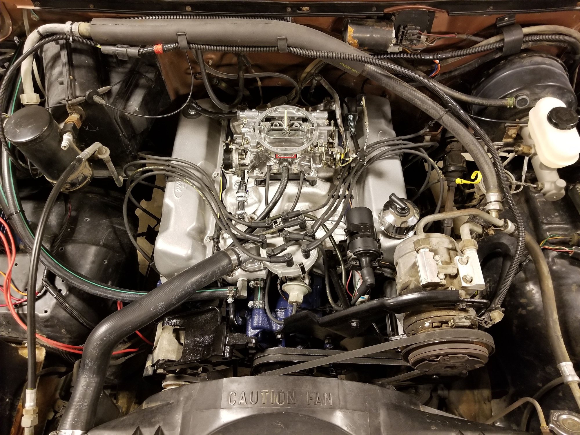

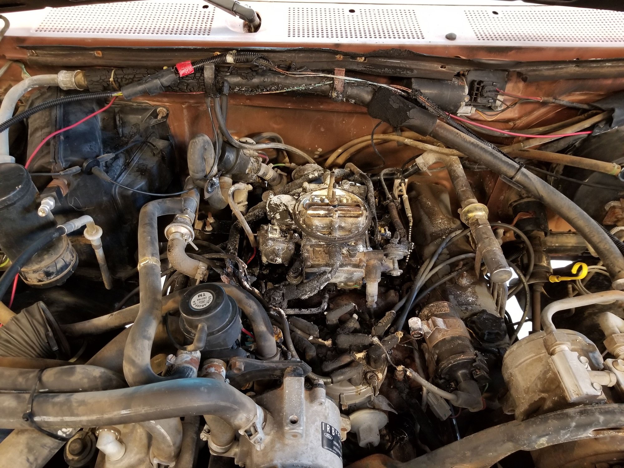

Hi guys, I'm working on an 87 F250 4x4, carb'd 460, C6 that has 45,000 actual miles but suffered a mild engine fire. The fuel line to the Holley came loose and that was the end of that. I bought it as a non-running project because of the fire. It was an old guy's camper rig and overall is in amazing shape. I pulled the engine out, tore it down to the long block for a straight up timing chain set, new gaskets and seals, de-smogged, Edelbrock intake and carb, new hoses, lines, etc. I've got it all back together but for some reason now I have no fuel to the fuel pump. I've put gas in the tank so I know there's gas. It has an engine mounted mechanical fuel pump with a return line and I believe it also has electric pumps in the dual tanks. I've tore into the dash and the selector switch is good and working and there's power going through it as it's supposed to have. I've bought several manuals and still don't have answers to several questions or a troubleshooting flow chart. I've done some online searches and found this old thread https://www.ford-trucks.com/forums/1...7CAGtKUB2W13Cw that was some help but the diagrams talk about parts I don't believe I have, like a relay under the hood. I would also like to know where the inertia switch is located? My next thing to test I guess is the selector valve on the frame, but I'm not sure exactly how to do that. Am I even on the right track, or is there something simple I'm overlooking or don't know about? If there was enough gas flowing previously to start a fire, I would think that part would still work. I'm open to suggestions. Thanks.

Thanks for all your responses. While the engine runs, I still have a fuel delivery issue. It may be a bad selector valve, or it may be something else. I've determined I do not have the hot fuel handling setup and I don't believe I have in tank pumps. I only have 2 wires going to the fuel senders (+ & -), not a third that would be for the pump. I put compressed air into the tank and between that and suction on the other end of the fuel line, I was able to get a little trickle of gas to come through. It's not enough to keep the engine running. I cranked it enough to fill the carb, but after it started it ran the carb dry. It ran great off the gas can the day before. I guess the next thing to do it try to bypass the valve with a short hose from the tank line to the front line and see if fuel flows better. I can try to blow out the lines while I have it apart. Does this sound like the right track, or is there something else you would check instead? Am I missing anything? I have, and have had, several of these old trucks over the years and for all the stories I've heard about valve and switch issues in the fuel system, this is the first time I've personally had an issue. I assumed someone here would have seen more than me and had experience with troubleshooting.
FYI, the manuals I have are the factory service manuals. I have the engine manual (B), the Chassis and Electrical manual (A), and the Engine/Emissions diagnostic manual. (that one is worthless) and the recommended EVTM manual is on order. I realize you guys don't know me that well, but I'm usually the guy with the answers, not the questions, and I feel a bit out of place, as well as perplexed. Please forgive me if anyone feels insulted.
