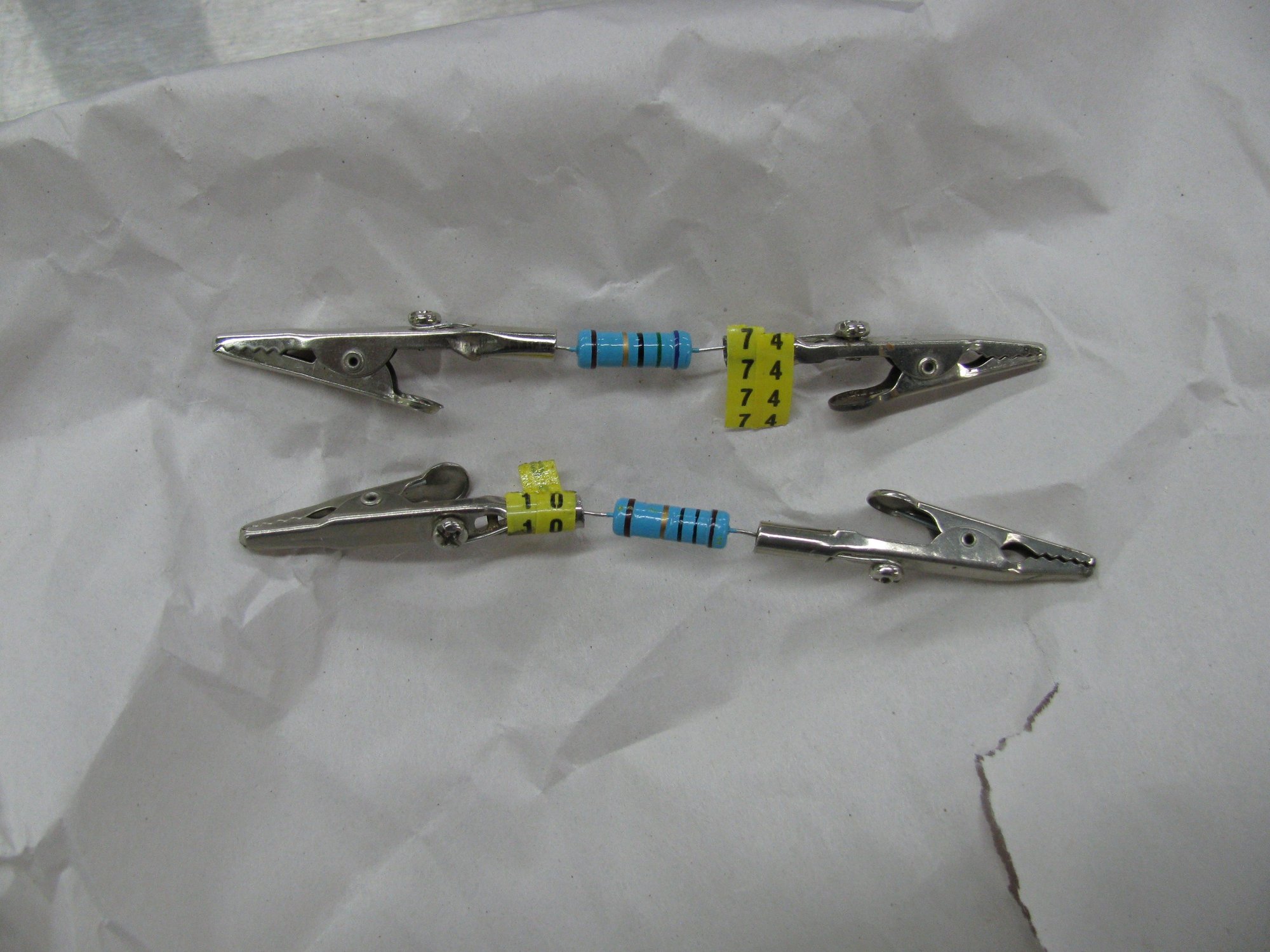

Just resurrecting this old thread with a question. My oil pressure gauge goes immediately to almost high on start up and doesn't move up or down from there when driving. I bought an oil pressure test gauge, as suggested, and connected it at the sender unit connection and got decent pressure. Warm engine, 600 rpm 26 psi, 2500 rpm 50 psi and 3000 rpm 52 psi. Is there a way to test the sender unit? If so I would like to try before buying a new one. In all likelihood it is a problem with the truck's actual oil pressure gauge, but wouldn't mind testing the sender unit if possible. Otherwise I could just buy a new sender unit and see what that does. At least I know from using the test gauge the pressure is not too bad.

No way to accurately test the sender. You can test the gauge without removing it from the panel providing your other gauges are working correctly. All the gauges work on a nominal 5 volts and 10 ohms high reading and 73 ohms low reading. If you can get a 10 ohm and a 73-ohm resistor you simply connect the resistors in place of the sender and turn on the ignition. + or- an ohm or two won't affect the reading. Using the resistors every good gauge I've tested lined up within a needle's width of the high and low marks.
Old Apr 11, 2024 | 10:48 AM
Jim_K's Avatar
Jim_K
Joined: Sep 2012
Posts: 739
Likes: 256
From: Zimmerman, MN
Nice!
I just use a 100 (or 150?) ohm pot, but this is simpler!
