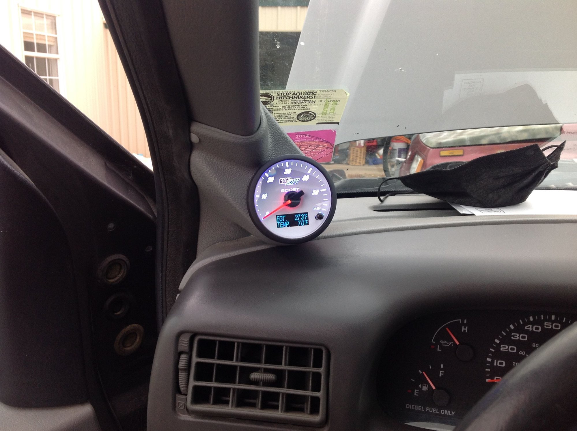

Well, I guess you can say I have officially begun down the dark road. It was simple, very simple. But a start none the less. I have done the pre-requisite to all other modifications, data! I installed a GlowShift 3 in 1. It is Boost on the sweep, EGT and transmission temp on the digital. I went with the single pod that fits at the bottom of the pillar. My initial take...my biggest concern was the fitment and such of the pod. I will say, fit and color is not completely perfect, but it is very good. I think the color is definitely close enough that I won't have any long-term regrets. The fit is also good. The kit came with some "Christmas Tree" trim clips to hold it into place nicely. I used a RiffRaff AIH delete for my boost tap, and also ordered the drill and tap from RiffRaff for the EGT probe. One thing I like about the GlowShift kits is that they are all electric gauges. From my past experiences, I do not like having to run the stupid nylon hoses for the boost gauge. So, the 10 different backlit colors is pretty cool. I need to clean up the install...I only had 1 add-a-circuit, so I need to get another one so I can wire up the the ignition and constant voltage seperately, I just have them tied together on the ignition feed. So picture...

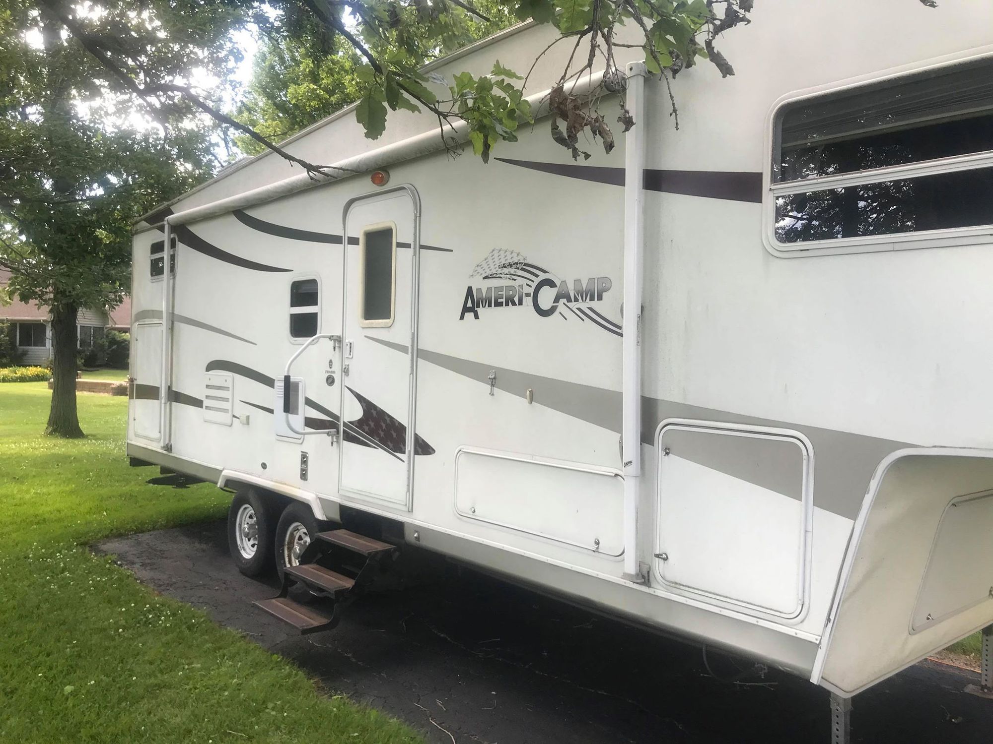

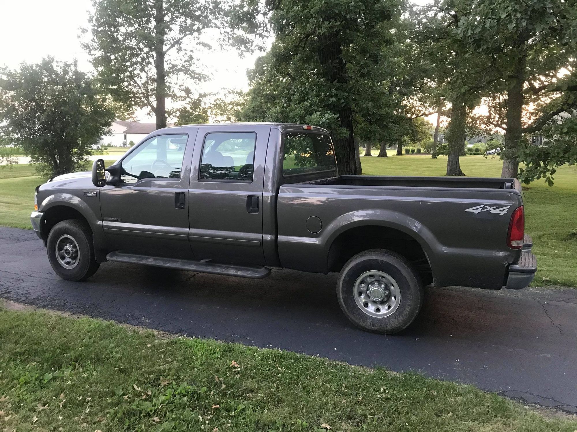

Also, a couple of pictures of the truck sitting in Illinois before I bought it, as well as the fifth wheel we bought with the truck. The gauge install is also in preparation for a 2500 mile family trip we are making in a week to Kentucky with the trailer.

aawlberninf350's Avatar
aawlberninf350
It's a Van Gogh
Joined: Feb 2010
Posts: 7,812
Likes: 1,335
From: Elk Grove, CA
Great looking truck!
Kinda lovin' your single pod down low. My full size 3 pot A pillar obscures a big hunk of forward visibility. Nice to keep that open to view.

I used to drive a work pickup that belonged to my boss, 07 Classic Duramax, and it had a double pod with boost and pyro. I did not like it at all, so I had that experience going into this. Between the blind spot, and I just felt the gauges sat to high, and it was uncomfortable to view them, I was not a fan. I was really puzzled about what I wanted to do for gauges in this truck. Then I found the GS 3 in 1 units. I am sure that up against an ISSPRO, or other high end unit, there may be a bit of inaccuracy, but this should work just fine for what I need, and that is just something that keeps me close enough to the ballpark that I don't tear something up! If you are pushing the ragged edge to the point that 10 degrees of EGT is make or break on your gauge, break it will probably be!

So far running around today I am liking the gauge. It has another wire I did not wire up that makes it go from day to night illumination. I am going to keep using it for a little bit before I decide if I want to mess with wiring that up. This morning at 6:00 heading into town for breakfast the "day" illumination did not bother me, so I think it will be okay.
