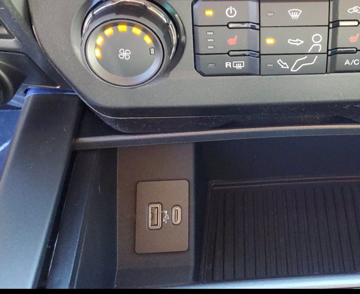

On the sync 3 topic....
do you have to use the older study USB port on the left or can you use the newer usb C on the right?

Originally Posted by markplace
@ford390gashog Not sure that is correct 100% of the time. I just bought a 2016 F250 and upgraded Sync to the latest version of Sync 3.0. No go with Android Auto. I always get an error when I plug the phone in ("USB insertion error"). I called Sync support who looked up my VIN and told me that my vehicle was not capable.
Some googling around leads me to believe that the USB Adapter that I have is USB 2.0, but that 3.0 is needed. Apparently one can upgrade the adapter but I haven't found a source for that. Yet.
For the 2016 USB connection on the F150's we would swap them with one from a 2017 and get Apple CarPlay to work. Android Auto would work on the 2016 F150 without the swap. You might just have a bad USB hub or cable. They are pretty simple to change out, I have done a lot of them for friends.
Not sure if the F250 changed at the same time or not, but I would at least swap cables then pull the USB hub to make sure the cable is plugged in correctly. If all else fails maybe buy a new hub.
I used the USB C connector for awhile. It started dropping Apply Car Play then starting it again. I swapped to the other USB port to see if that helped, and it didn't. I cleaned the Lighting Port on my phone and all is right with the gremlins again.
So yes you can use either plug.
