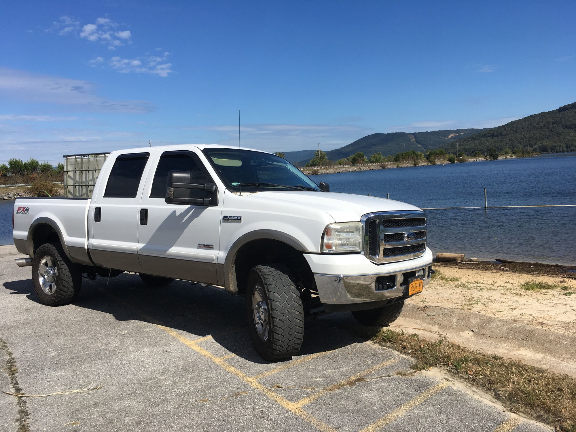

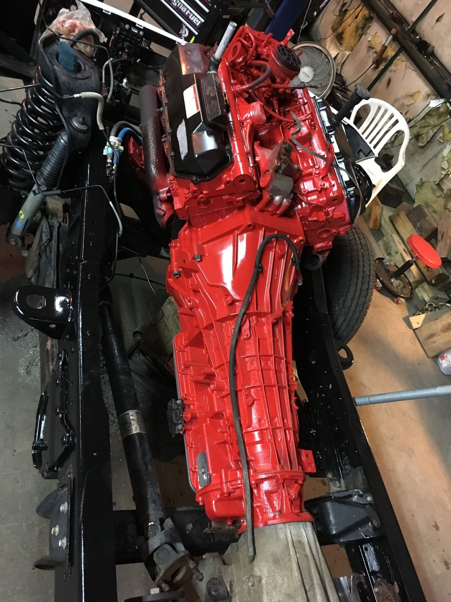

We try to remove all the fries, etc from the oil before using it, but yes I burn the high cholesterol fuel. I started 15yrs ago and have almost 400k greasy smile miles between my dually and Excursion. I always say it’s the only hobby I’ve ever had that did not COST me money.
No thanks on the rust!! My experience with the crusty brown stuff is limited to extracting ‘good’ 7.3 drivetrains from rust buckets and putting them in minty nice southern trucks like this last 2006 F250 7.3 I built.

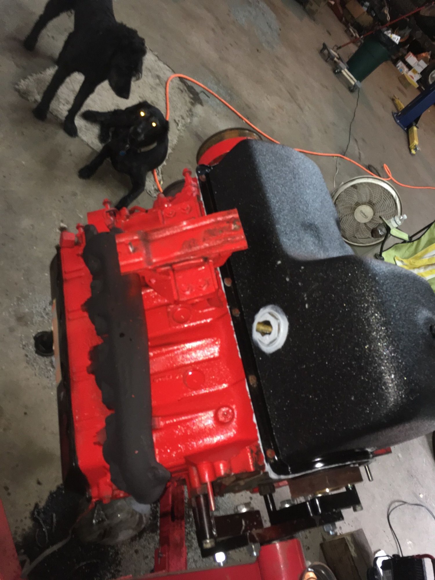

SkySkiJason:
My goodness! You sir are a god! I almost did not recognize what the long pieces of rust free metal with the tires under it was, but it is a frame!! :-).
Is that a brand new oil pan on the engine, or did you just clean up the existing one?
That is a nice completed truck.

Originally Posted by Pa Teich
SkySkiJason:
Replaced the rusty oil pan with a new one that I had pro bed liner sprayed on.
Our ‘southern’ trucks often look like that. That ‘06 had the same amount of ‘rust’ it left the factory with. Literally looks like brand new.
All of that work (prep, paint and then fluid film) was because the poor thing was being sentenced to upstate NY for the rest of its life. I literally did everything I could do to make it last the longest..,
