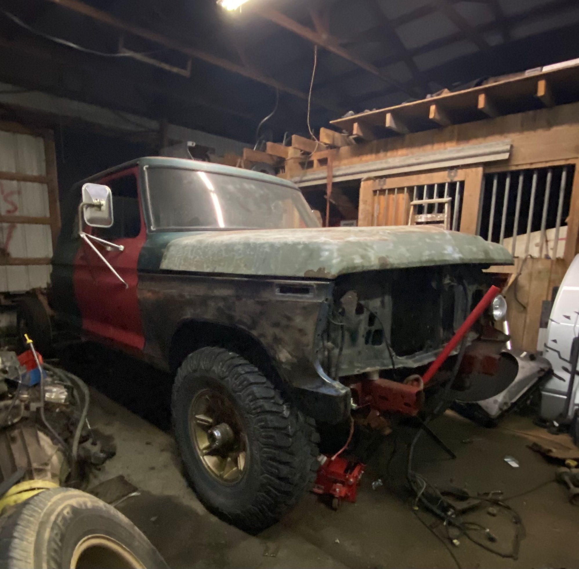

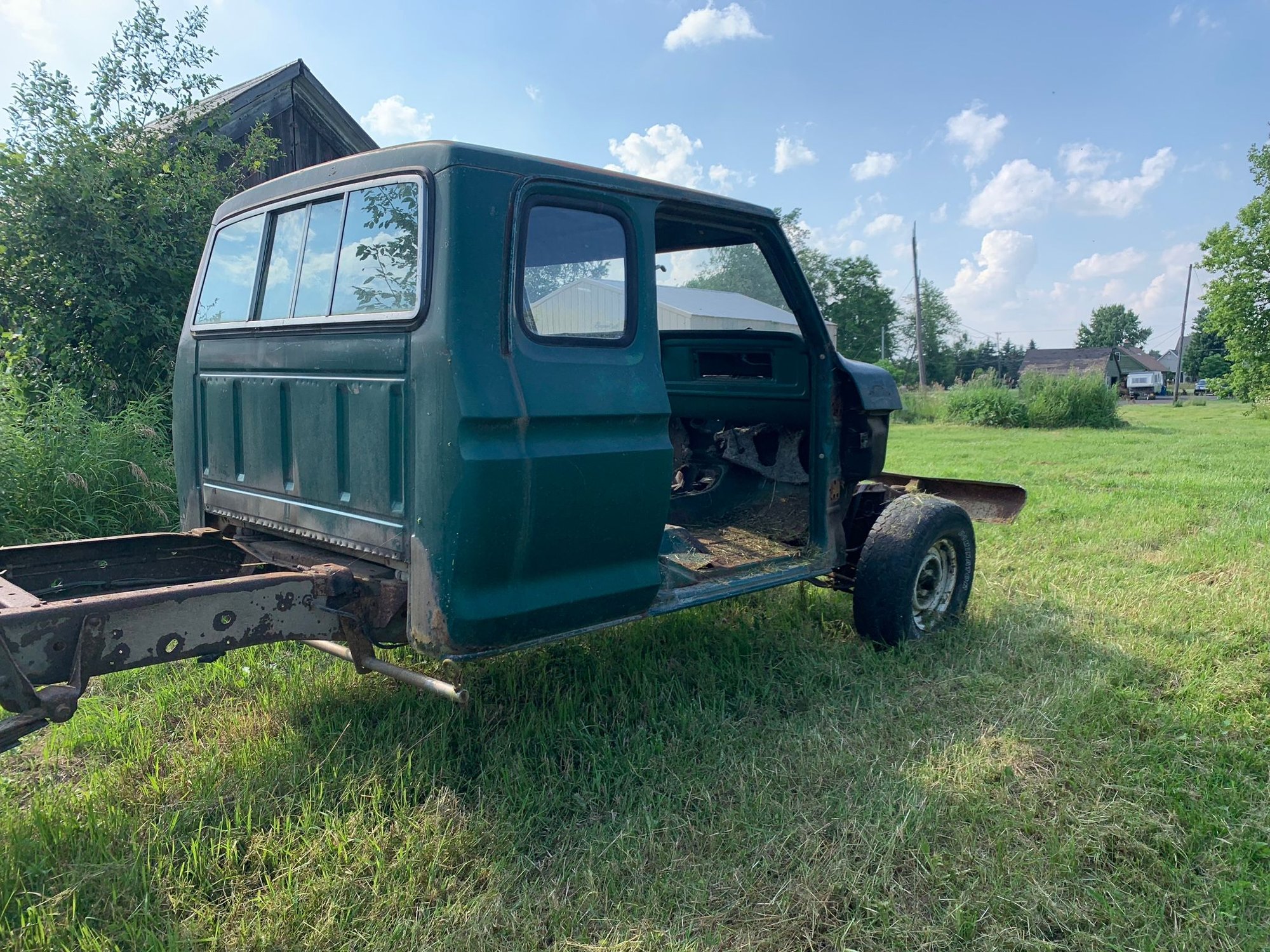

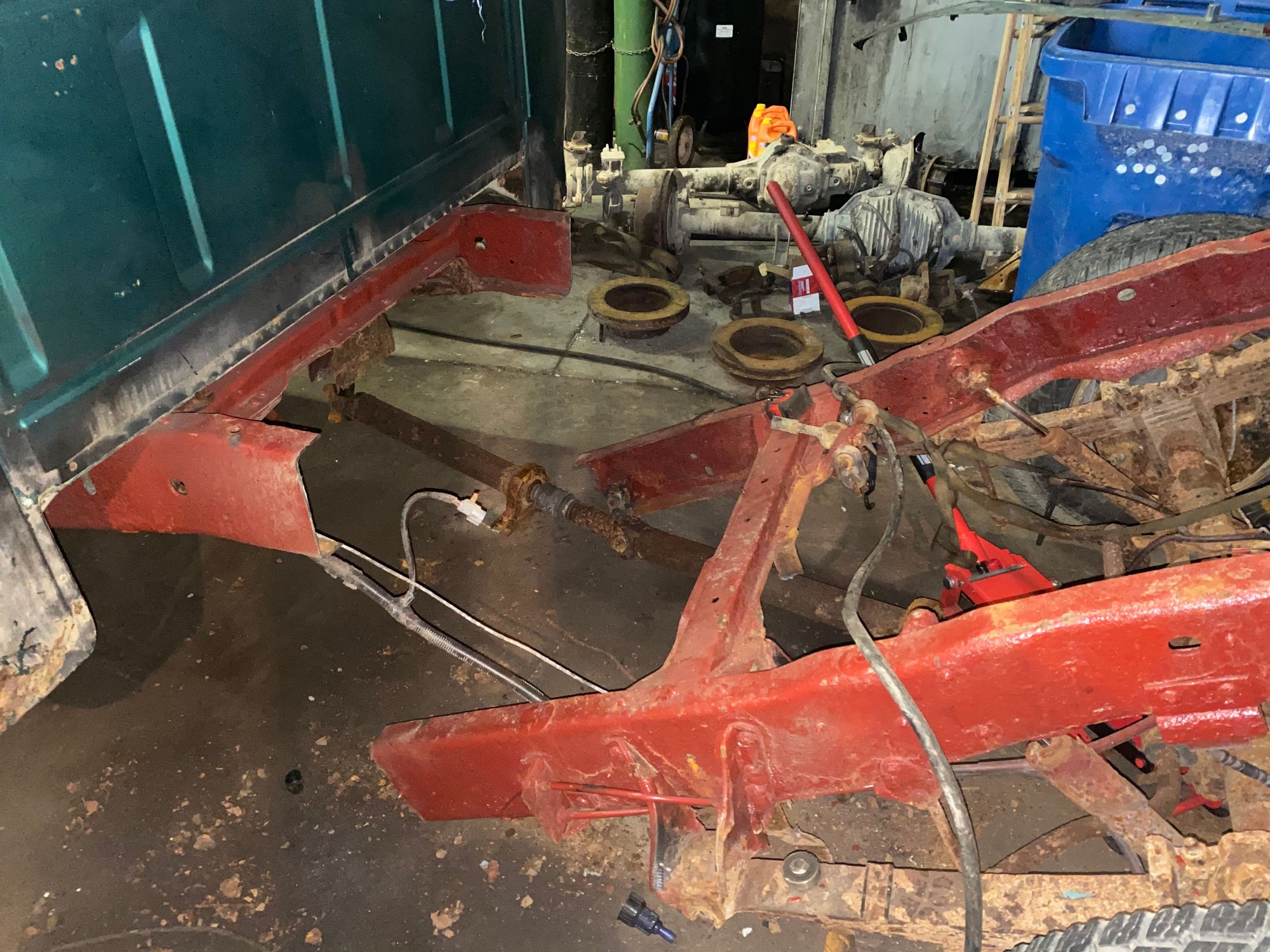

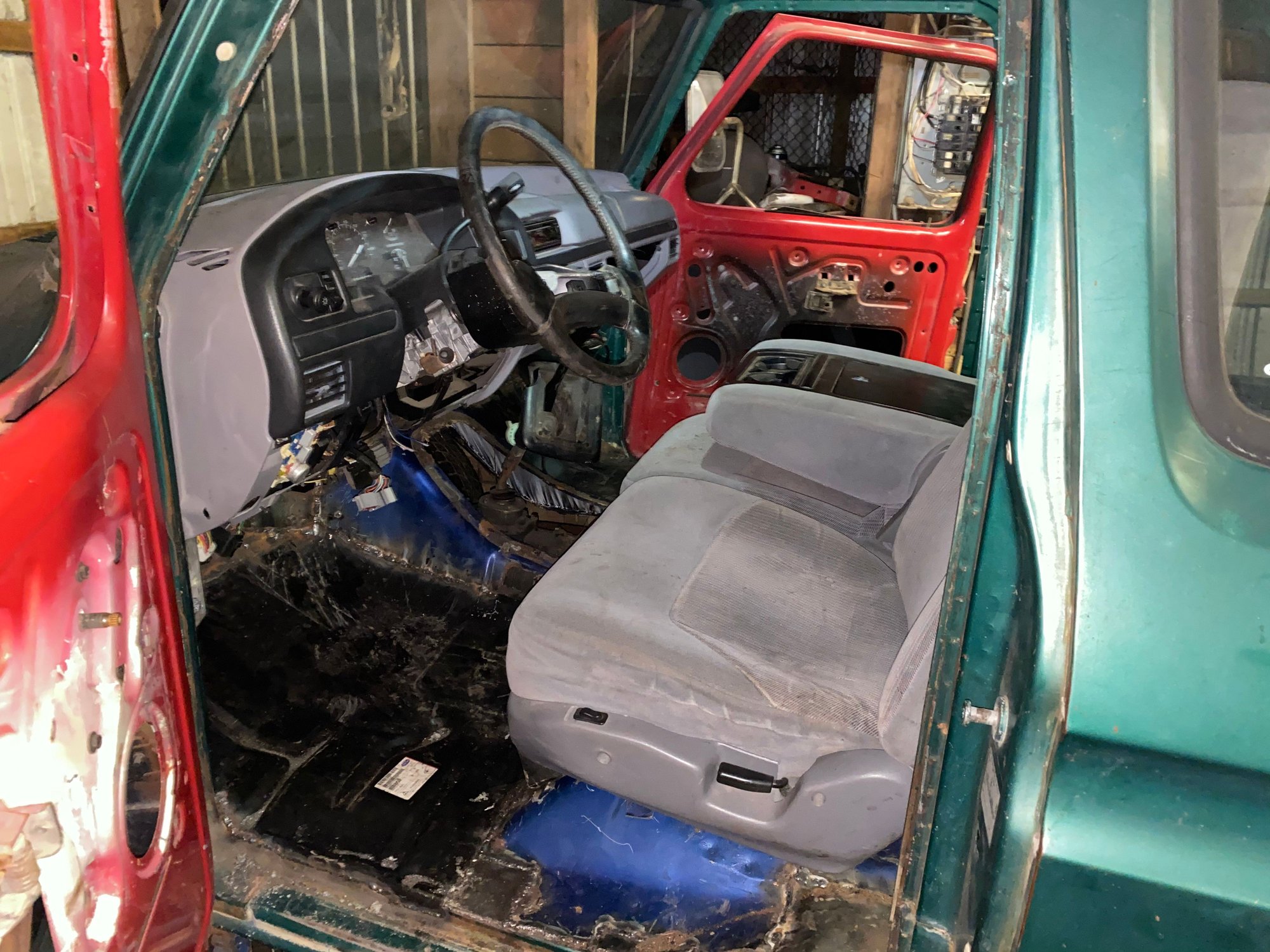

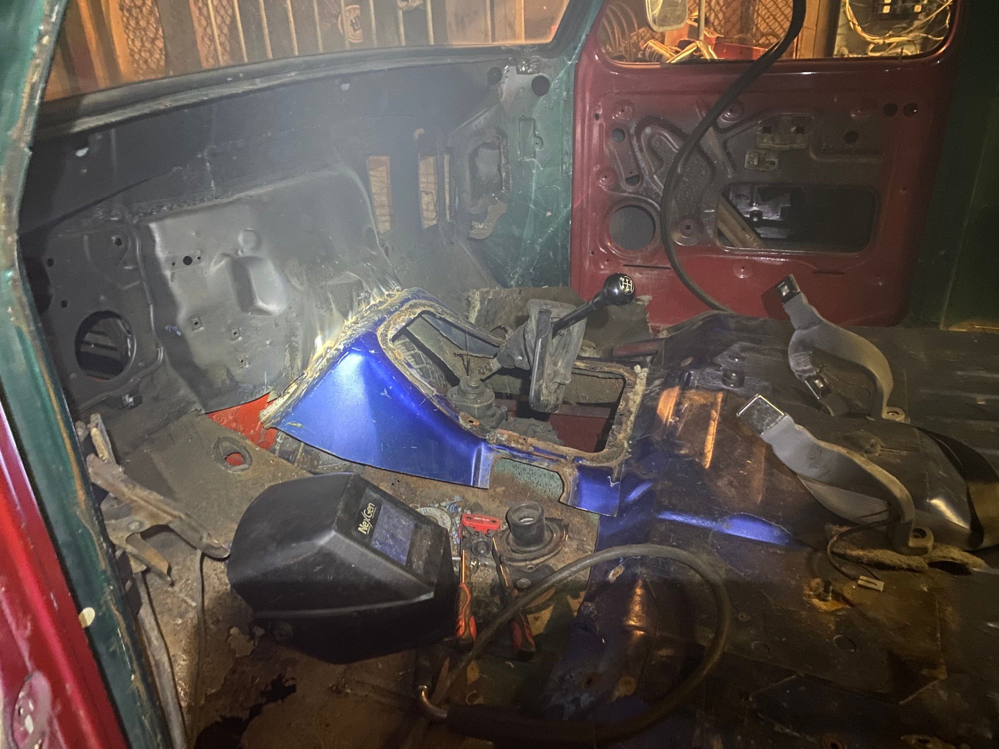

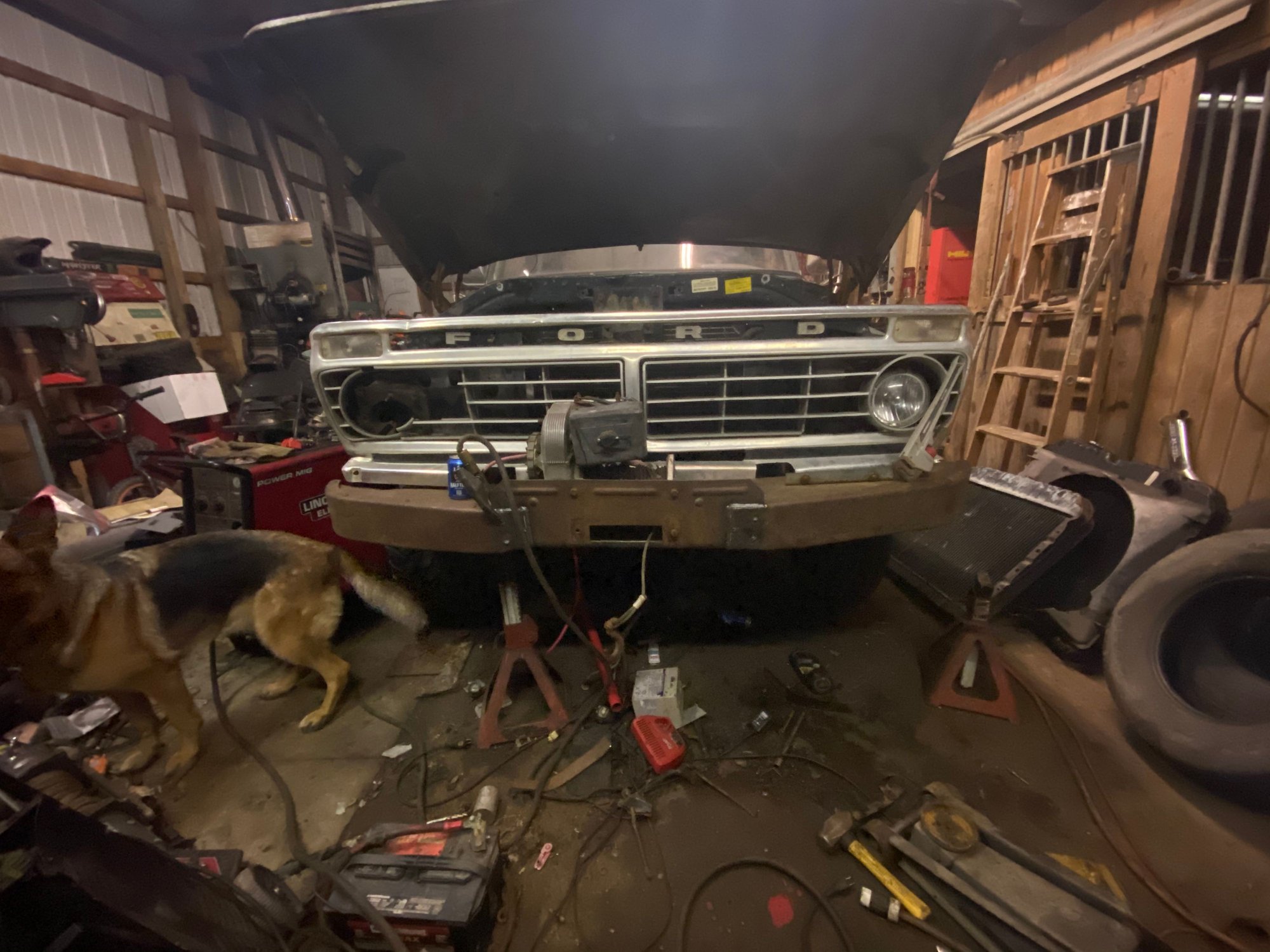

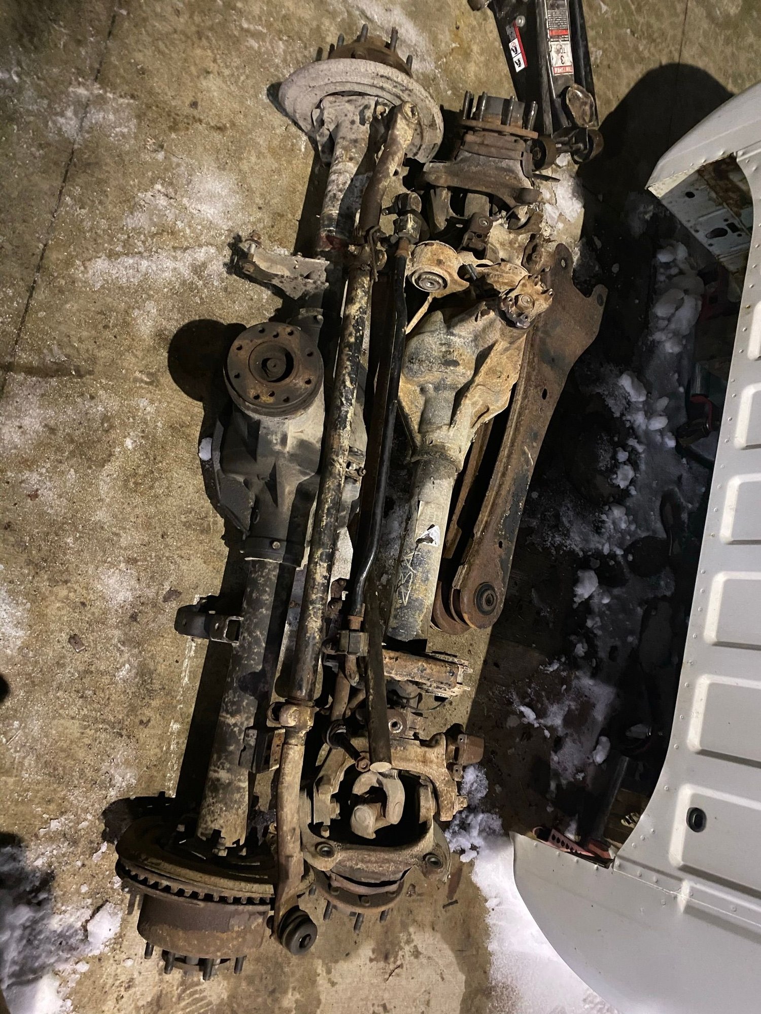

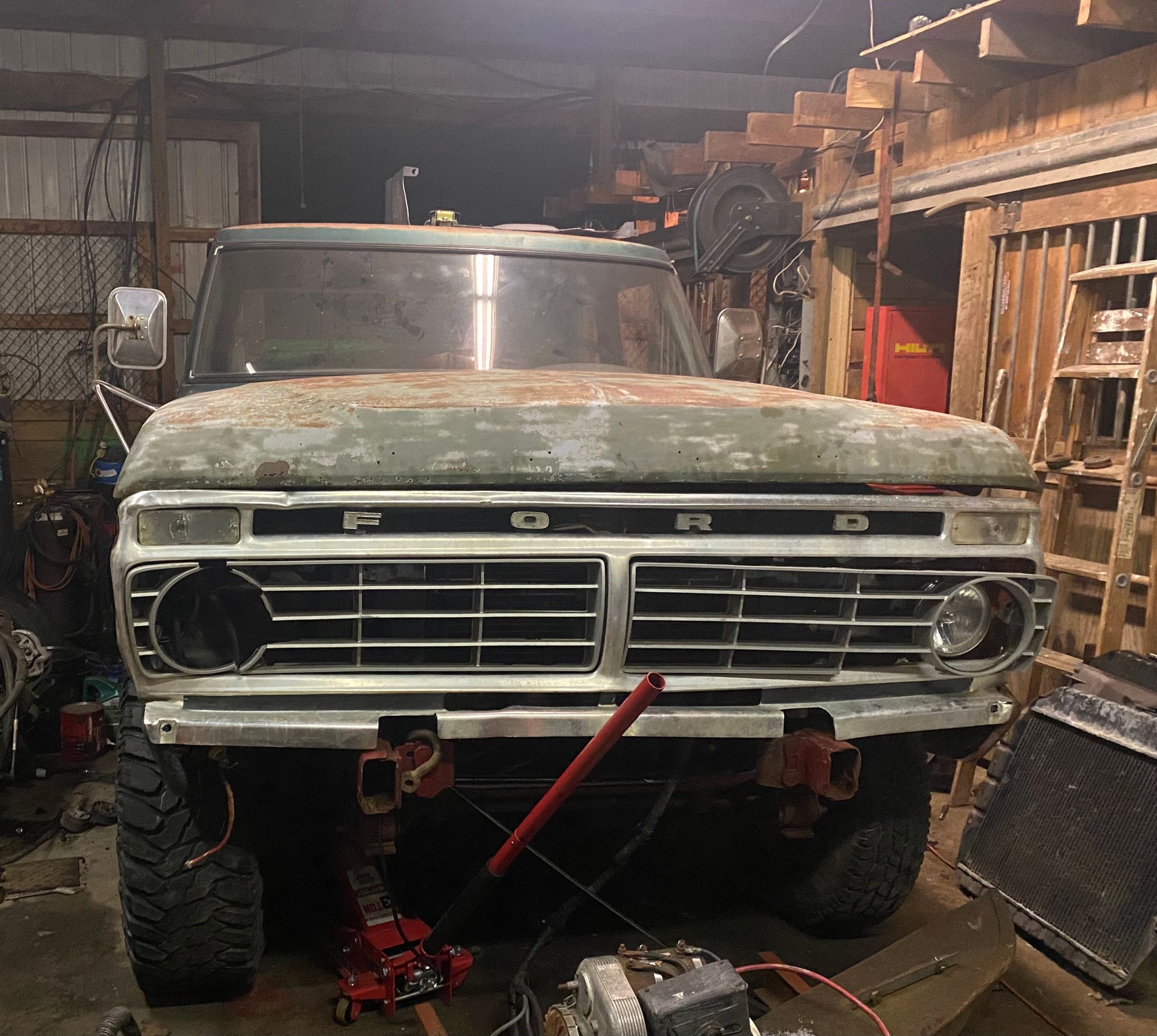

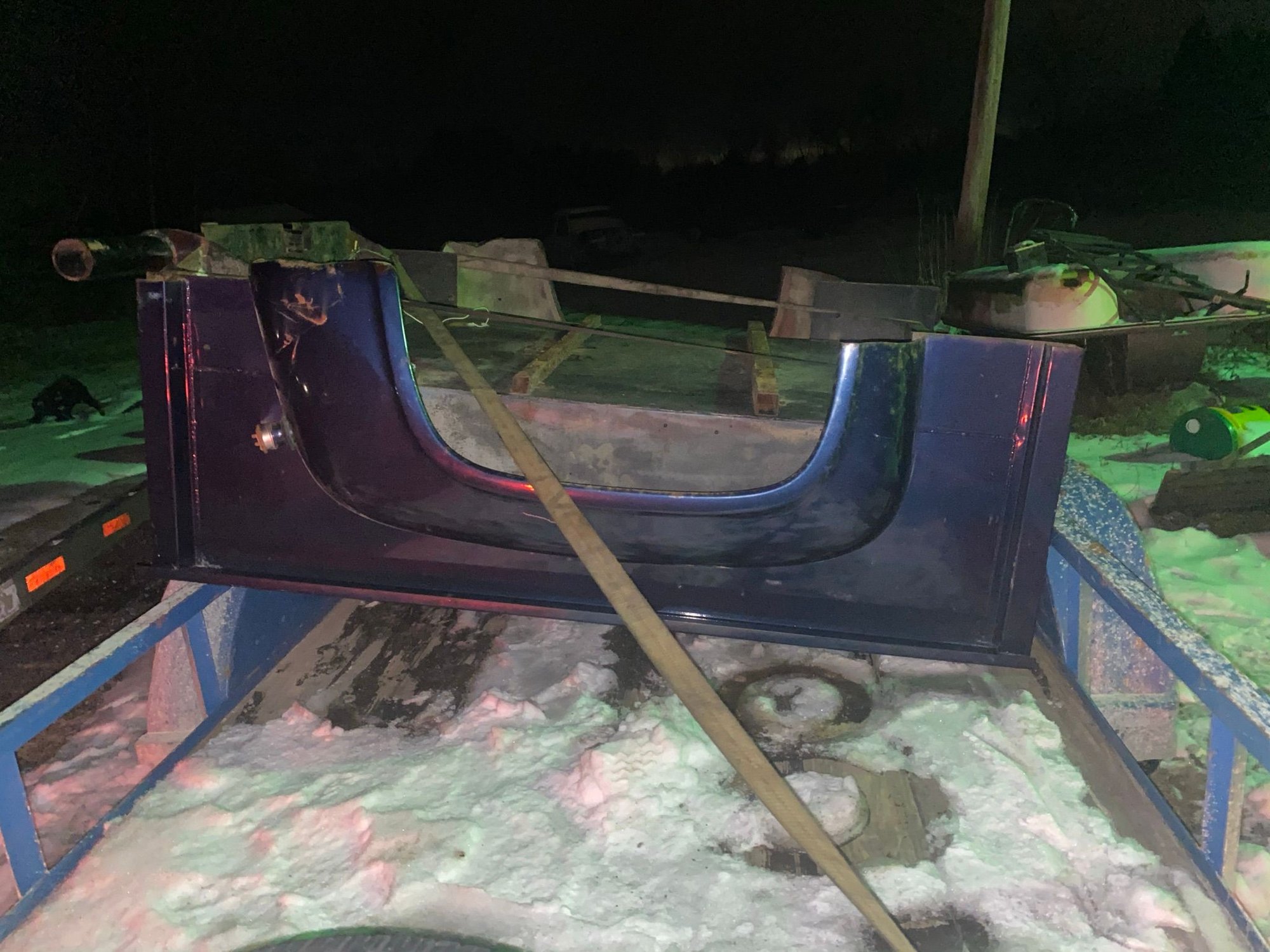

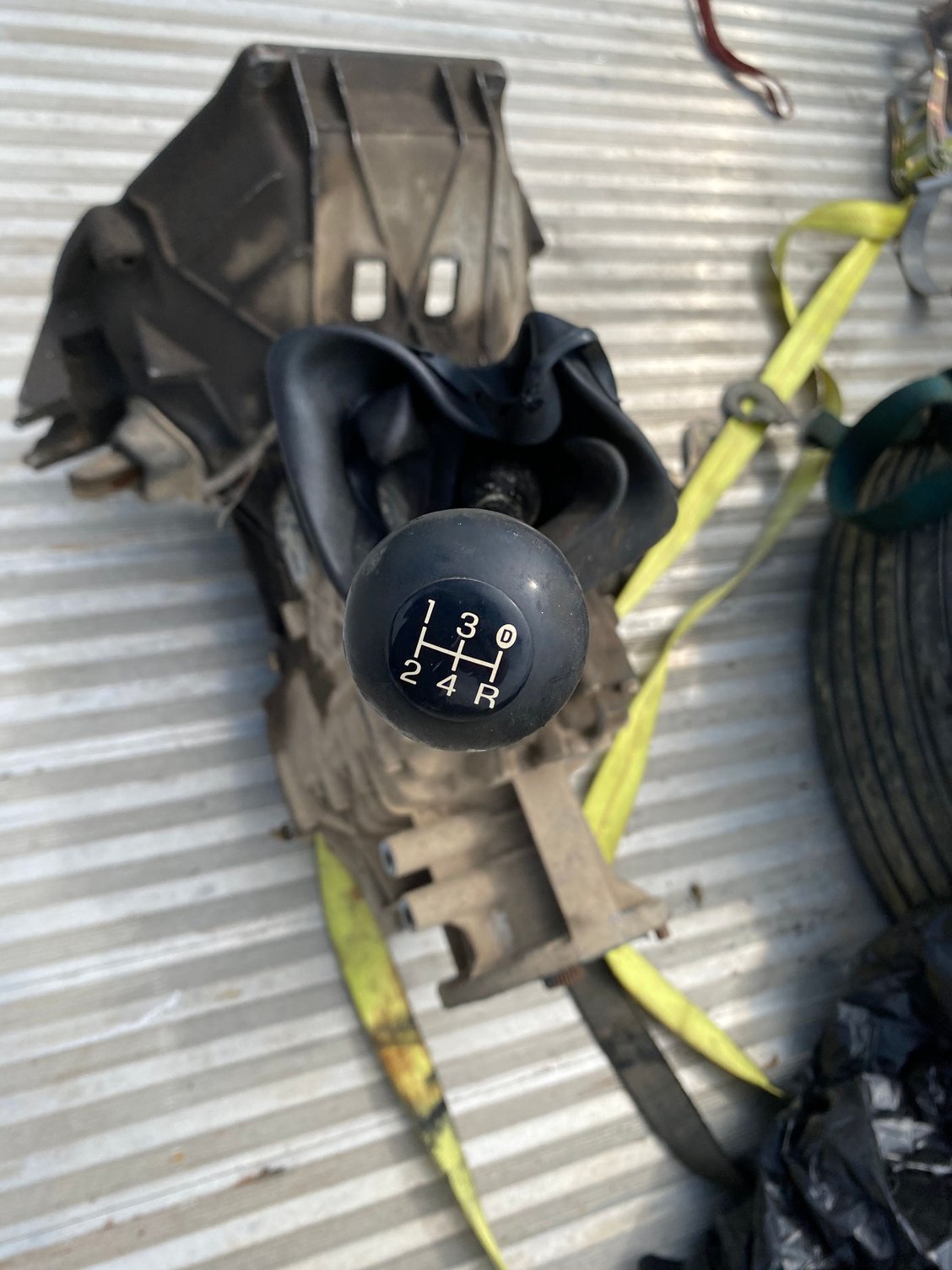

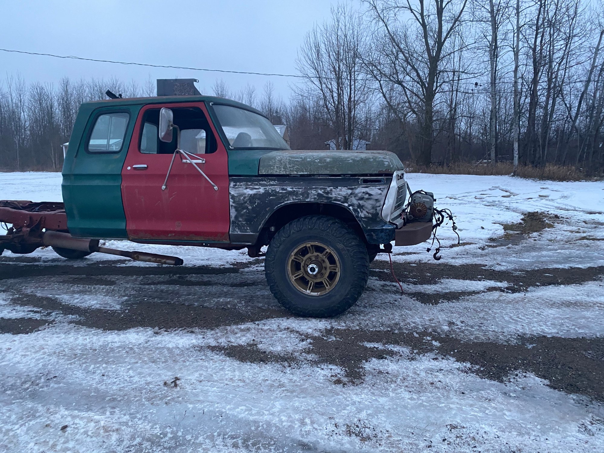

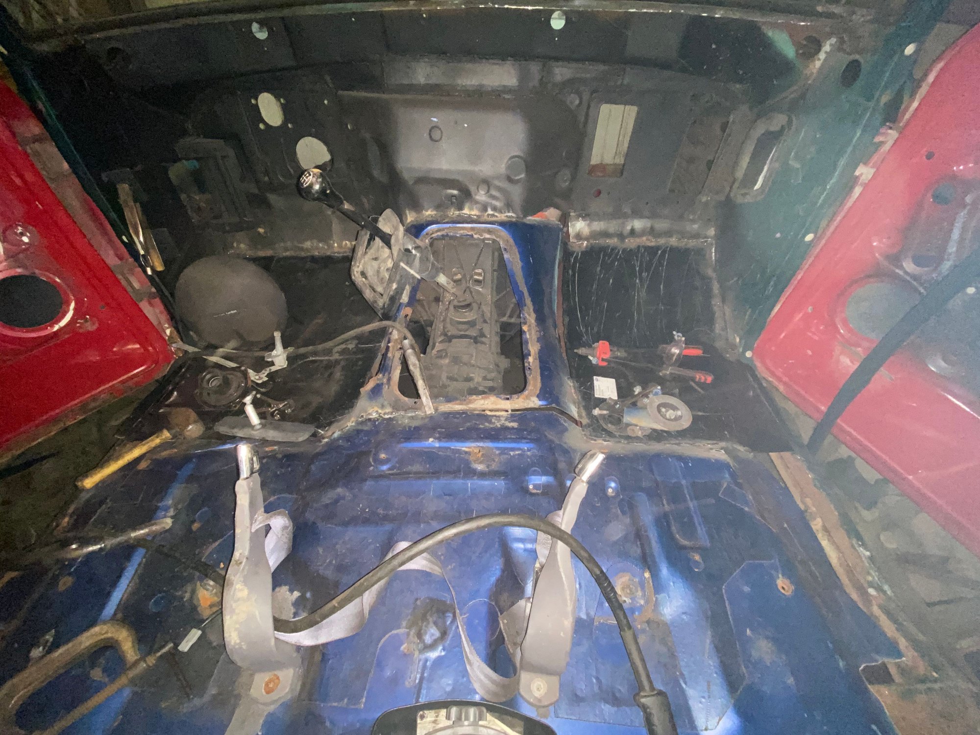

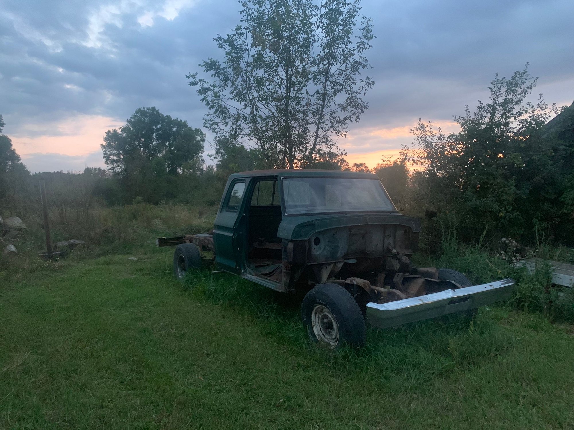

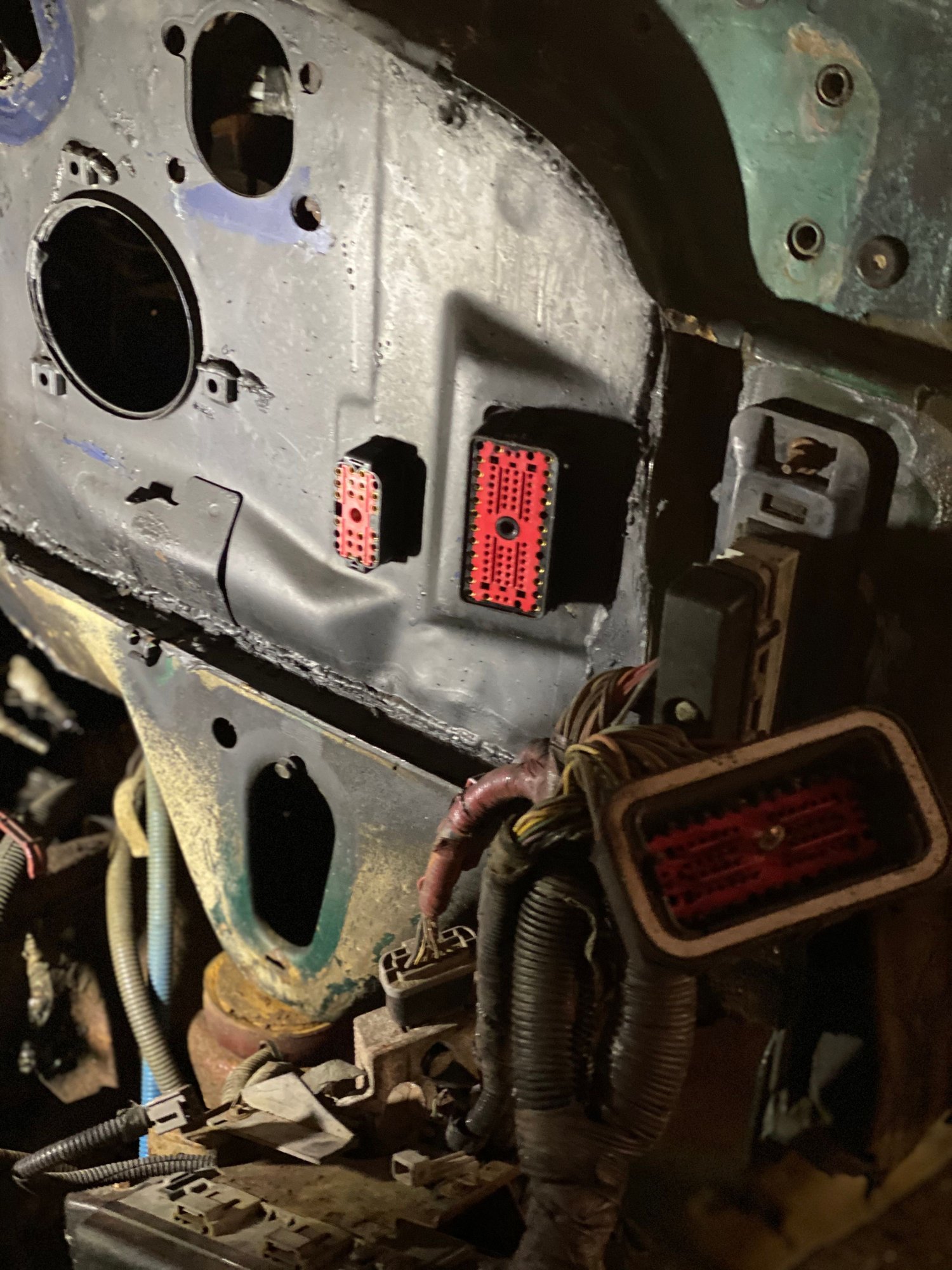

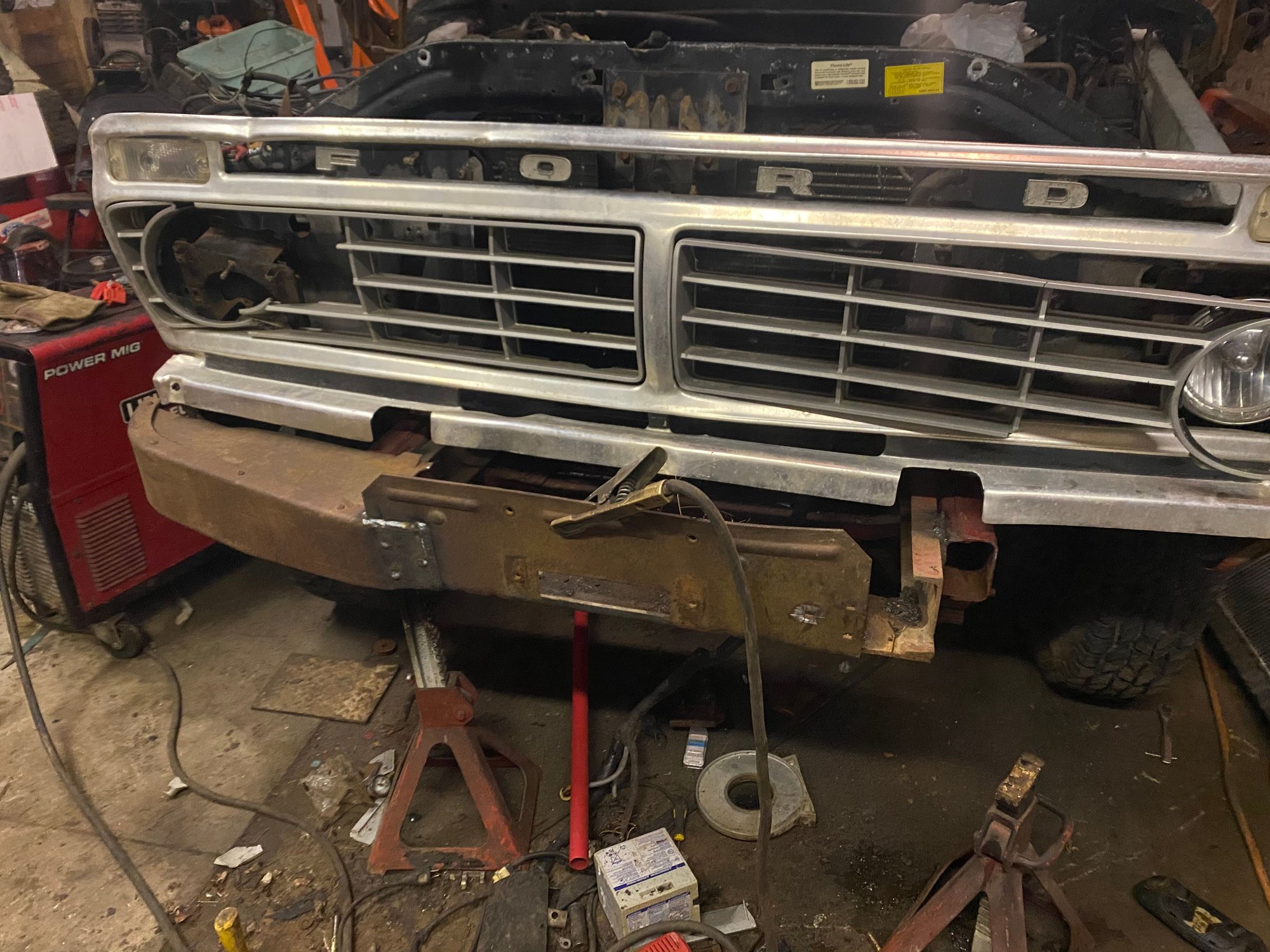

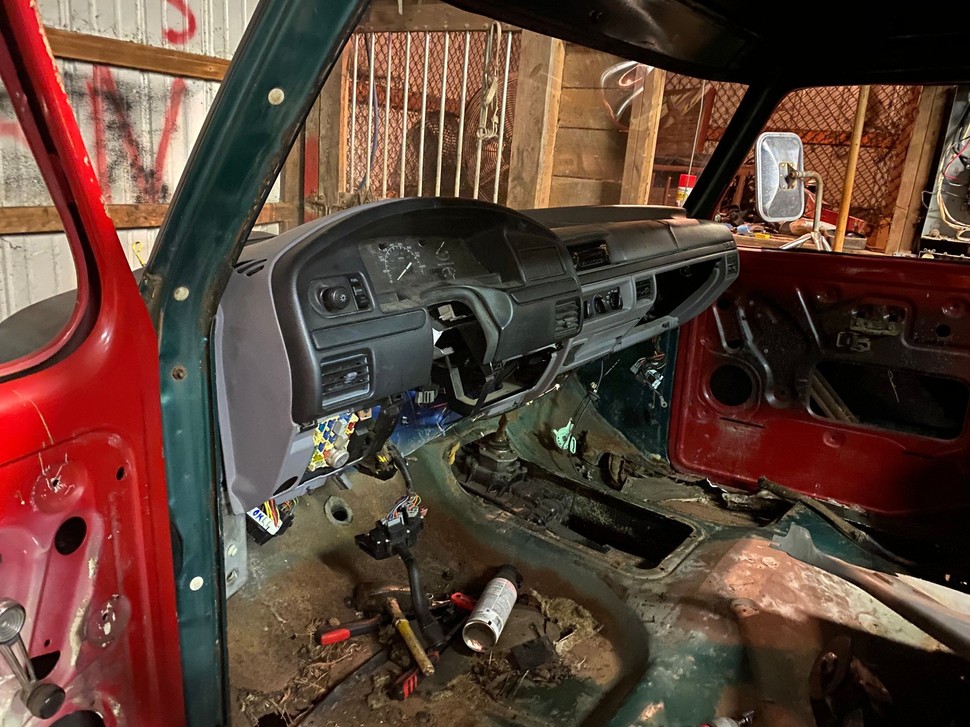

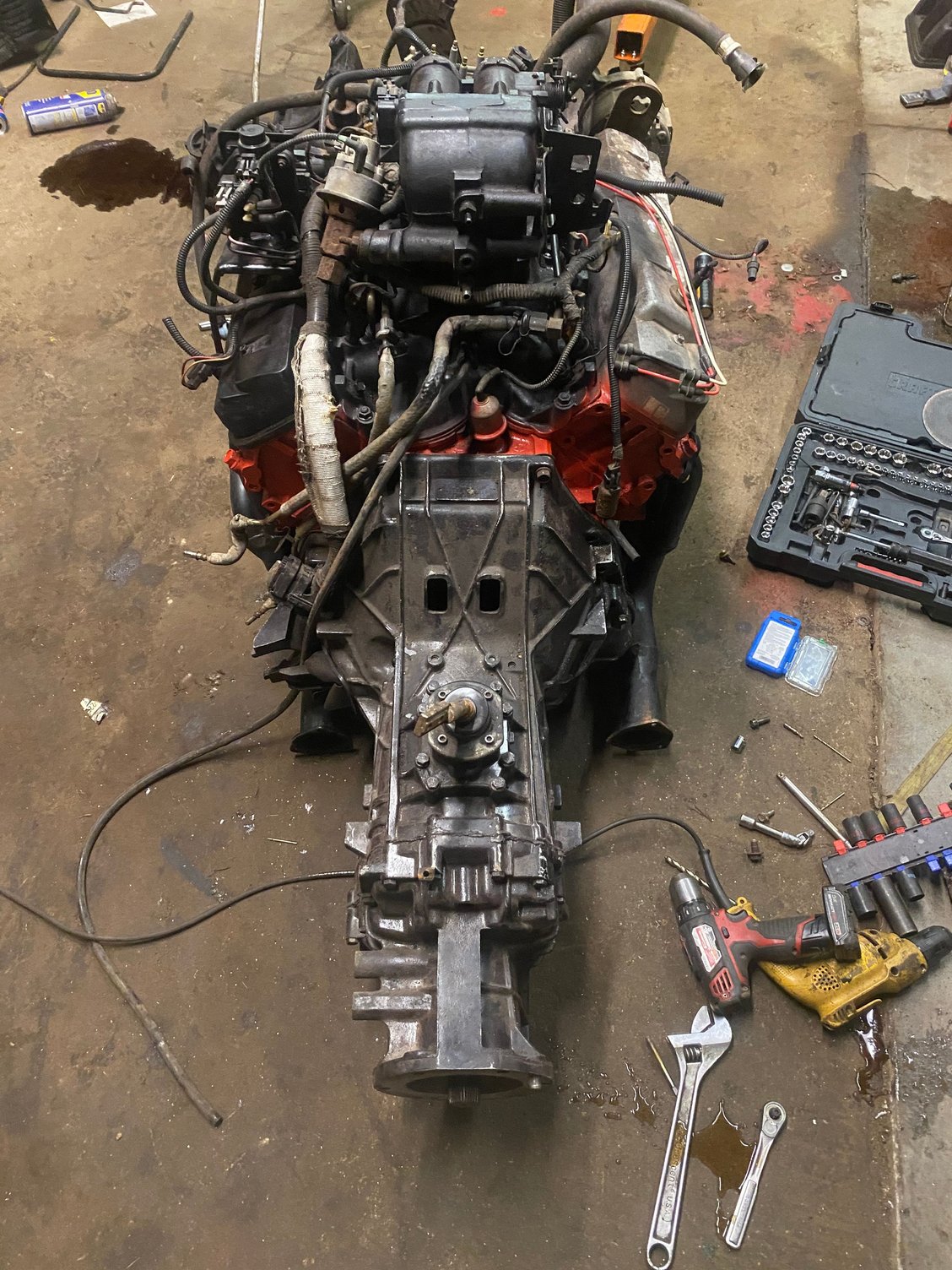

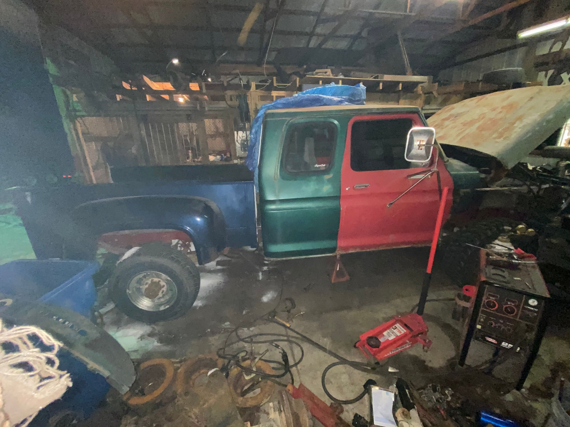

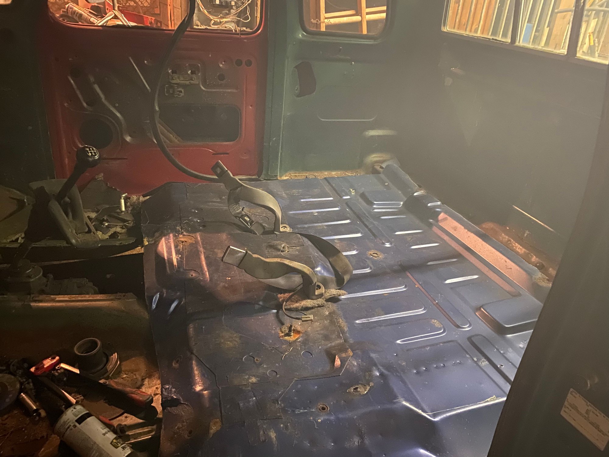

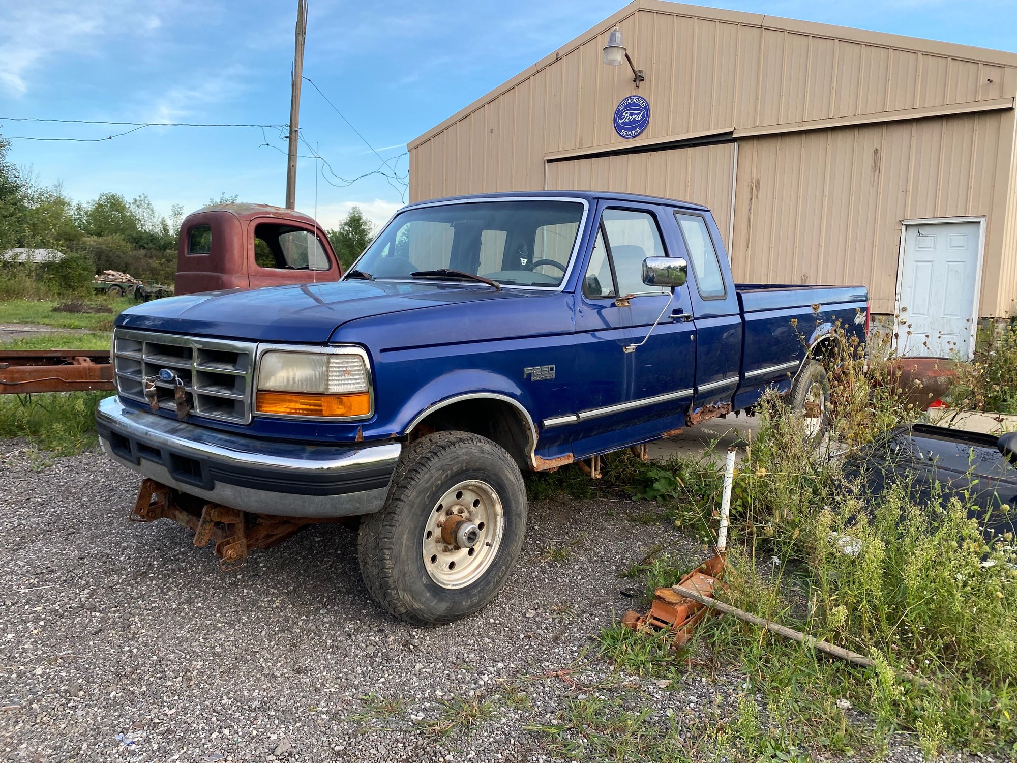

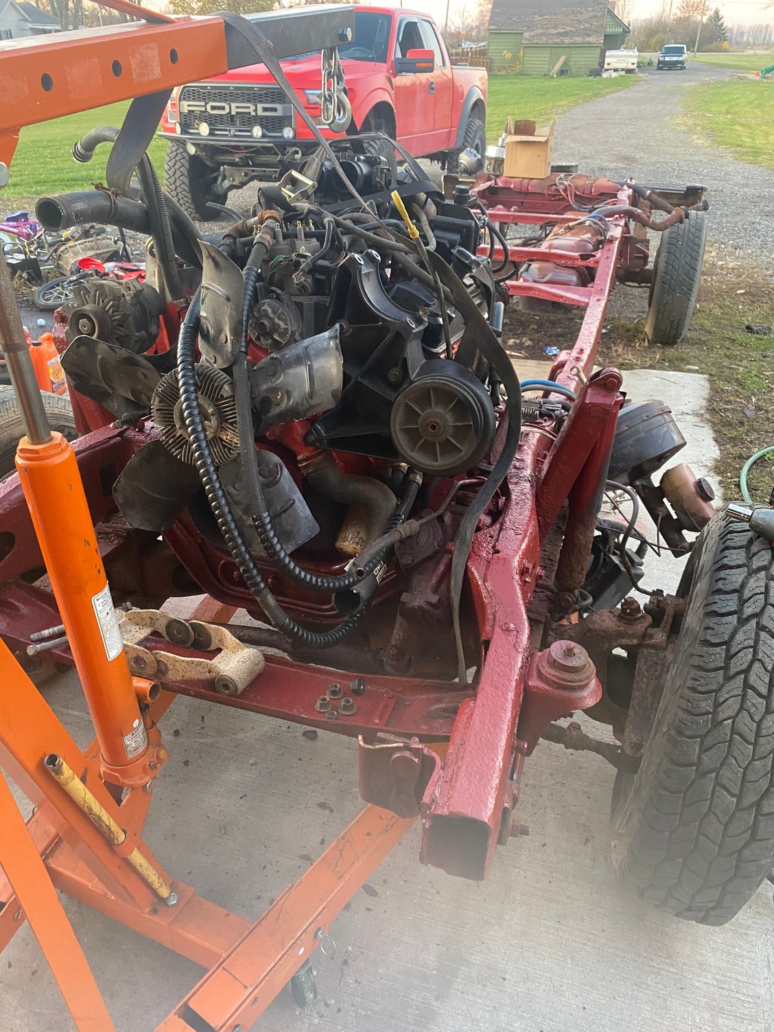

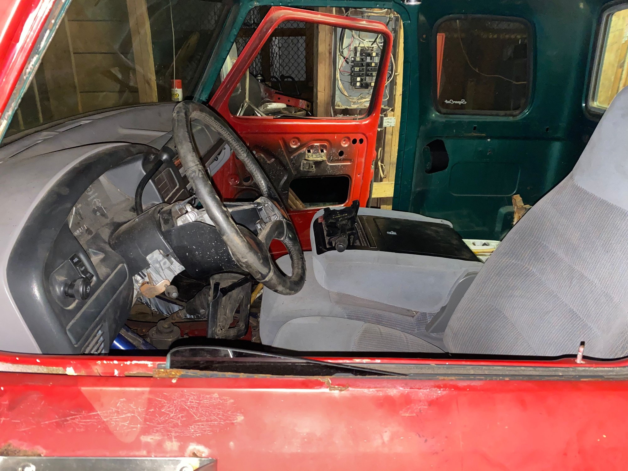

I picked this 1979 super cab up last year as just a cab and frame for $300. It’s clean for a michigan truck. A few months ago I picked up decent doors and and nice rust free fenders and core support for $150. Then I happened to come across this 97 f250 for free guy wanted it out of his yard and it came with a plow. It ran but trans was smoked. I brought it home stripped it down it has a 460 in it. I had a 25k mile 460 sitting in the corner for another project and picked up 2 zf5’s one with a fresh rebuild for $400 and sold the spare one for $500. I plan to go to a large single tank on the truck as I have a 32 gallon tank for one. I haven’t decided what I’m doing for a bed yet. The truck will be my daily/tow rig. I have collected a bunch more parts fir it. I cut the fire wall out of the 97 and I welded it in to the 79. Some one cut the fire wall all up on the 79 before I got it. Plus it makes using the dash etc from the 97 easier. I also am in the process of replacing all the floor. The front is done and dash is installed and I couldn’t resist throwing the seats in and seeing how she feels. I Picked up a old warn m8274 and bumper for $200 the bumper was tweaked but I managed to straighten it out. Also picked up a short flare side bed for $450. I also acquired a set of 2010 super duty axles with 4.10 gears for some work I did on a buddy’s truck.

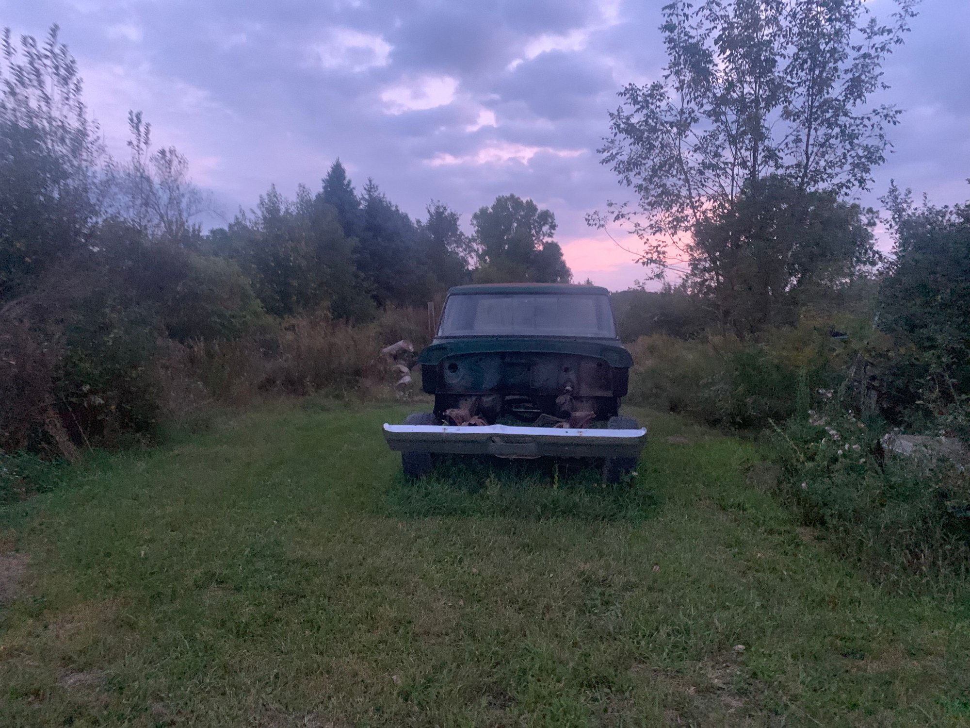

What I started with
The donor truck
The zf5
Engine and trans
Dropped the engine and trans in the frame
Dropped the cab on the new frame
Floors and fire wall progress
Started the interior and fire wall swap
Test fitting the 37
Hooking up the electrical

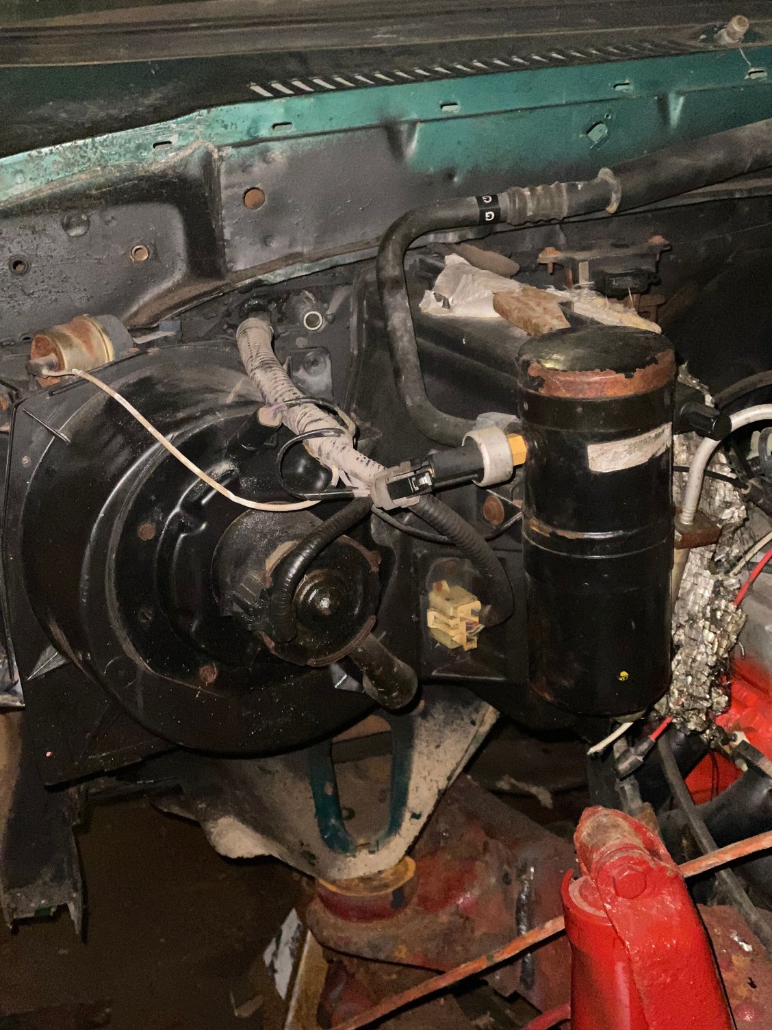

Hvac system
Fixing the bumper

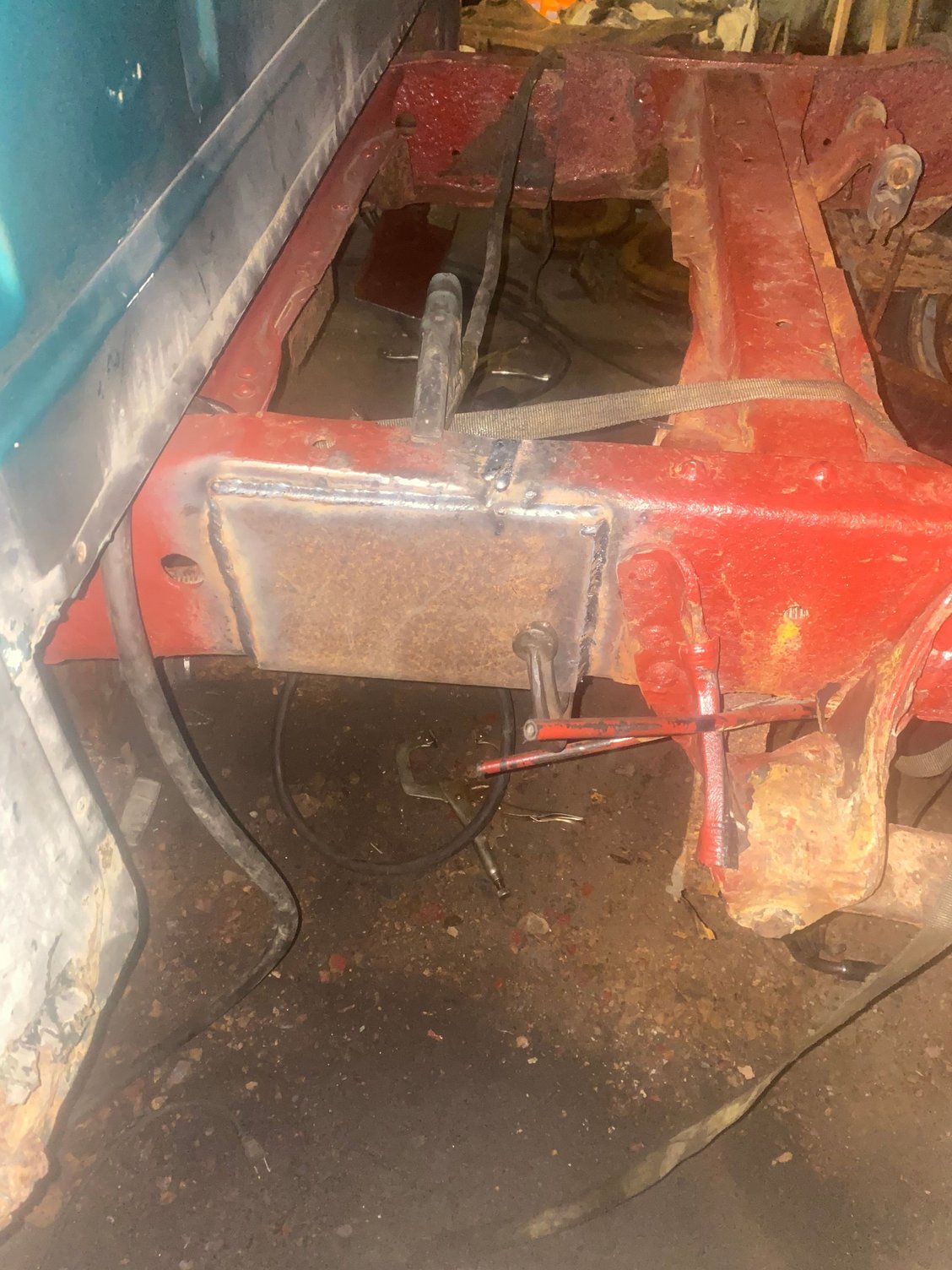

Little up date
Cut the frame Thursday 1-28-21
On Friday 1-29-21 I shortened the frame. L channel on the out side fish plated and plug welded on the inside and boxed
Test fit the box also
