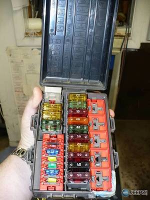

Hello RK, even chrome bumpers can be drilled for lights, just have to be patient and start with the smallest bit in yer kit, then progressively move up to the desired hole size. For the floor dimmer, I pulled the lower left under dash panel out and with my multi meter probed for the headlight wire from the switch it's a 10 gauge YBK (yellow/black wire coming out of the switch.
This wire I soldered into the existing Yellow/Black wire so that I could use the same circuit for other things (like the fog lights). I stripped about a half inch of insulation from the existing wire, spread out the strands a little bit then put my linking wire through the middle. I then soldered it and used a good gloopy portion of GB liquid electrical tape to protect it. This gave power to the Foot Dimmer central pin; The the low and high beams went to a relay box that I've added under the hood.
...and here's a close up of the dimmer connections;
