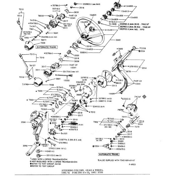

Here's the drawing of the steering column - automatic bits for lower end of column are in the lower right. Upper end is upper left. The column tube and shift lever tube are both different than 3-speed columns since there is only one shift lever sticking out the side of it. Number 7302 in the picture - lower right. If you want to keep the column shift I'd recommend looking for a C4 automatic steering column so you get all the parts you'll need. This would include the mounting point for the Neutral Safety Switch and it's lever blade so you can't start the truck in gear - unless you really want to be able to. Another option would be to change to a floor shifter. Probably easier.
