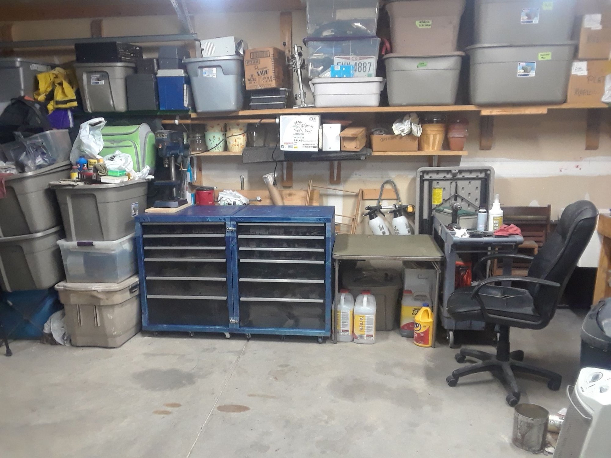

So I did some reorganizing and this happened...
Still need to make some labels for the drawers, but now I can work again

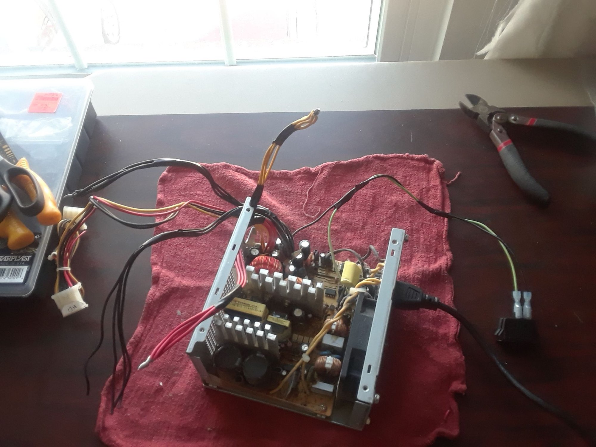

First official project on the new tool box happened yesterday, a new garage power supply. My old one, built in 2013, died 2 years ago. The new one is along the same lines, but with a few useful changes.
Used ATX power supply, with all of the excess wiring removed. Green wire to Ground turns it on.
Handy 110v connection light, acts like a "Wait To Start" light on a diesel. When it goes out, you can safely remove the cover.
Binding posts/jacks for 12v (top red), 5v (bottom red) and 2 grounds (black), plus 10A fuses on both outputs and a voltmeter tapped into the 12v line.
Yes, I did leave one IDE drive power connector still attached in case I need to wake up an old optical drive as found in the computer that donated this power supply. Also, there wasn't room to stuff a 12v shunt in the case to use the ammeter. Not a big deal though, 10A is plenty for most diagnostic purposes, testing out lights, etc.
Total Cost: $0 because everything is recycled parts. And it fits in the tool box, right next to the battery charger.

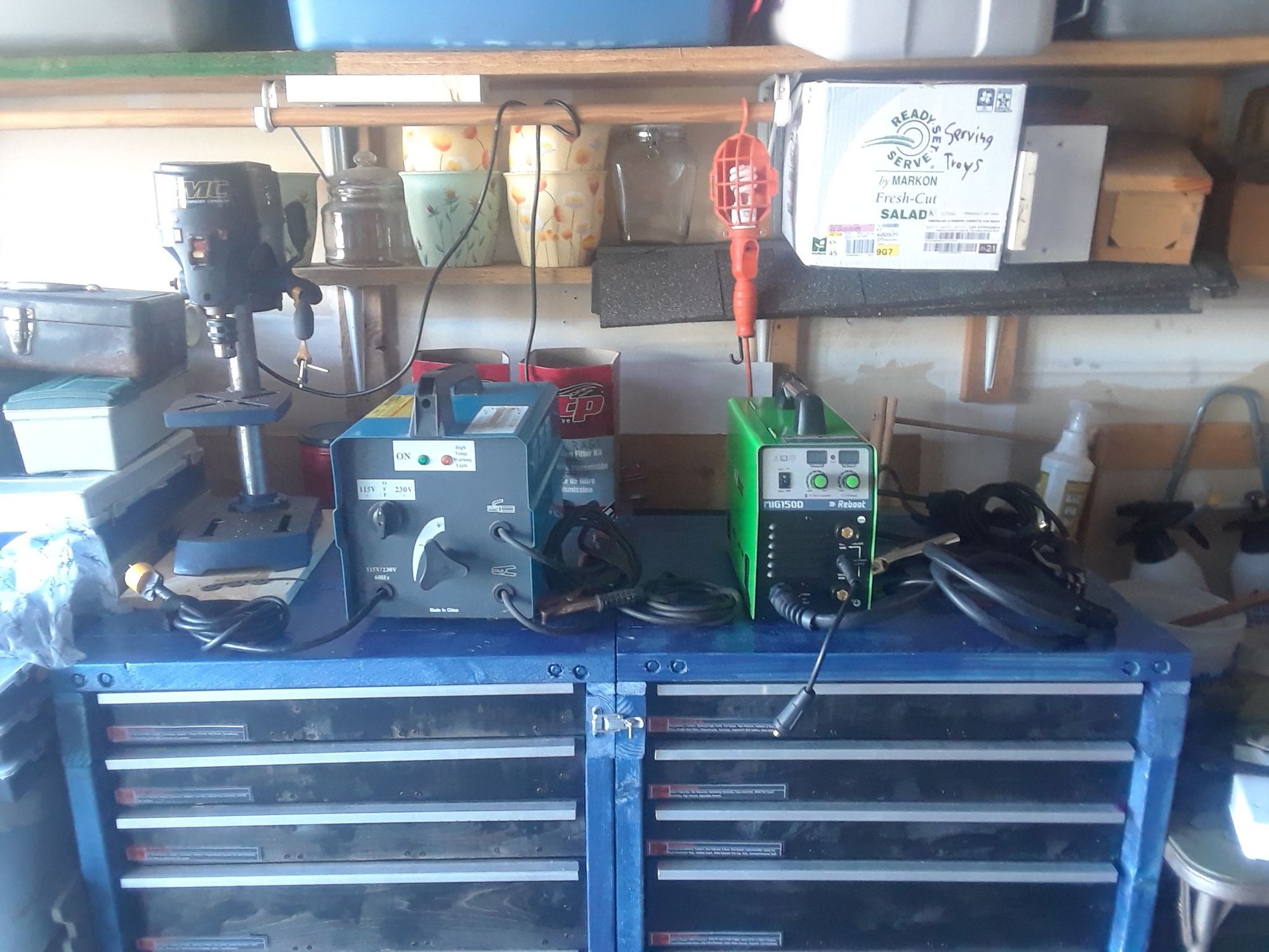

Mig welder: Birthday present for me
Old meets new

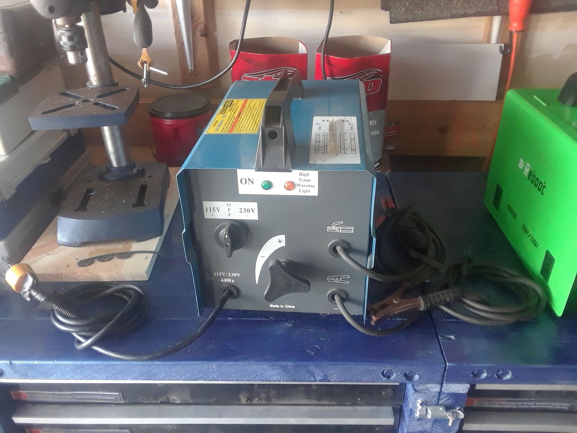

2010 Harbor Freight 110/220v 120A arc welder. Discontinued right after I bought it.

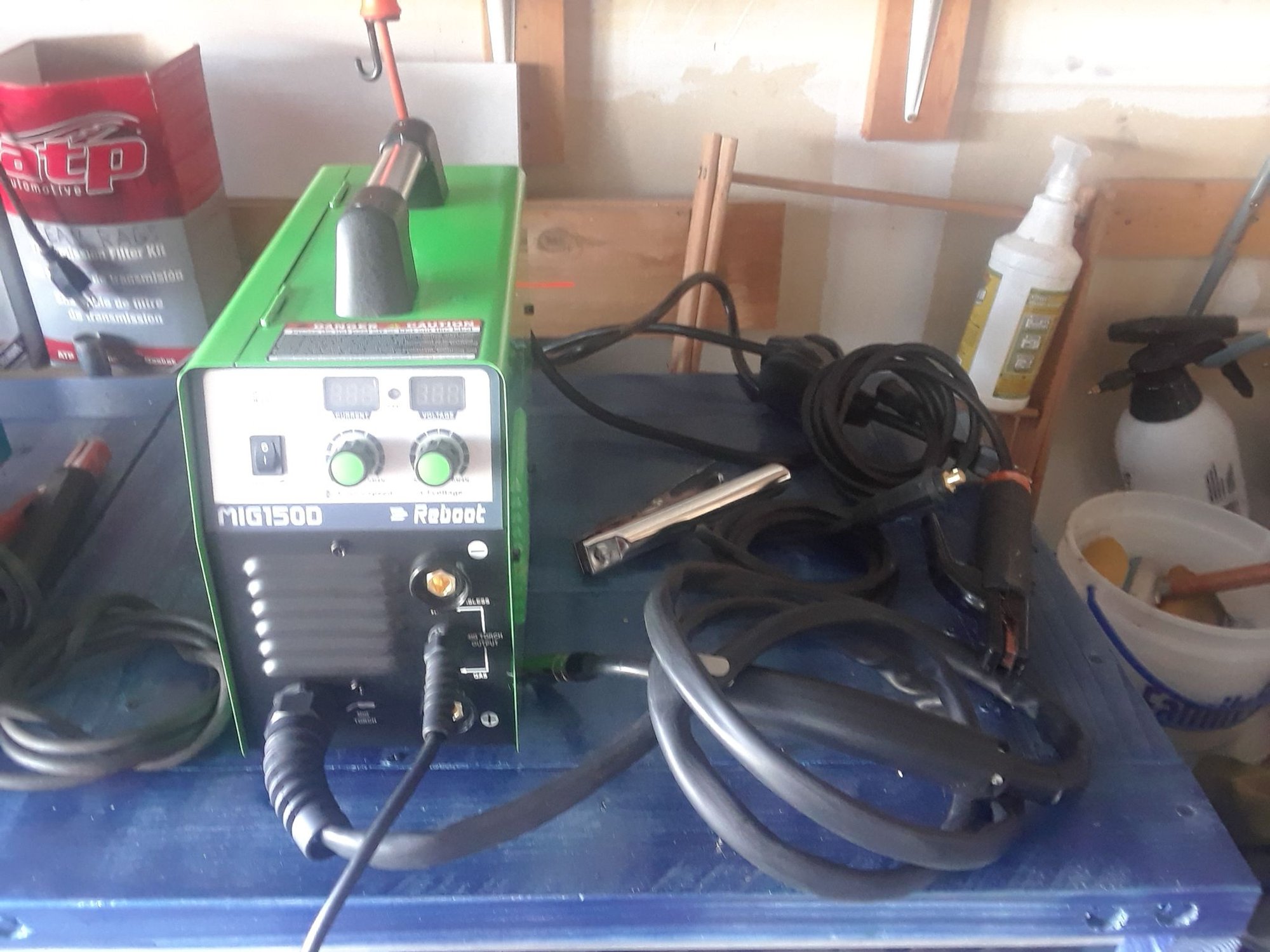

New kid on the block. 110/220v 150A Mig/Arc welder
