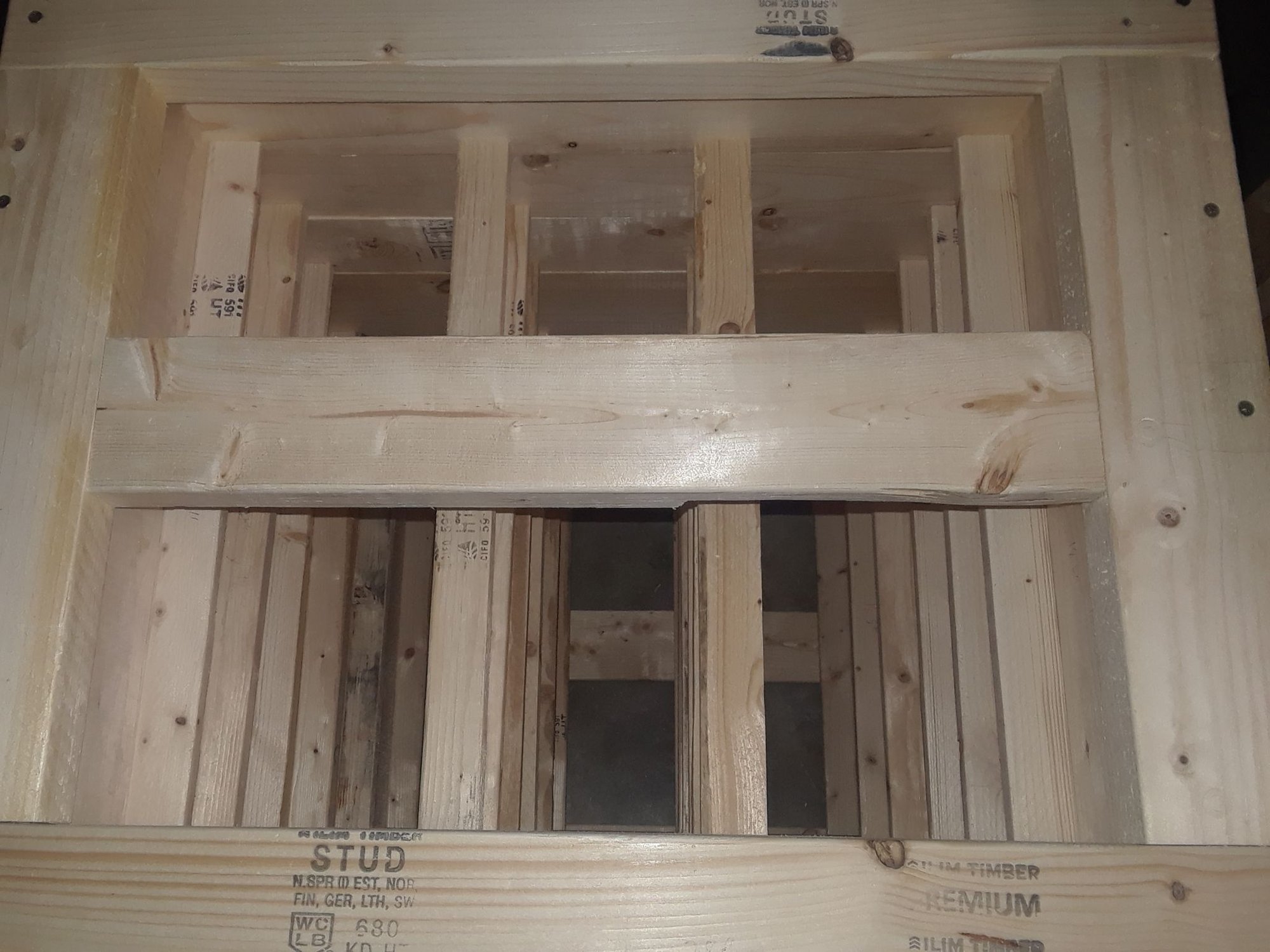

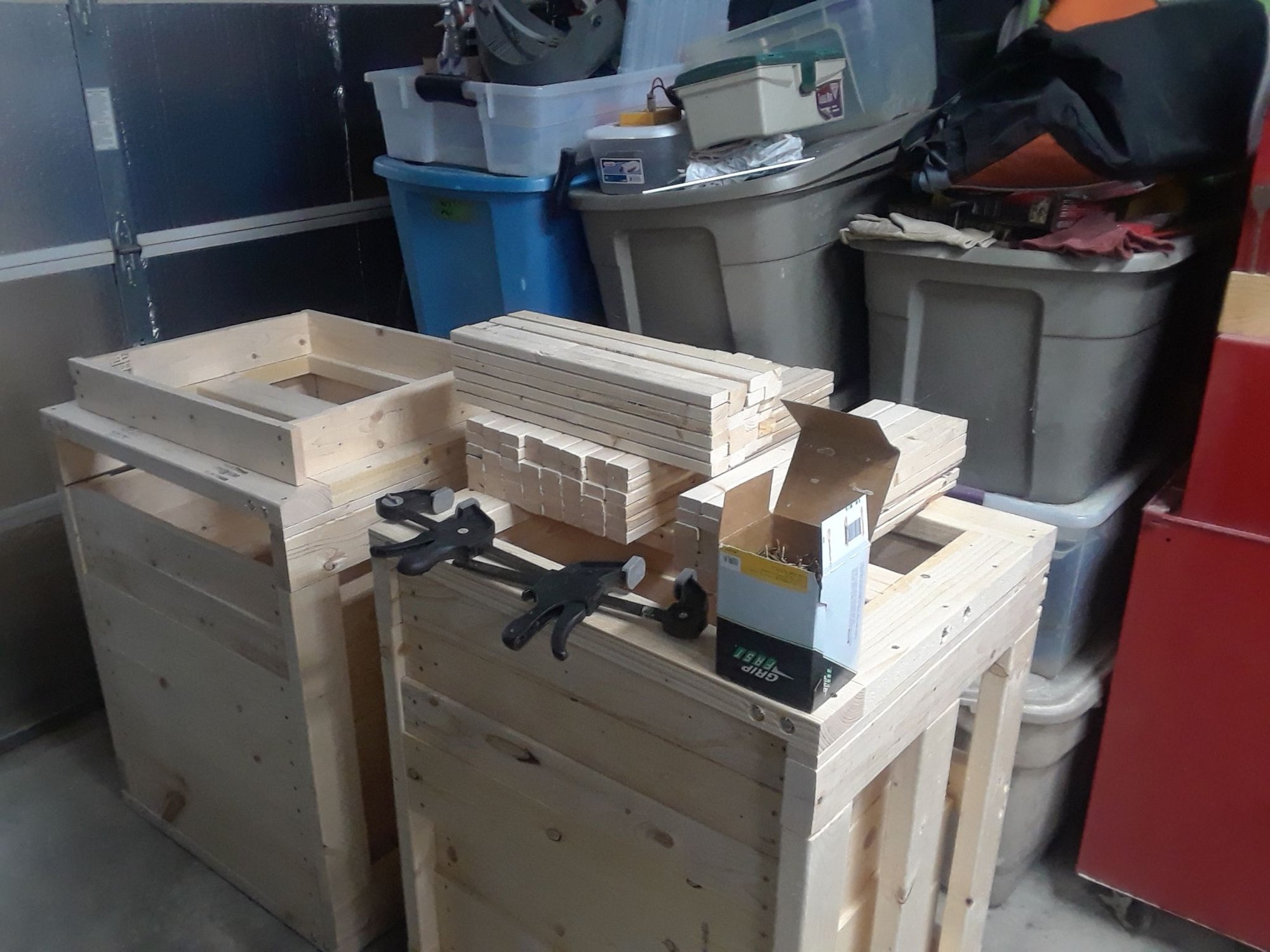

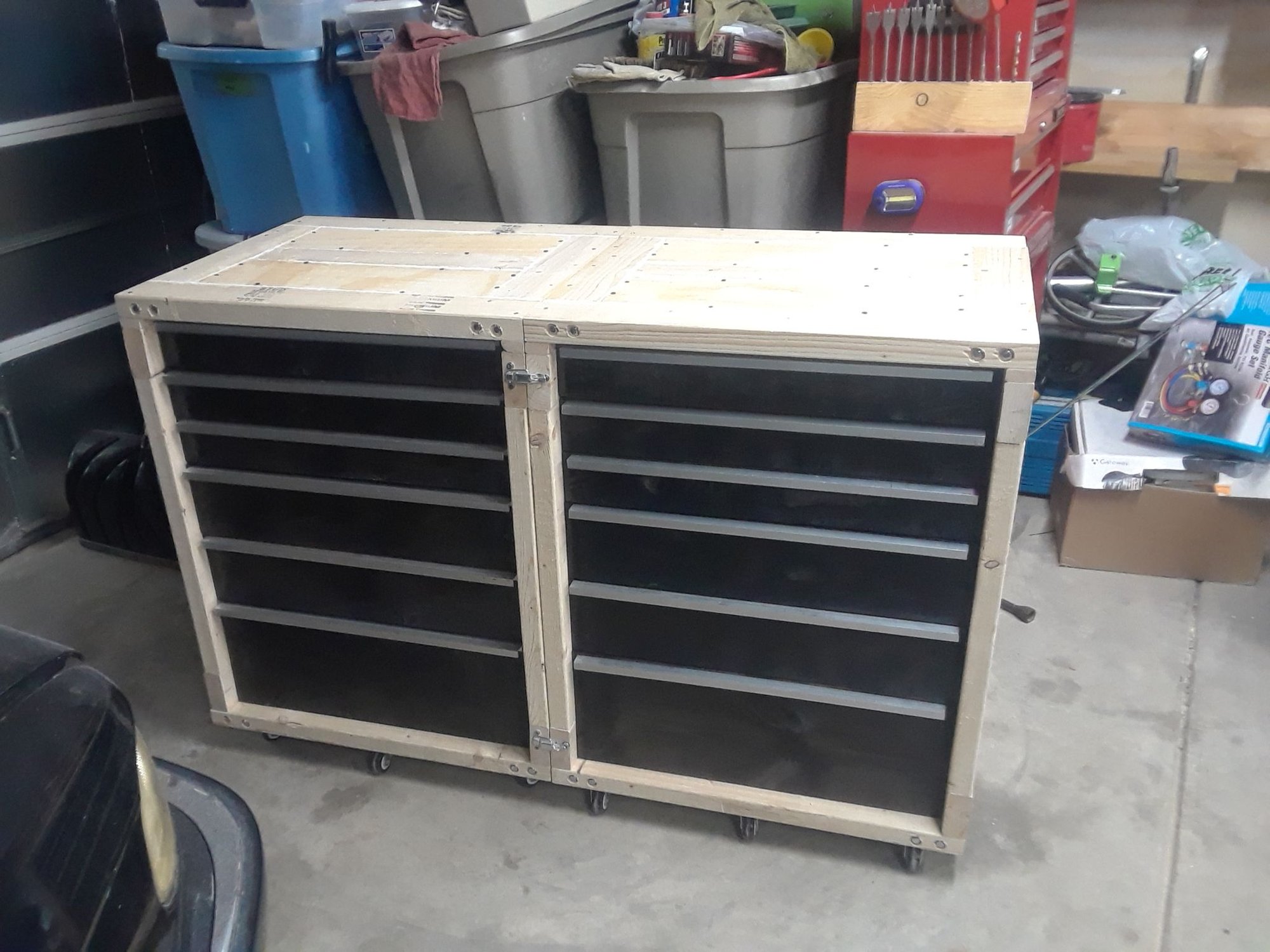

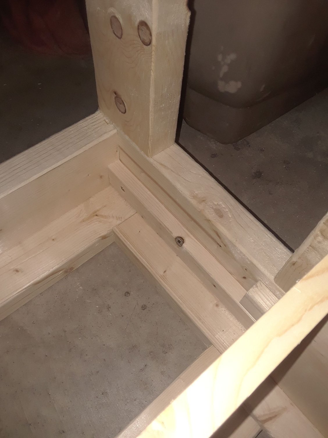

Anyway, I've been busy. Pulled a late night last night and got all of the reinforcements and slide rails put in. 96 pieces.
Spacing Mockup
Rear clearance mockup. Block is where the end of the rails will be
48 rails and 24 reinforcements. Crap, I need 24 more reinforcements.
48 rails and 48 reinforcements. Let the Garage Orgy begin. Lots of Drilling and Screwing gonna happen here
Reinforcements in.
Putting in the first slide rails.
And at the back.
2nd drawer test fit. Perfect 1/16" gap, exactly as planned. I used some 1.5mm thick offset washers from an ebay LS1 shifter to space everything evenly.
Halfway done. One cabinet down, one to go. Top drawer rails took some creative thinking to clamp into place and get the spacing right.
All done now. Finished right at 3am.
The Money Shot. 4 reinforcements and 4 rails per drawer. 30 Screws per drawer, 360 total.
Now we're down to plywood, wheels and paint. But first, a day off to rest, recover and recharge.

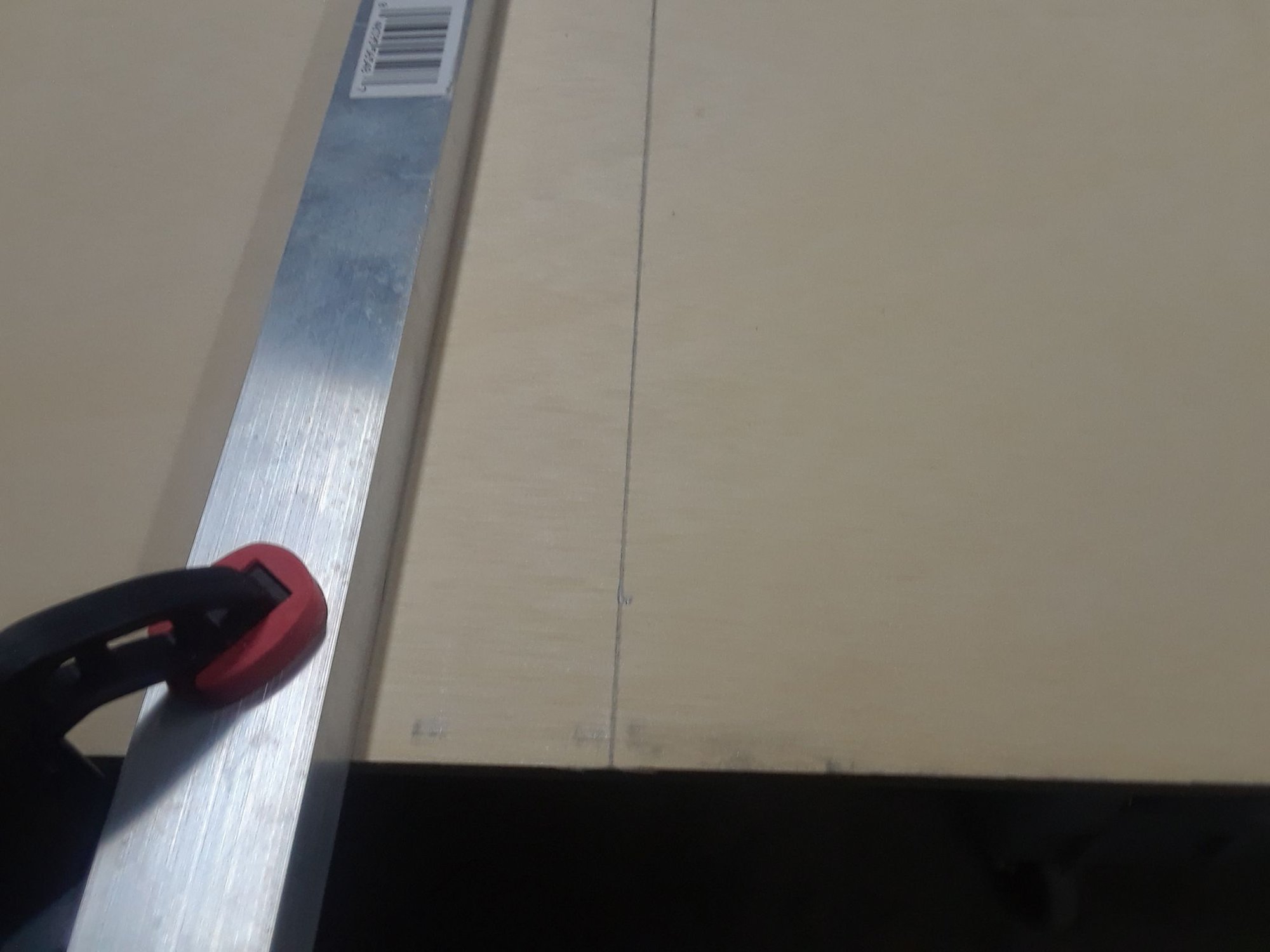

Perfectly straight line, thanks to an 8ft long piece of C-Channel

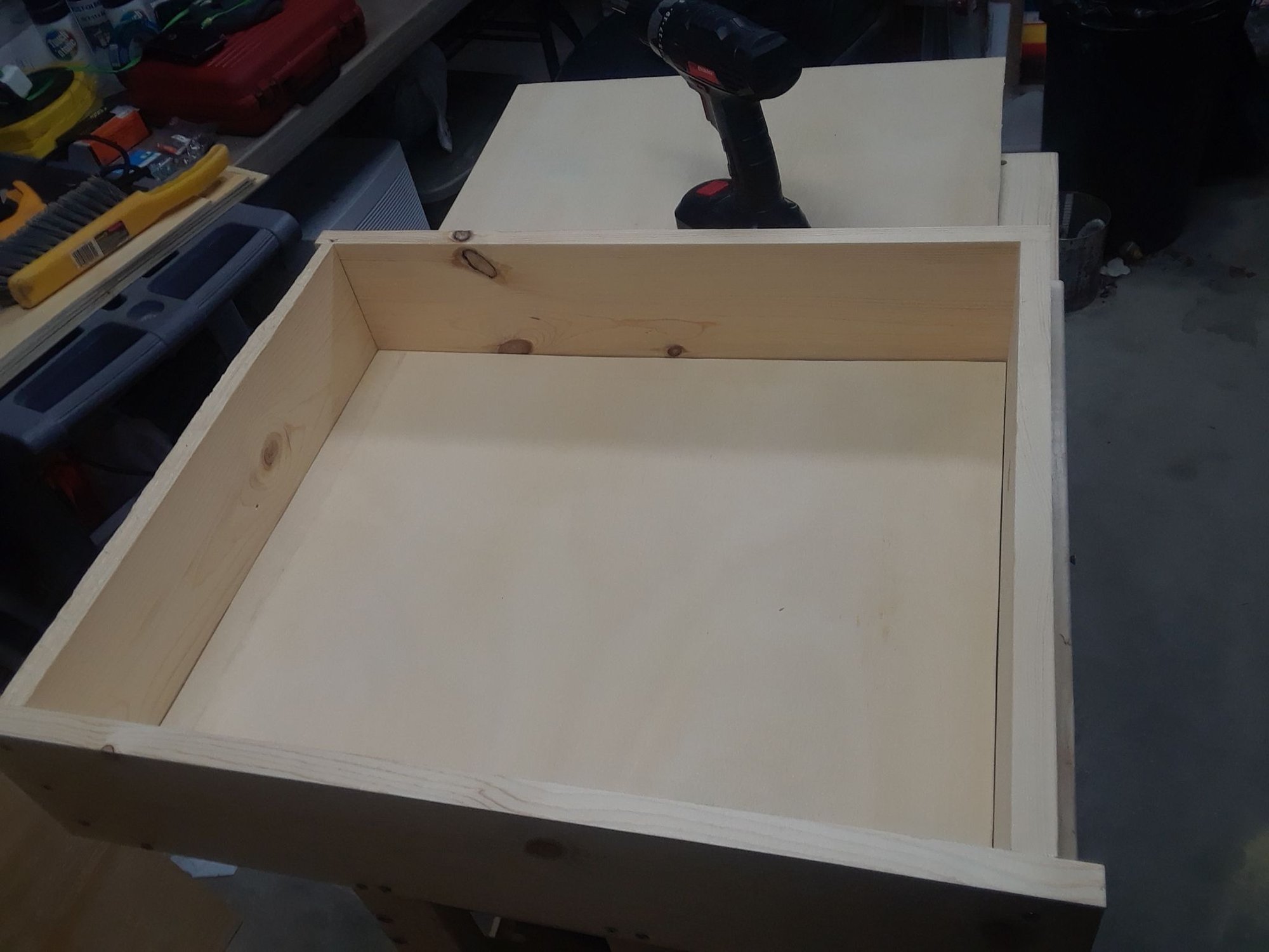

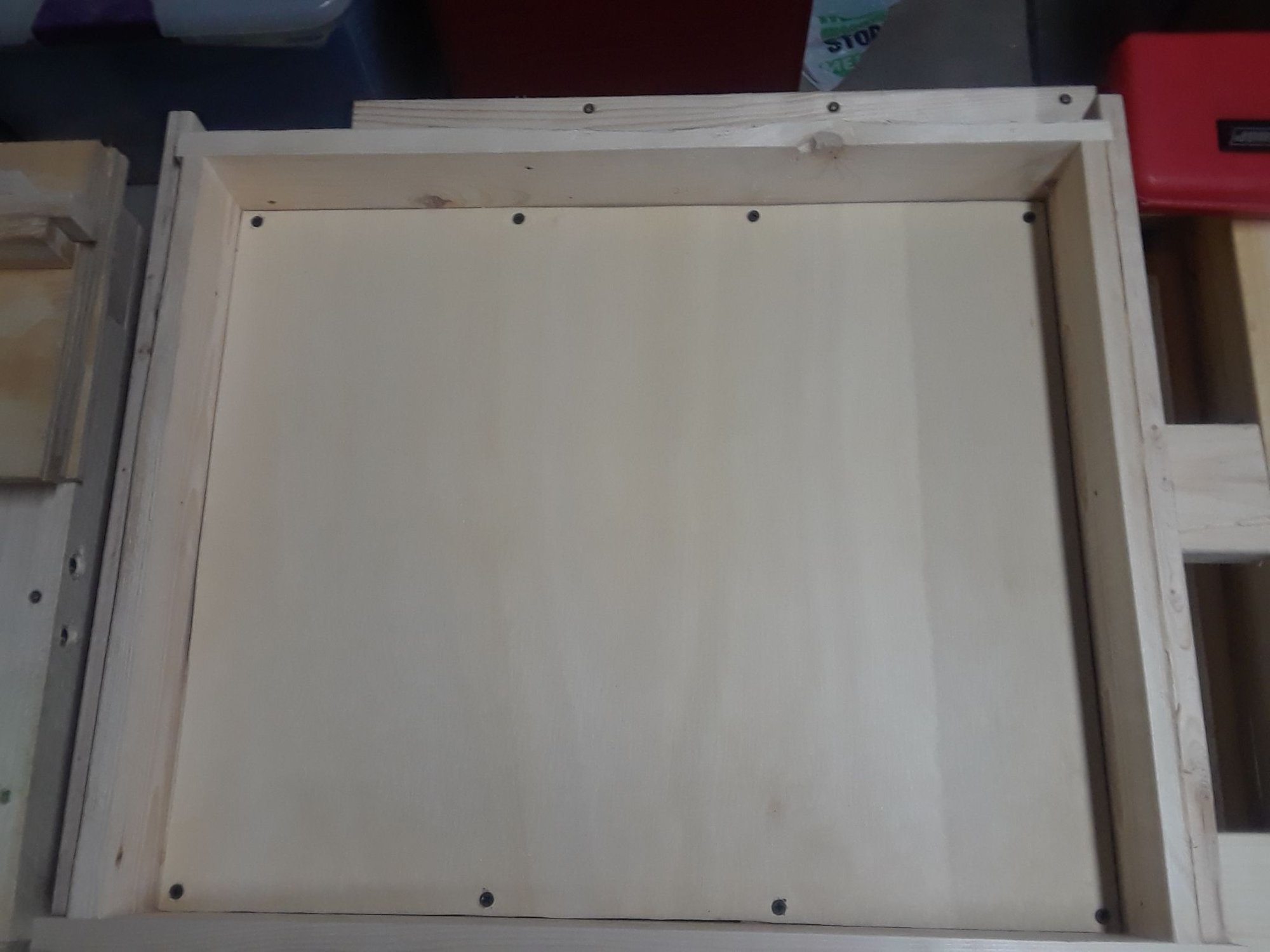

Drawer bottoms attached with 3/4" screws

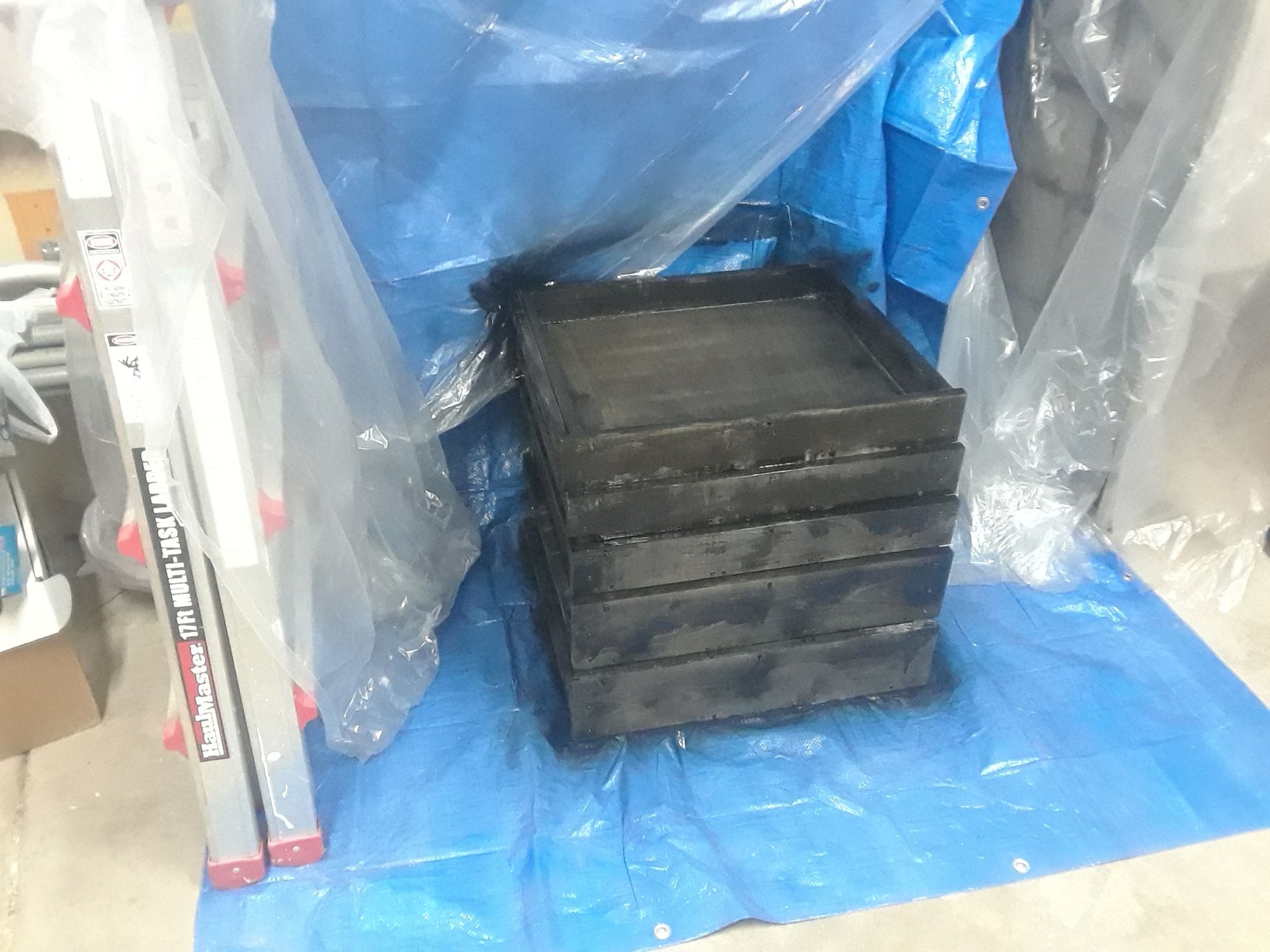

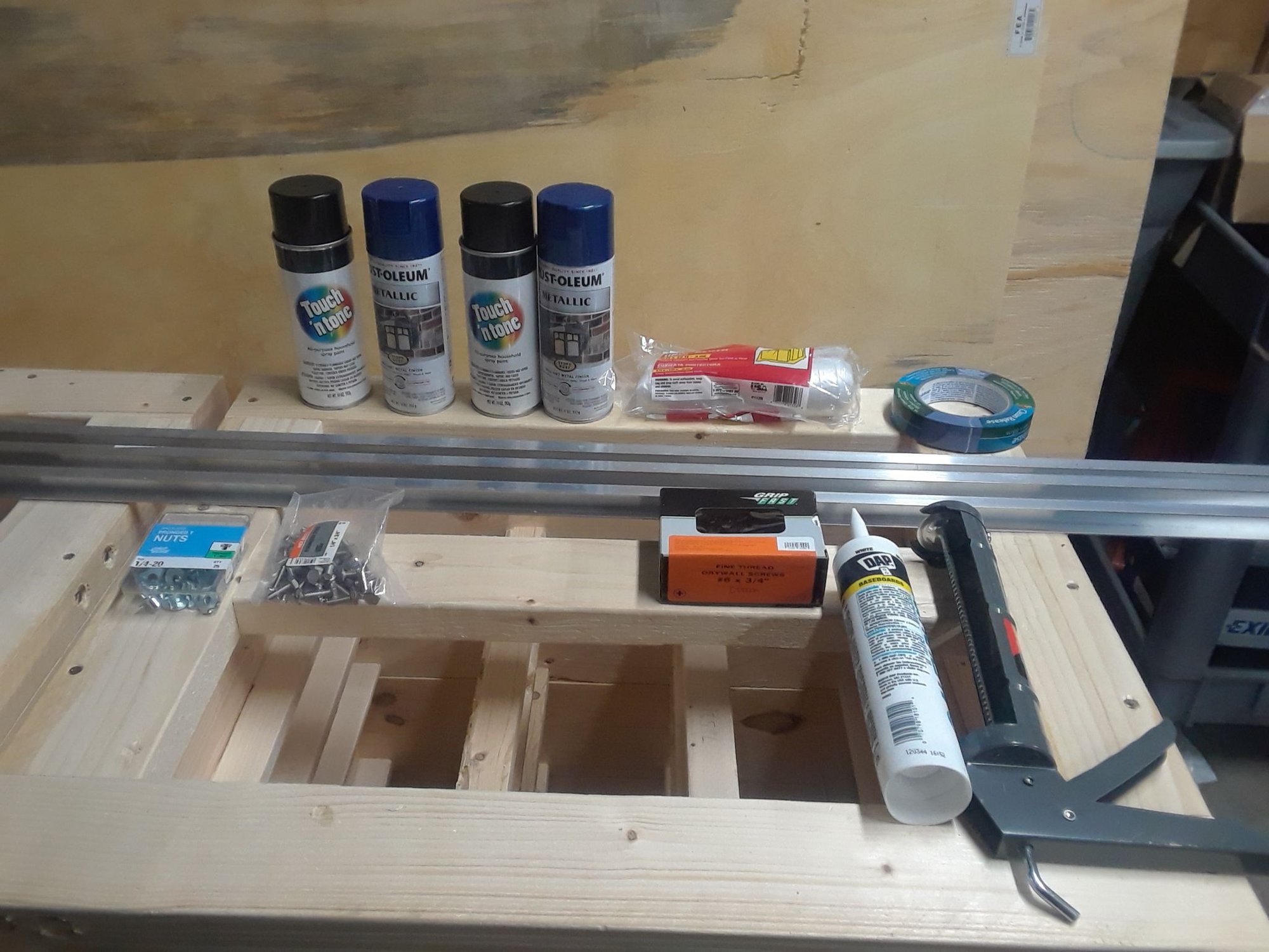

Painting has begun now. Reorganized a bit to set up a temporary paint booth using a tarp and 2 plastic drop cloths in the corner of the garage
Supplies
So I found a metal flake color really close to Ford Emblem blue...
Temporary paint booth
First coat, will need a second in a few hours to make it look pretty.

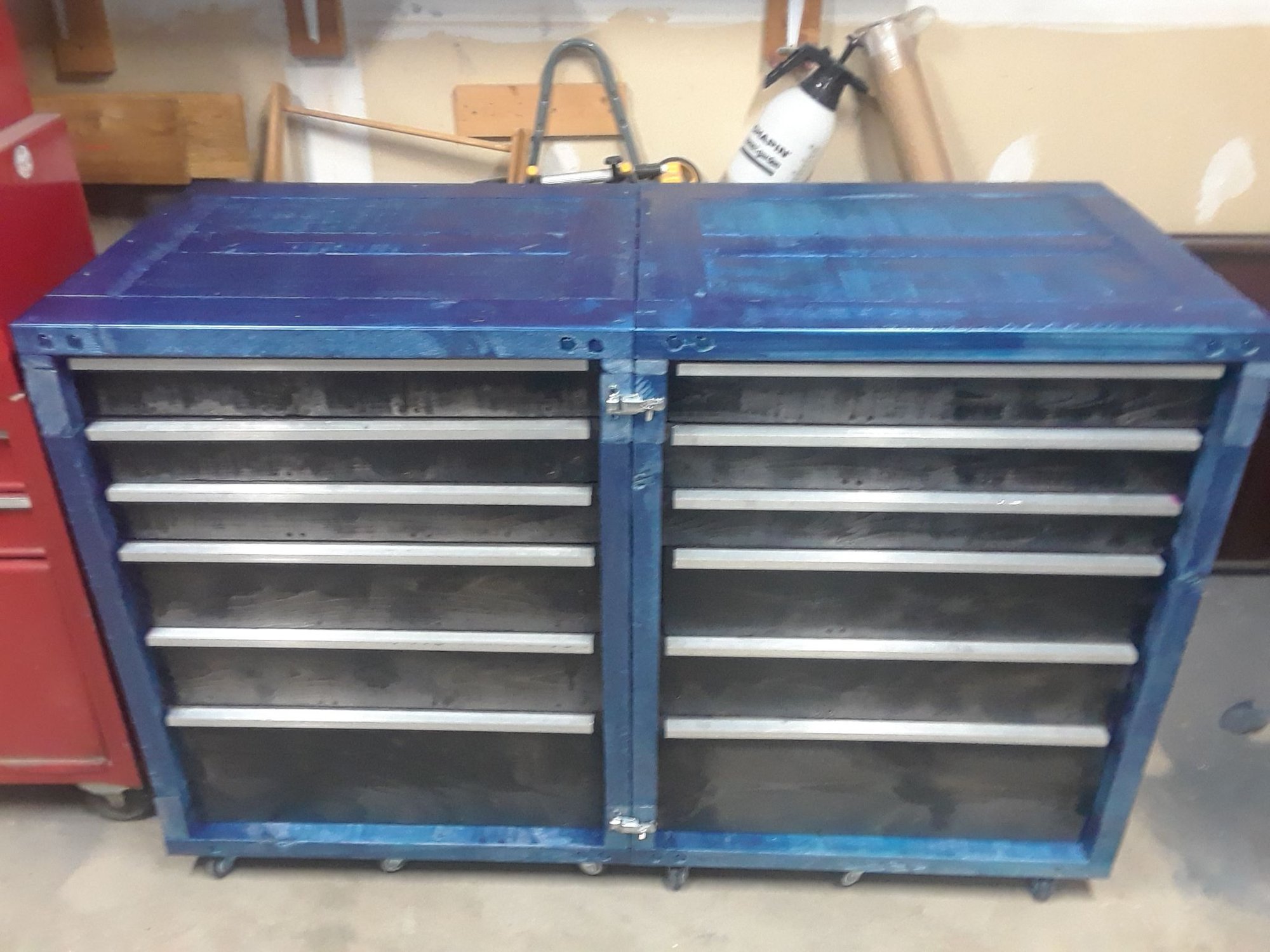

Gloss Black drawers, Metal Flake Blue cabinets and Bare Aluminum handles. Told y'all I had something special in mind

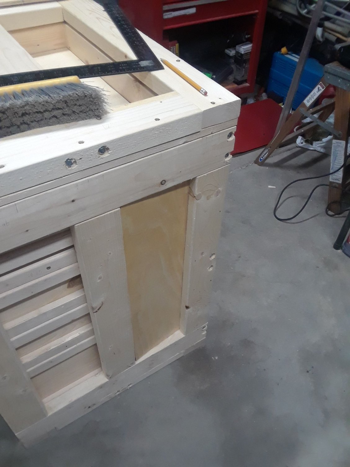

While the paint was drying on the first drawer today, I did a few other things...

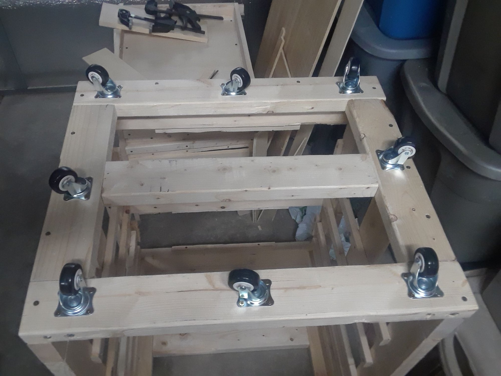

Got the side and rear panel flanges in place, made them from leftover 1x2s ripped lengthwise with a jigsaw.
8 per cabinet, 90lb capacity for each one. I wheely like this
One of the 2x4s on the right cabinet's base was apparently slightly bowed by ~2mm. Some washers on one corner and the adjacent front and side wheels fixed that. Now everything sits flush, flat and even.
Still have to tackle the top, but that's tomorrow's business. Today turned it into a usable piece of equipment.

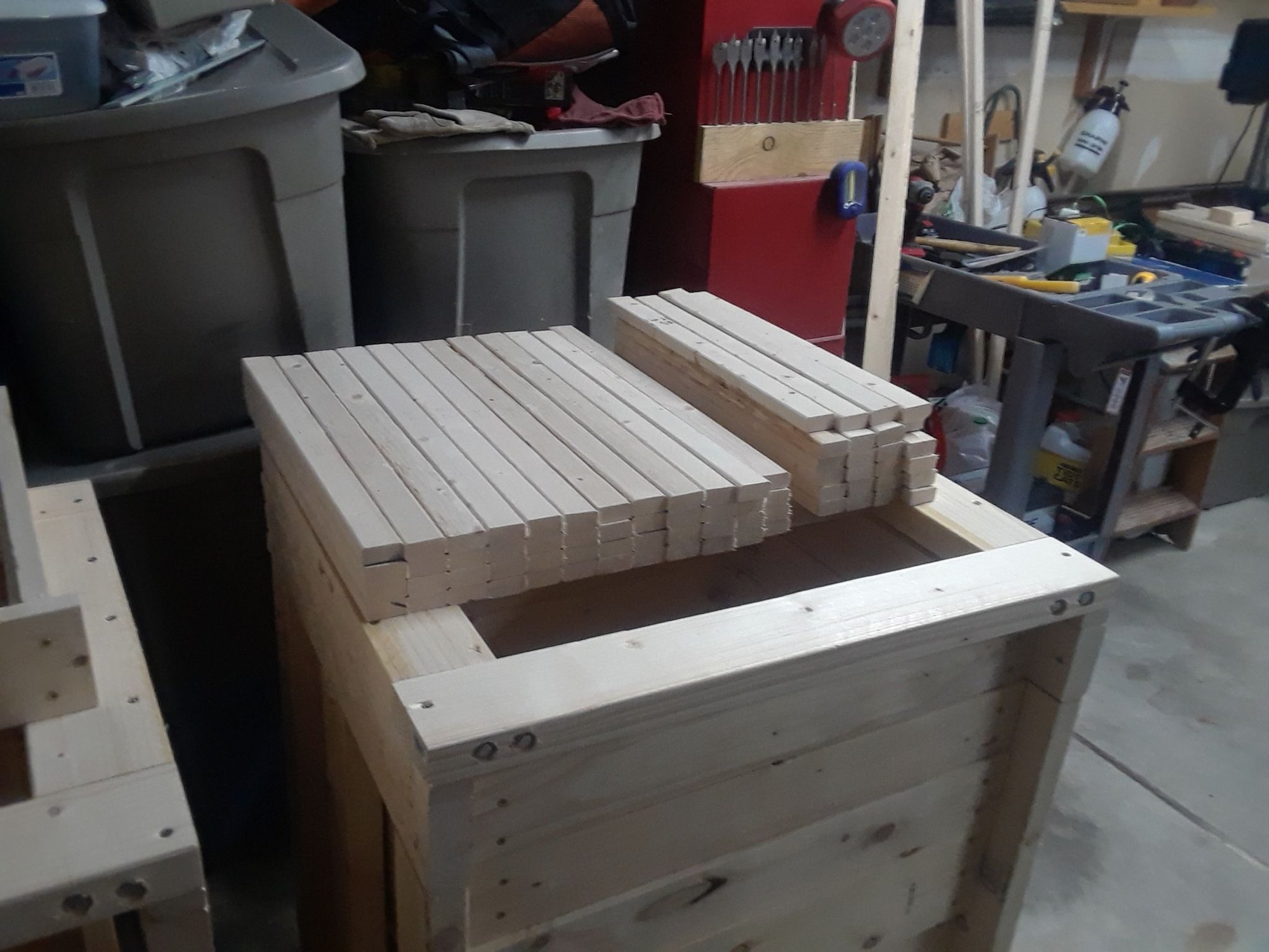

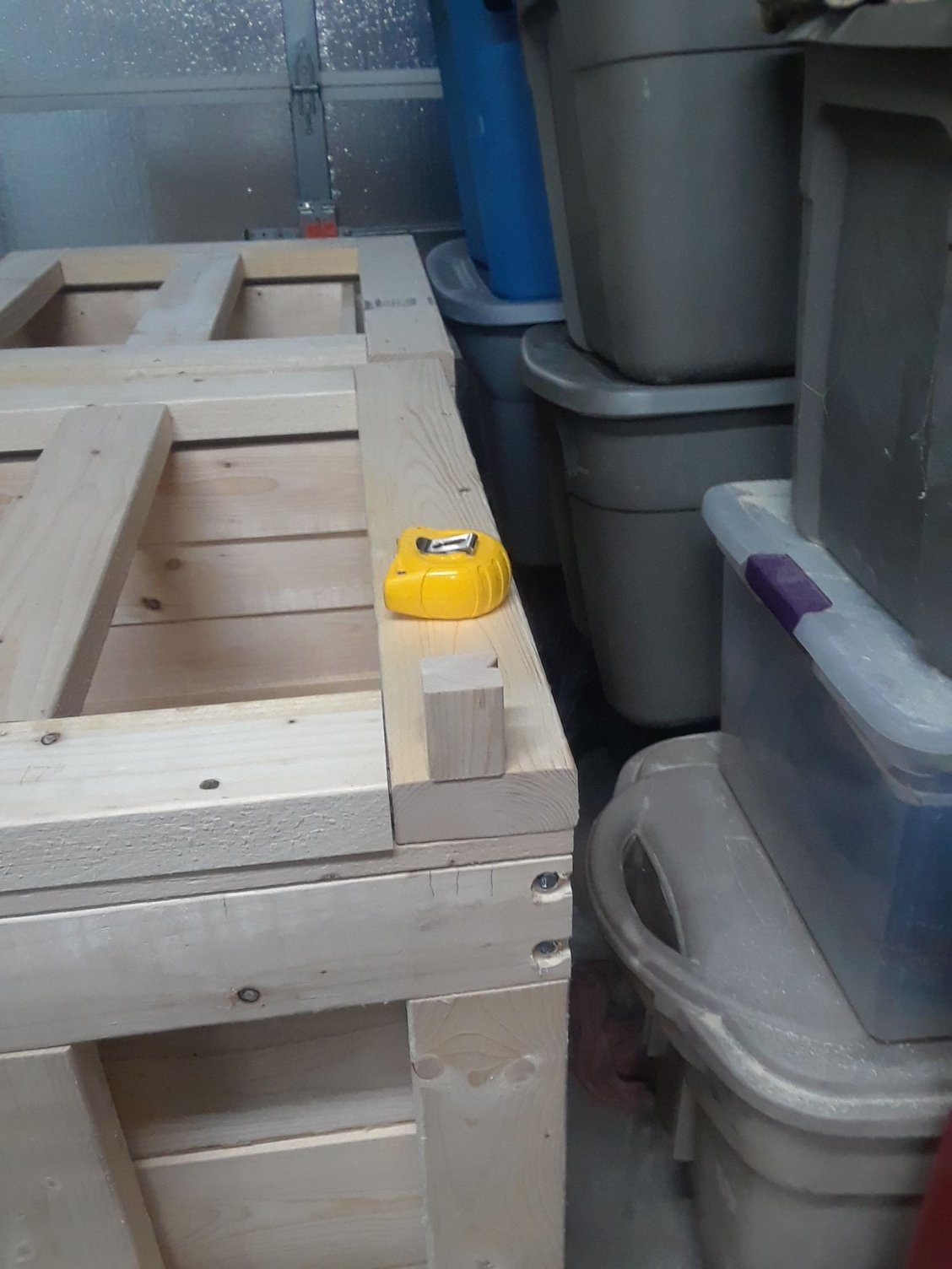

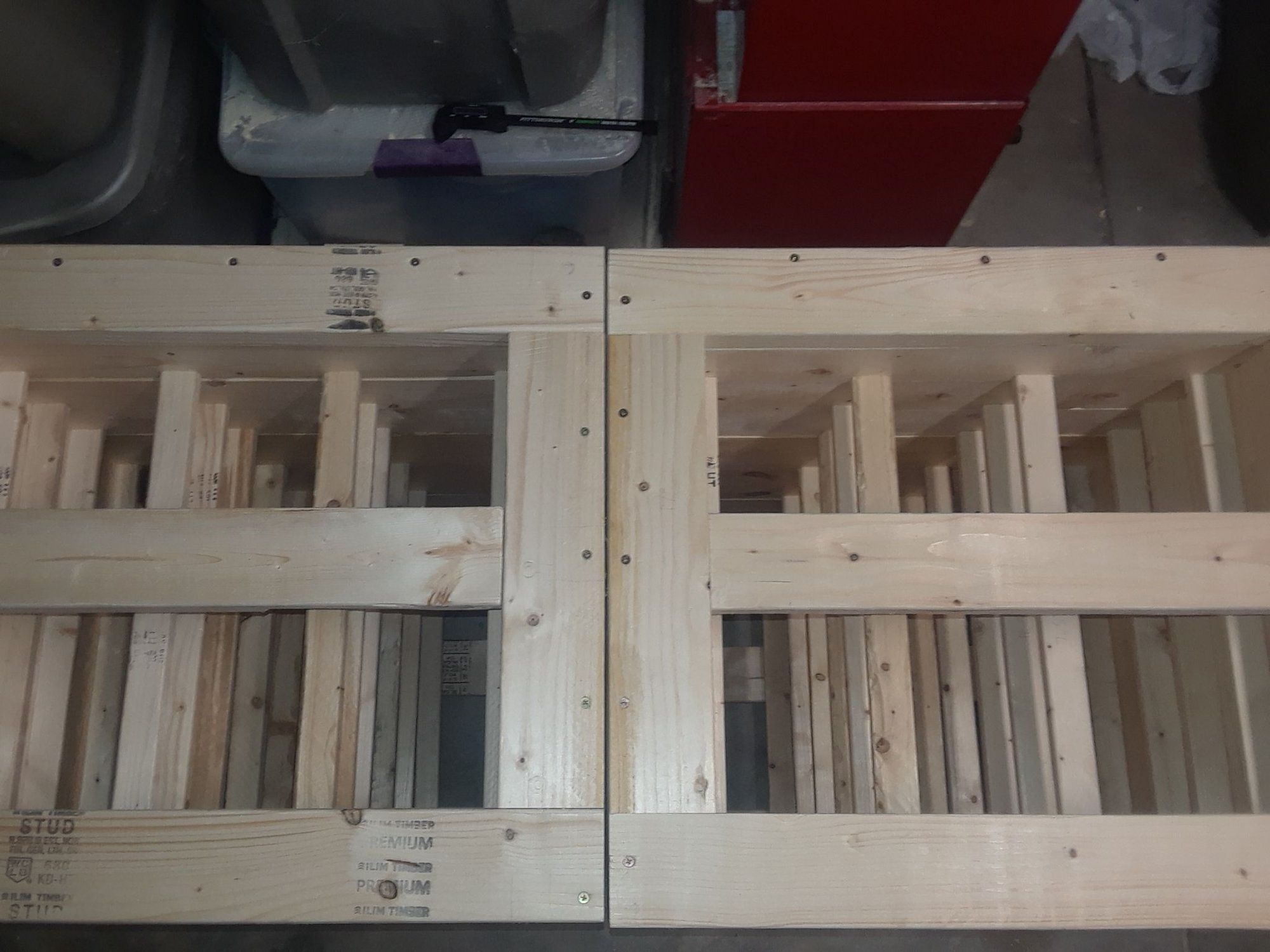

Thank you. I wanted to be certain that it would be a LONG time before I could outgrow this. After taking my uncle to the hospital this morning, I made some progress.

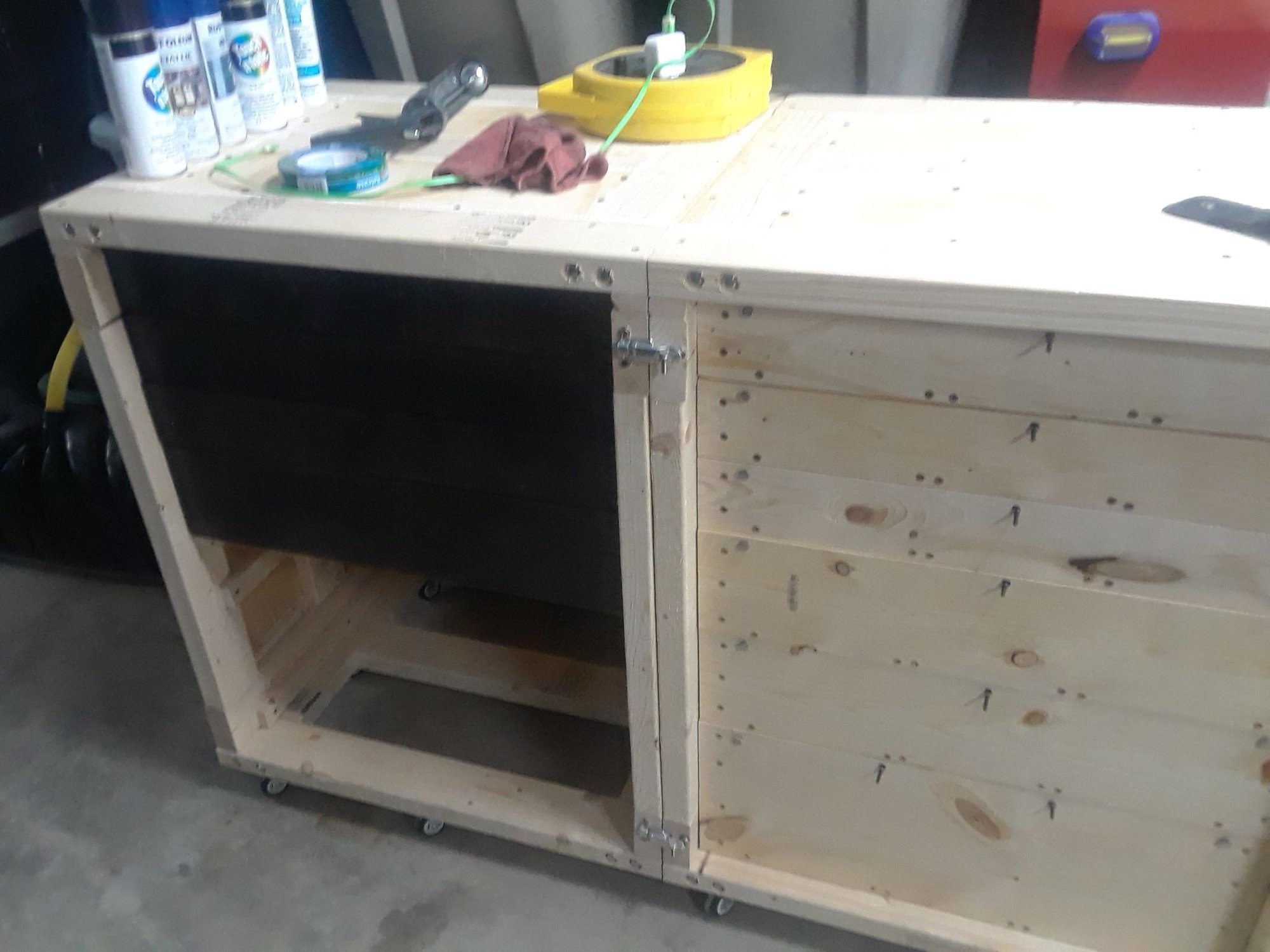

Front latch mechanisms.
Rear latch mechanisms.

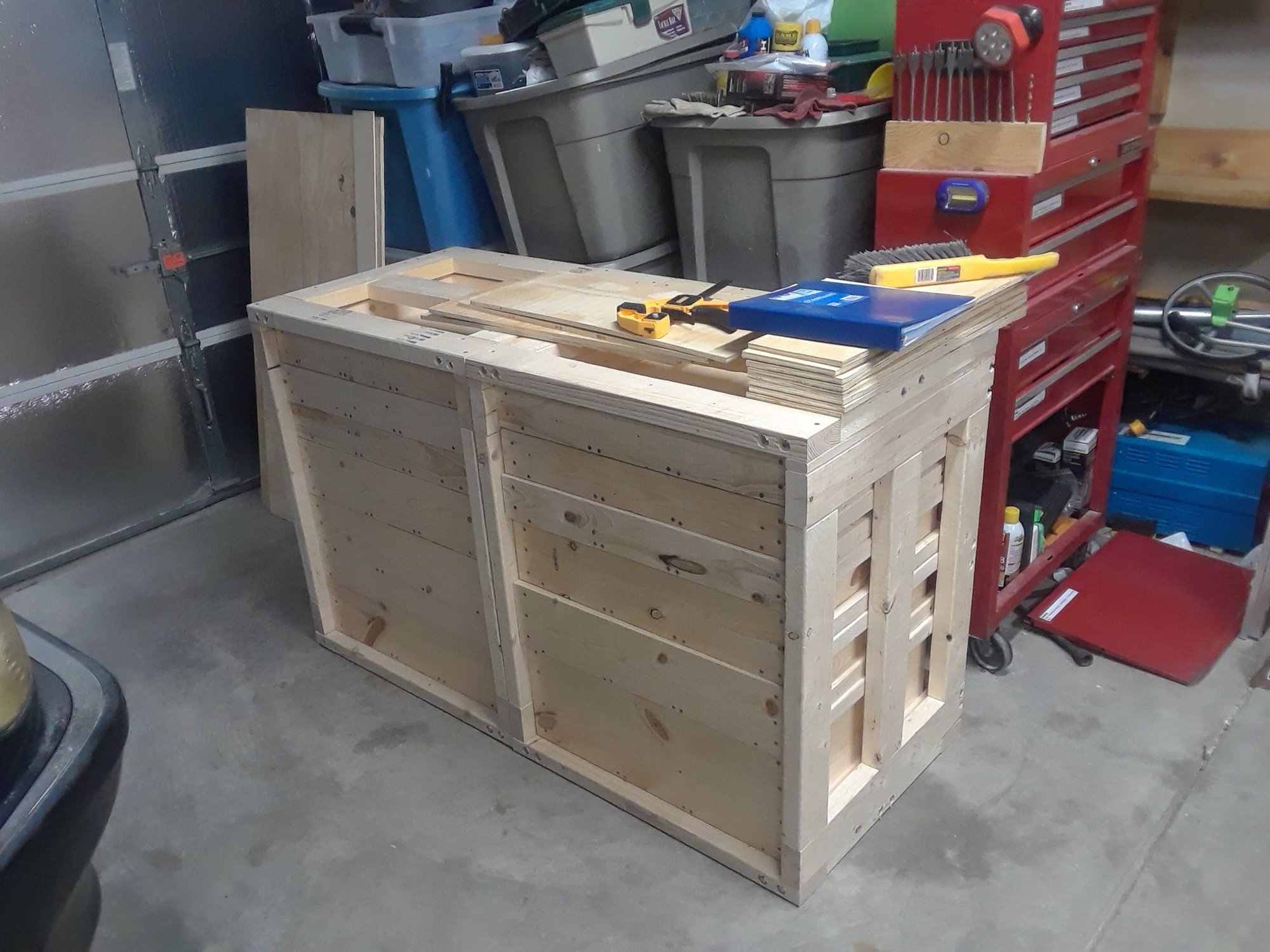

Top panel flange blocks
Test fit
I've tested the latches and they are solid! When linked, there is no wiggle on it at all and they are effortless to unlatch. The bolts are there just to keep it from coming undone by accident. Pretty clever solution for $7. Now I'm just waiting on tool batteries to finish charging before attaching all of the panels in preparation for paint. Gonna be a busy night.

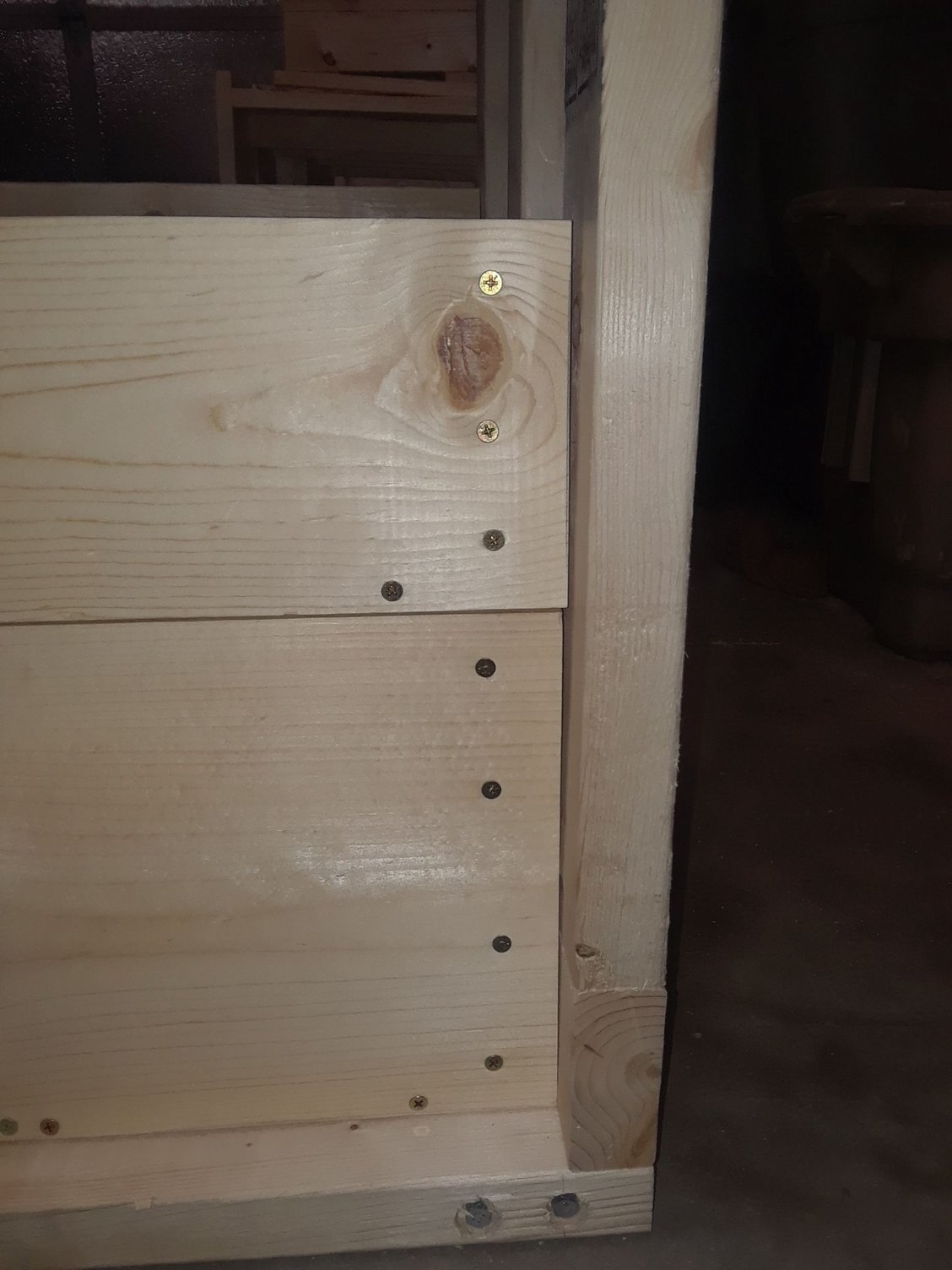

Been busy with the last few panels, getting everything solid and secured into place. Yesterday and today were spent caulking between the 2x4s and plywood panels. As you can see here, there's a few gaps that needed closed up thanks to me not being the most talented person when using a jigsaw freehand, then having to fit each one with the bench grinder. Turns out it's the perfect tool for trimming edges quickly and precisely with no effort. FAR easier than a jigsaw in this case. But no matter how you slice it, it still meant 2 days with a caulk gun, popsicle stick and toothpick.
Also did ALL of the joints on the top to make it as liquid-resistant as possible.
After all of this, I'm quite glad I made it modular and easy to move. Now all that's left is to finish it with a nice paintjob starting tomorrow.

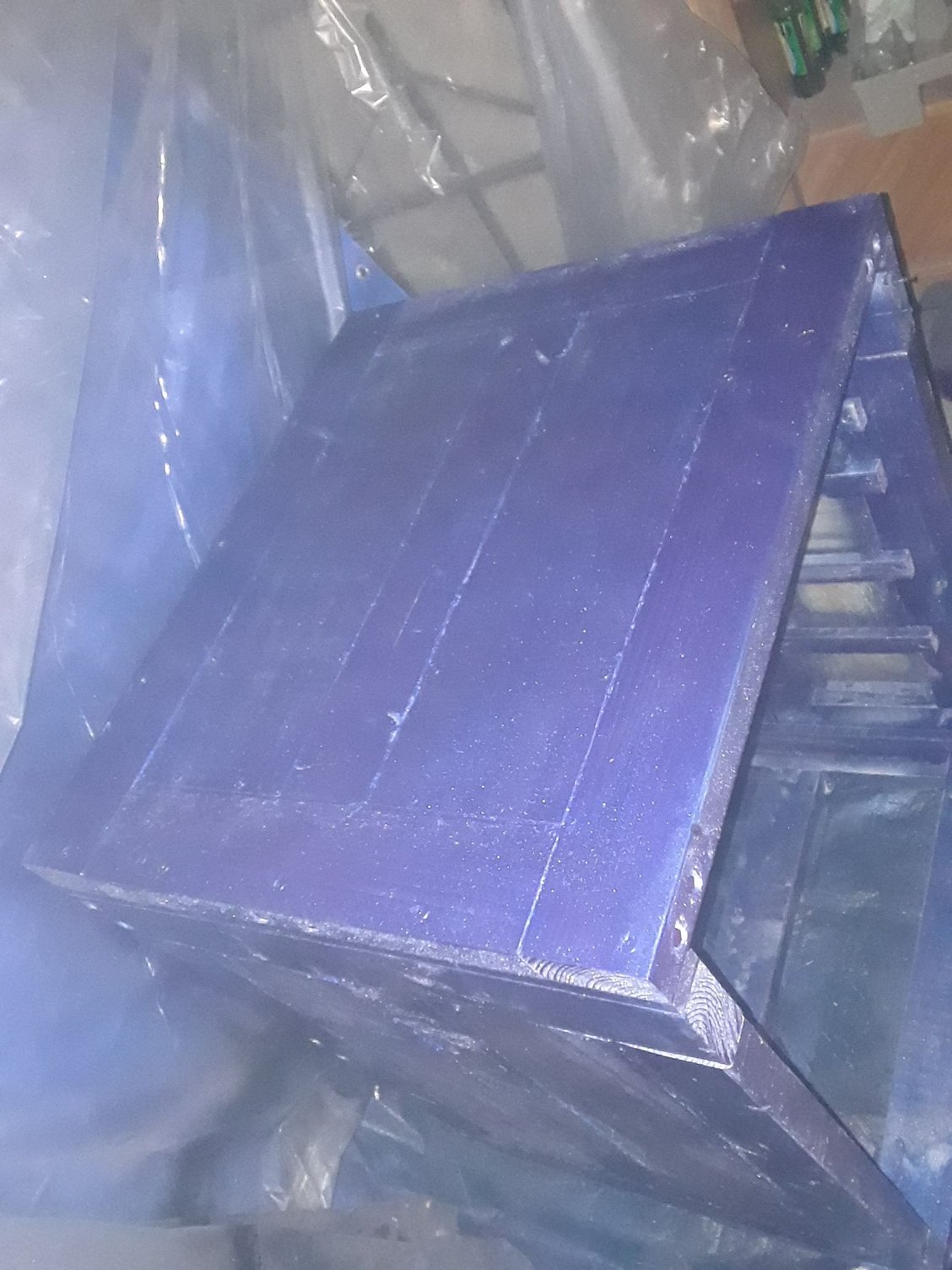

Painting, Part 2
All the drawers are dry, so test fit. Yup, good to go.
Time to break out the Blue...
First coat

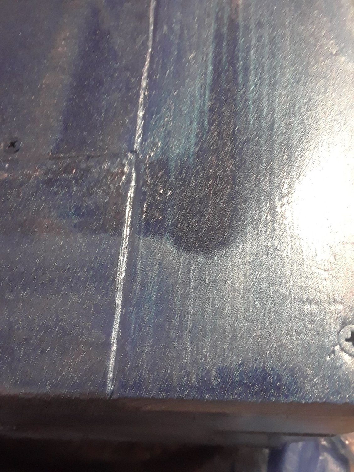

Gave it some touchup
Close-up, looks more purple in this light for some reason
Check out all that metal flake...
5 cans of black, 5 cans of blue
One down, one to go.
The money shot!
A comparison with my old box (left), and the floor covered in metal flake dust from overspray (right).

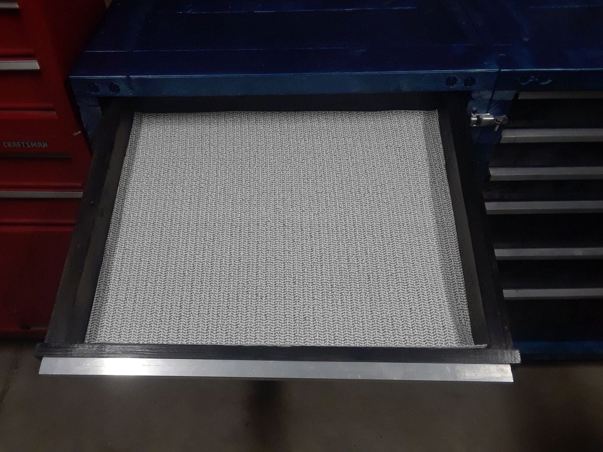

You've Got The Touch!
The box needed one more thing, so here it is...
Finally, the big moment...

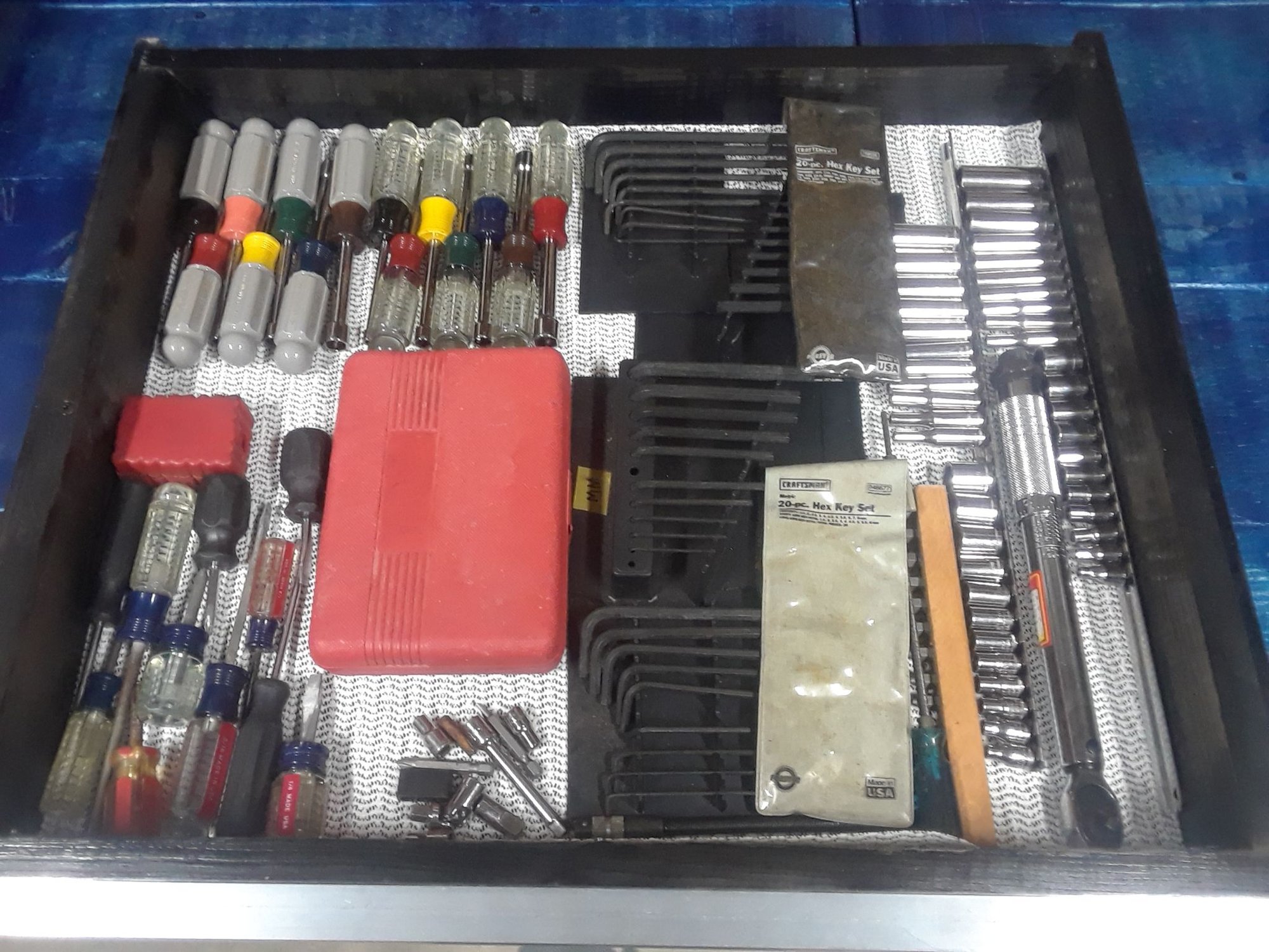

Spent the whole afternoon organizing, cleaning and de-cluttering all my tools, putting them into more logical groups vs the chaotic mess the old box was in. Now I have absolutely ALL of my wrenches in one place, even the giant BMW fan clutch wrench.
One of the bottom drawers has been deemed the Oh ***** Drawer since it has things like thread taps, a big mallet and other things needed when a project goes sideways, A couple drawers are a bit sticky once loaded, a relatively easy fix with some PTFE slide pads. But that's another project for another day
