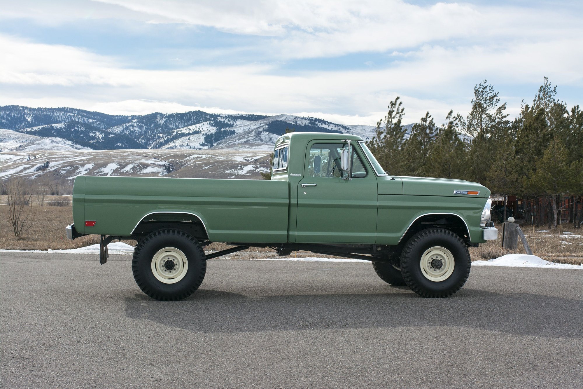

Nice looking truck- great color too. I went with 900 x 16's on mine, but then I wanted a nice size/proportion on my 1968. Last I checked I got 8.8mpg.

Thanks Jim, that's a great looking truck. I looked for a late 60's to restore when I was shopping for mine.
I drive mine pretty close to home and to beat around town so I don't have any accurate gas mileage. The tires seem to ride smoothly but considering the gearing and suspension, I don't get over 50-55 mph.

I also stay close to home with mine, it's a fair weather pickup. So my gas mileage estimate is for around town with a few secondary highway miles since I am about 10 miles from town.
I have owned it for 45 years this summer. It's not fully original any more since I added power steering, C6 automatic and 427Fe. But it's all Ford.
My dad's first pickup was a brand new 1972 like yours only Candy Apple Red, that was the beginning of my love for these F250 4x4's and I knew I was going to have one of my own some day.
I think he paid $3600.00 for his new truck.

I did have my springs re-arched many years ago and installed some Airlift air springs between front leafs and frame rail- as a precaution. So I never scrape and I had 10.50 x 16's before I switched to 900's.
My suspension components are all original OEM.
