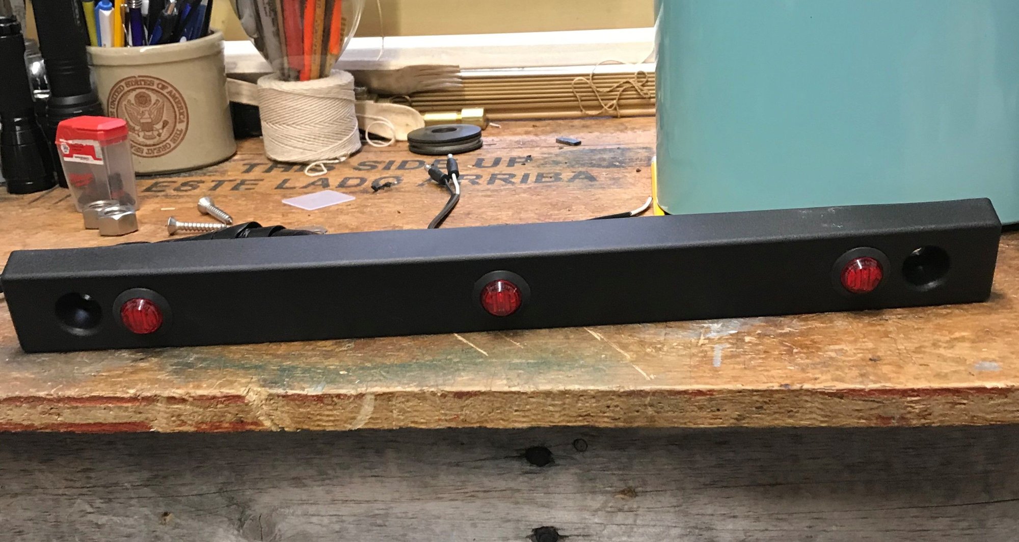

I have never tackled a Deutch plug "implant" but it looks simple enough. I did however just go on Amazon and order the crimper and pins. A bit pricey for what they are but again I wanted to do it right his time, having used crimp connectors on my other two trucks. Here is a picture of the delete cover with Maxxim 3 light 3/4" leds...I found Maxxim makes the 3 lights already wired up, they marked "up" for orientation. Thanks again smikesF350 for the link...great video!!
