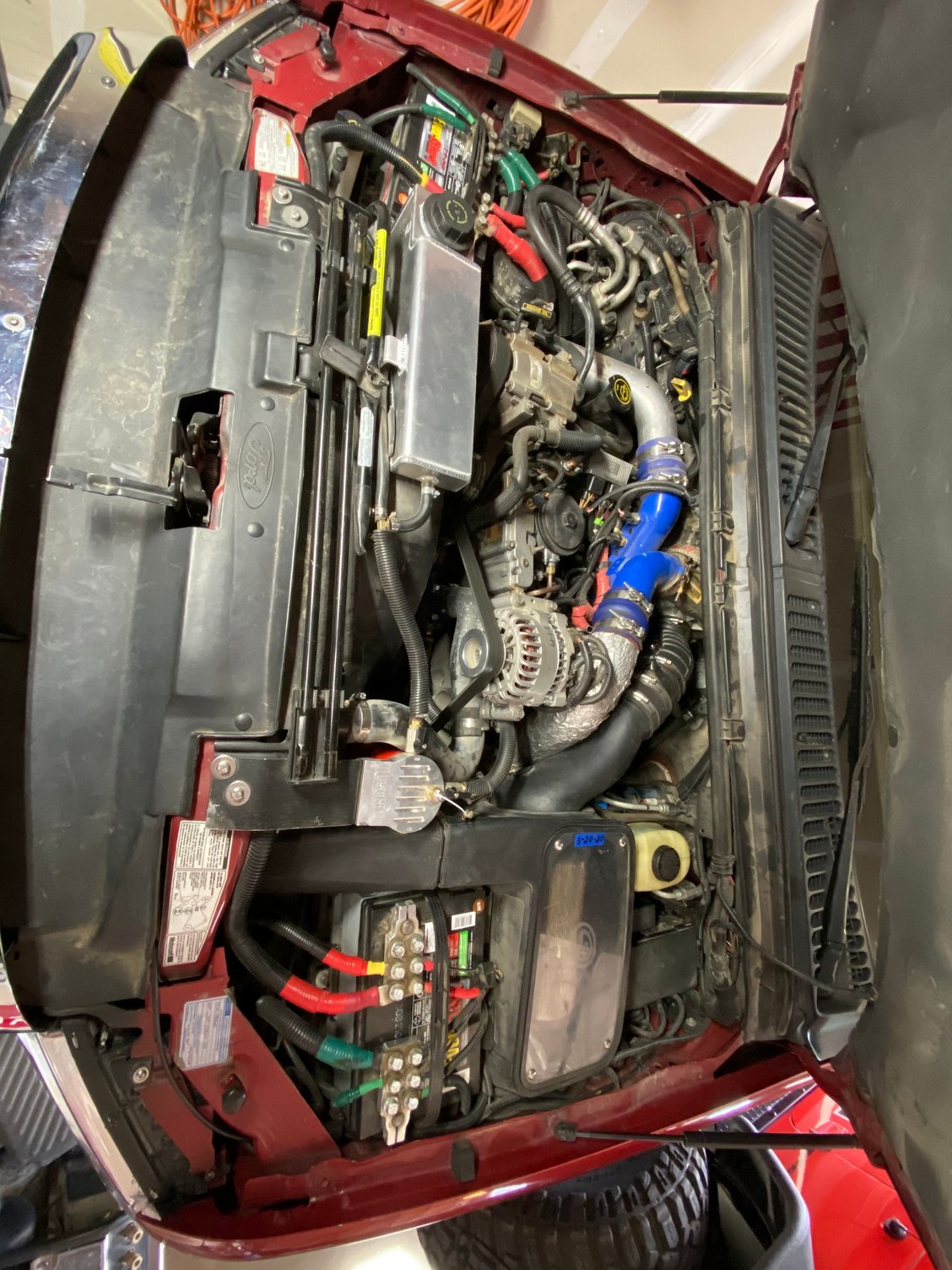

Ordered a new Outdoors RV Blackstone 260RLS with 340w solar and a generator. How well does the 12V pin on the 7way plug charge? Im seriously considering adding a 40A Redarc DC to DC charger. This is my first RV so any tips tricks. I have a upgraded alternator, batteries and cables.
