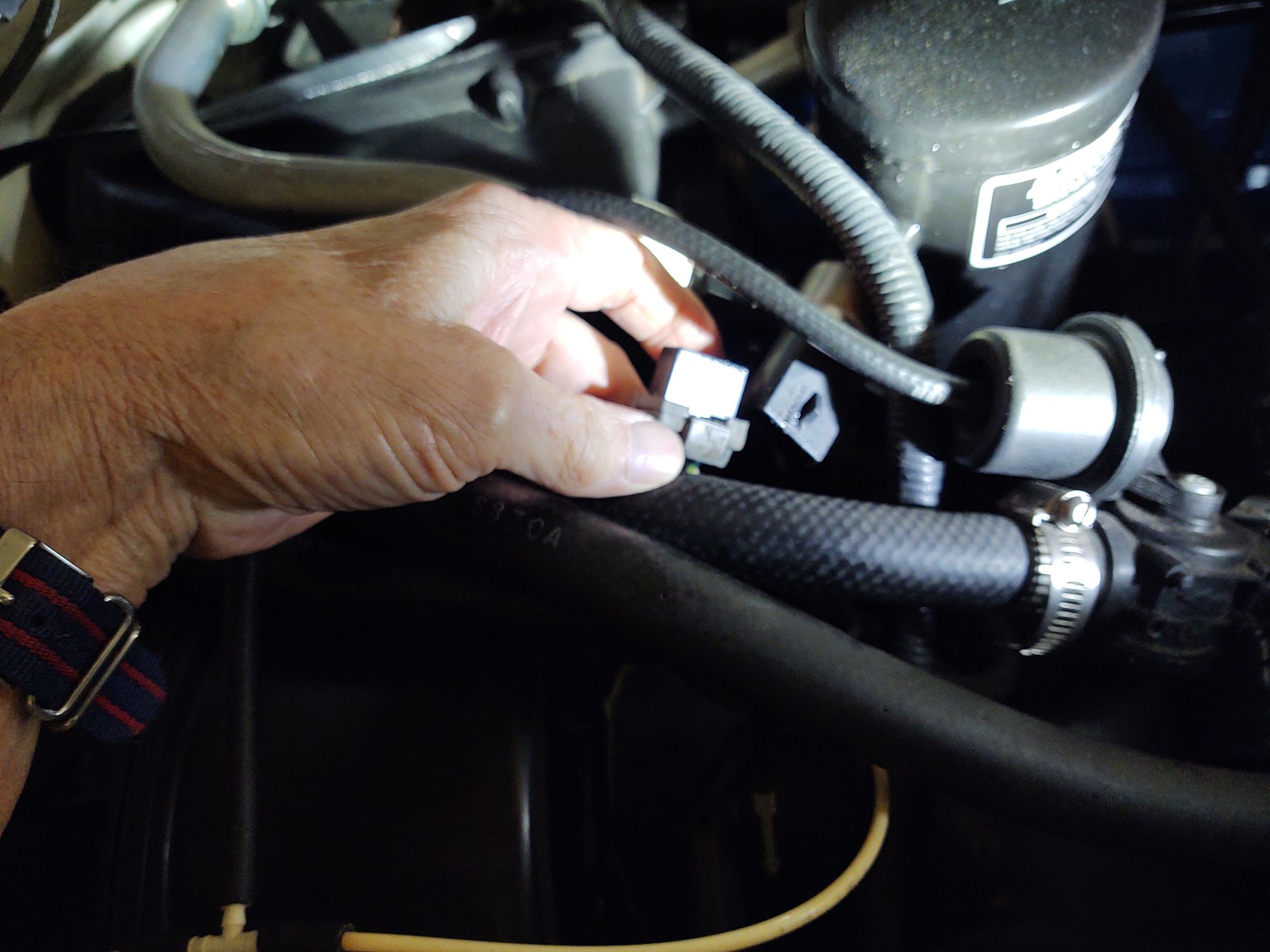

Thanks for the picture but I didn't see anything like that. yet. Either one of these by the drier it?

Yes sir, top pic of the last post.

Clutch engaged when I jumped it.
