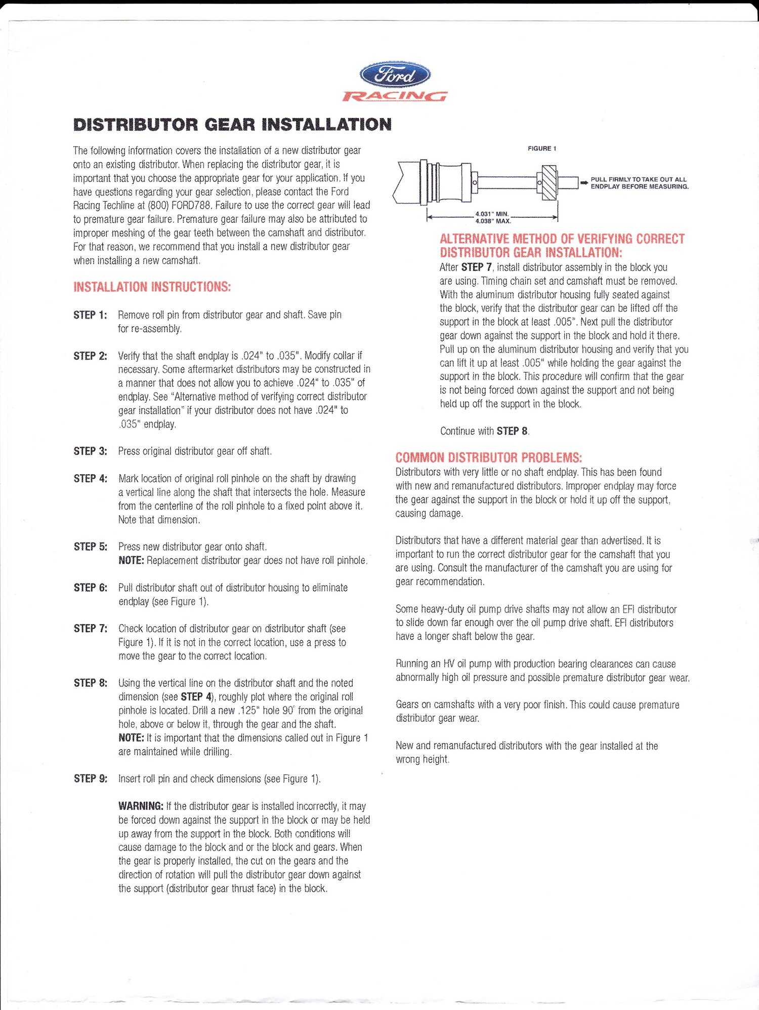

From another forum I was given measurement from tip of shaft to gear 1" and from that point to the seat bottom should be 4.991- something else. Don't remember.
From bottom of new dizzy shaft to the worm gear is .971. now there's a raised portion around the gear in the center. If we're talking teeth of the gear then .988.
From seat to gear teeth (from where the .988 ended) I have 4.933. unless you include that lip shown in the pic, but I suspect not.
Thoughts on those measurements?

Also not sure but pulling the shaft down there's some end play to make up the difference. Assuming this is from the pulling when the gears mesh.

Billy, that machined pad on the bottom of the gear rides on a machined surface bearing in the block. That's the measurement point, from the bottom of the gear to the housing collar with the shaft pulled down. As I recall there was a special Ford fixture discussed in the Shop manual for measurement. What wasn't clear was whether the fixture setup pulled or extended the shaft assembly down, or pushed it up when the measurement was made. Seems to me the shaft is extended or pulled down to take the measurement.
The idea of course is when the whole shootin' match is installed in the engine is that the distributor gear itself rides directly on the machined pad in the block, and acts like a bearing or thrust surface,has correct engagement with the cam gear, yet has at least some clearance to move up and down, that it isn't jammed into the upper housing on the high side, and spins freely, and engages fully with the oil pump rod yadda yadda.
This is why a 1/4" here or there matters, and thousandths of in. here or there matter, with those phony balogna reman distributors for example the clearances were off enough that the distributors were chewing themselves up in the housing under the advance plate, the gear and the teeth wore an odd pattern, and the pump rod was barely engaged by the distributor shaft. "Close" isn't good enough here.

Sounds good to me! Did it twice over to be sure, as a starting point of 1.5, to an end point .75 is quite a difference fromy experience with tuning bike carbs.
Here is something from Ford performance. The dimensions for your distributor are in the shop manual.
