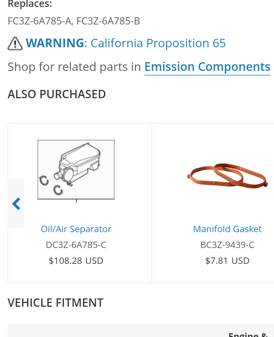

https://parts.autonationfordwhitebea...tor-fc3z6a785c
Interesting this is only for 15 and 16 according to the description.

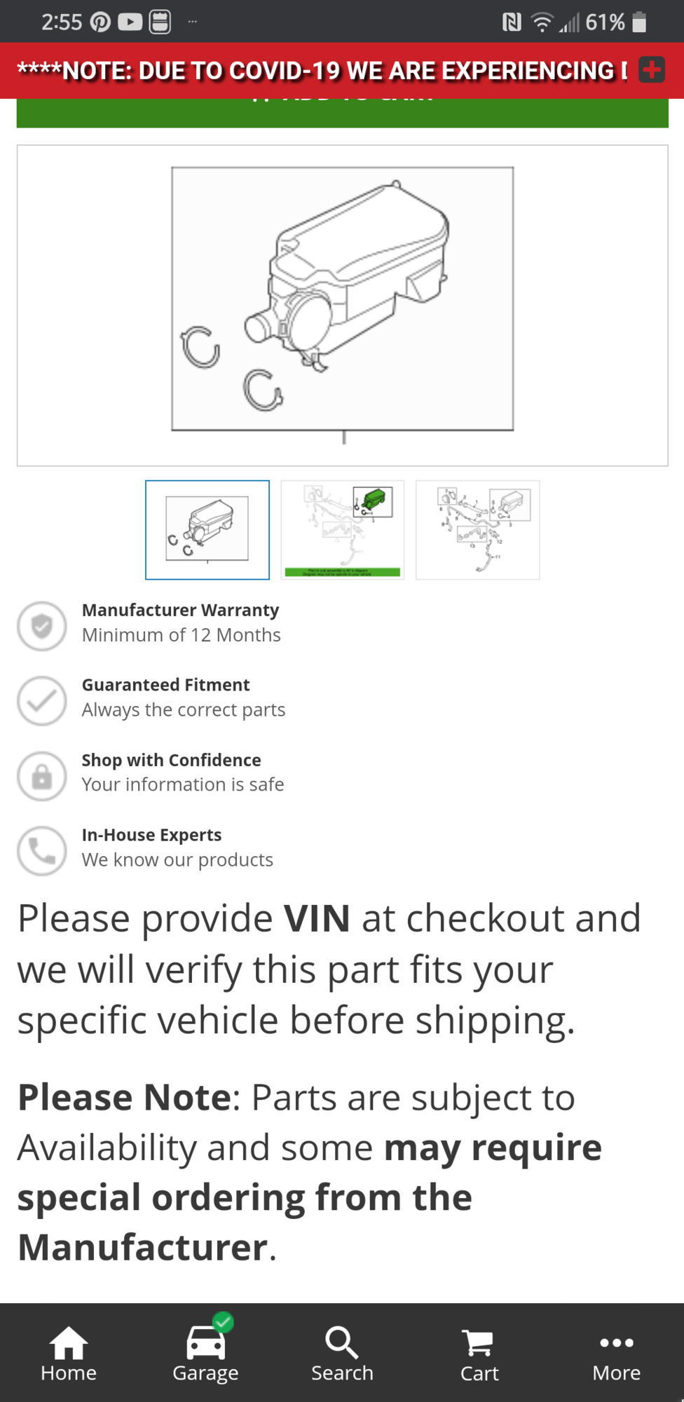

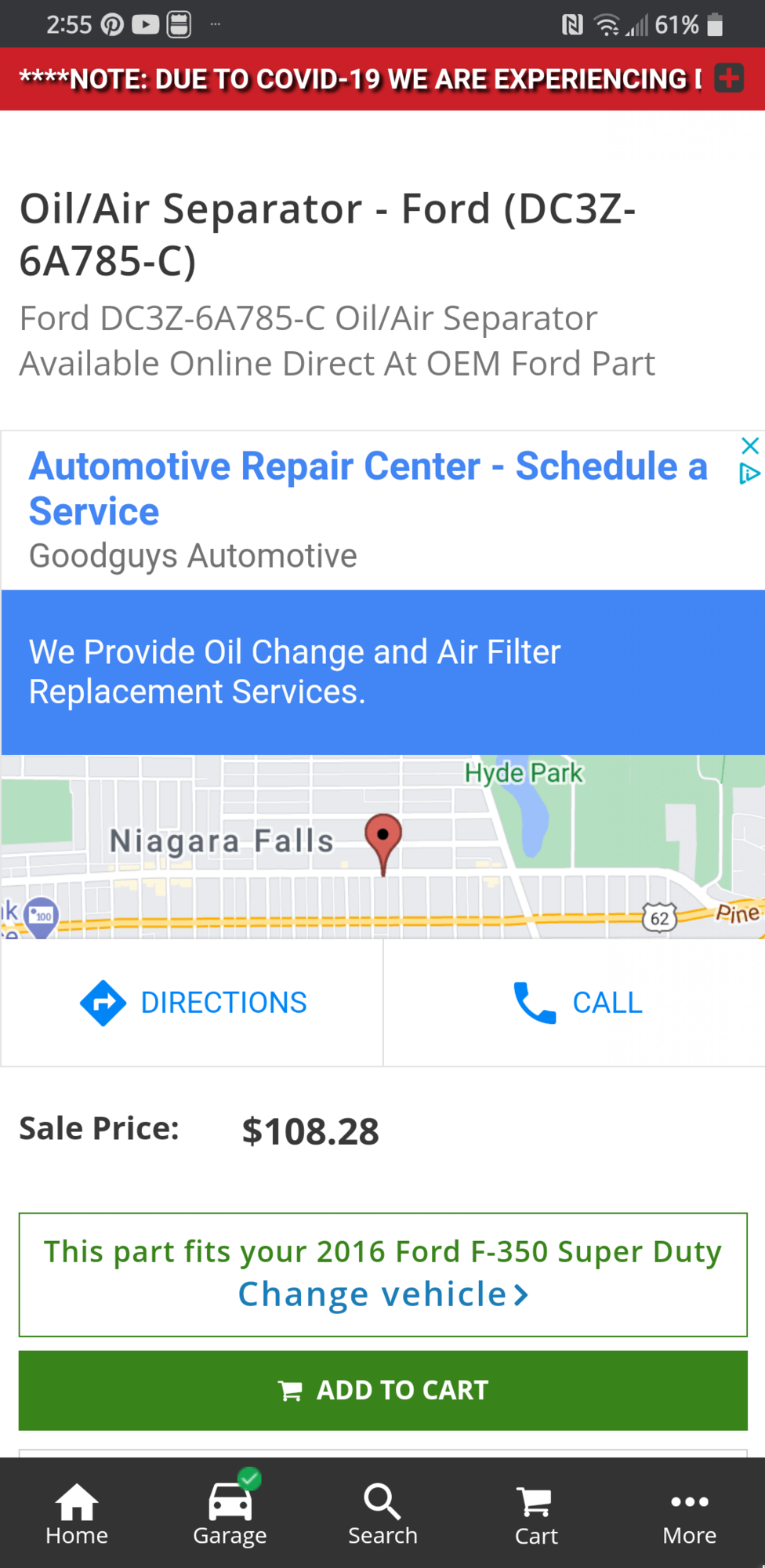

All I know is that the filter style separators have bolts on top so it can be taken apart and the sealed separators, like the one I have, do not.
https://www.oemfordpart.com/oem-parts/ford-separator-fc3z6a785c?c=Zz1lbWlzc2lvbi1zeXN0ZW0mcz1lbWlzc2lvb i1jb21wb25lbnRzJmw9NDMmbj1Bc3NlbWJsaWVzIFBhZ2UmYT1 mb3JkJm89Zi0zNTAtc3VwZXItZHV0eSZ5PTIwMTYmdD1sYXJpY XQmZT02LTdsLXY4LWRpZXNlbA%3D%3D
This is another separator that is more. The filtered one???
This is that other one...

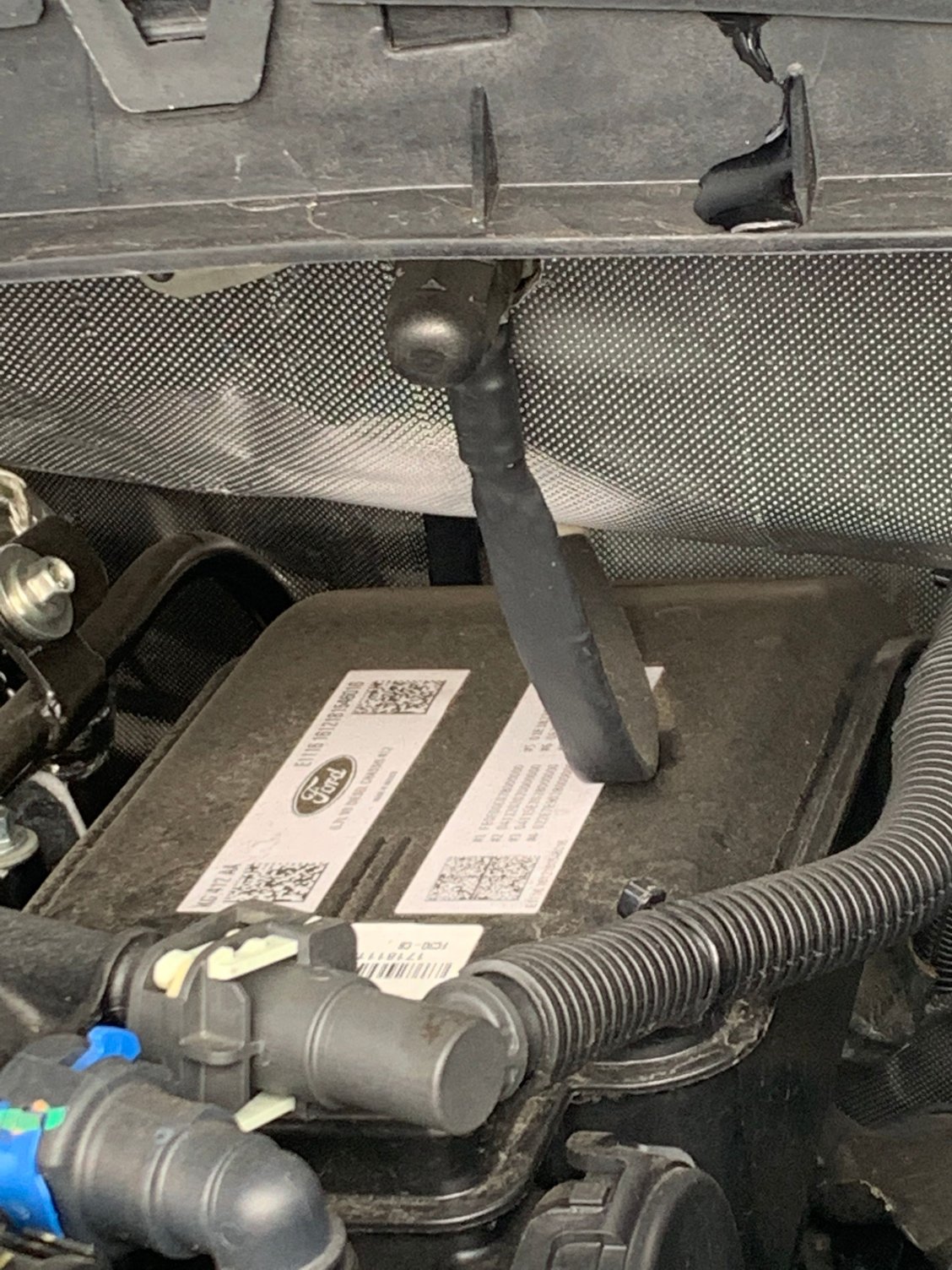

From: Midland, TX
Not a great picture, it’s hard to get a good shot. This is what’s on my 2020 F350 SRW SB. It doesn’t look like the same type as what’s in the video though. Anyone know wether this type has a filter that will need to be changed (I will periodically check for pressure under the oil fill cap.).
Old Jan 16, 2021 | 05:35 PM
senix's Avatar
senix
Joined: Aug 2008
Posts: 37,384
Likes: 1,868
From: Frederick, MD
yes all 2020's have the newer style CCV. just remove the bolts and pull the filter out/replace. Oil dipstick bolt and the ground strap removed for easier access.
Part of the weekly maint needs to be checking for excessive blow by while running as the truck ages. My suggestion would be somewhere around now for a baseline and then starting at around 30K.

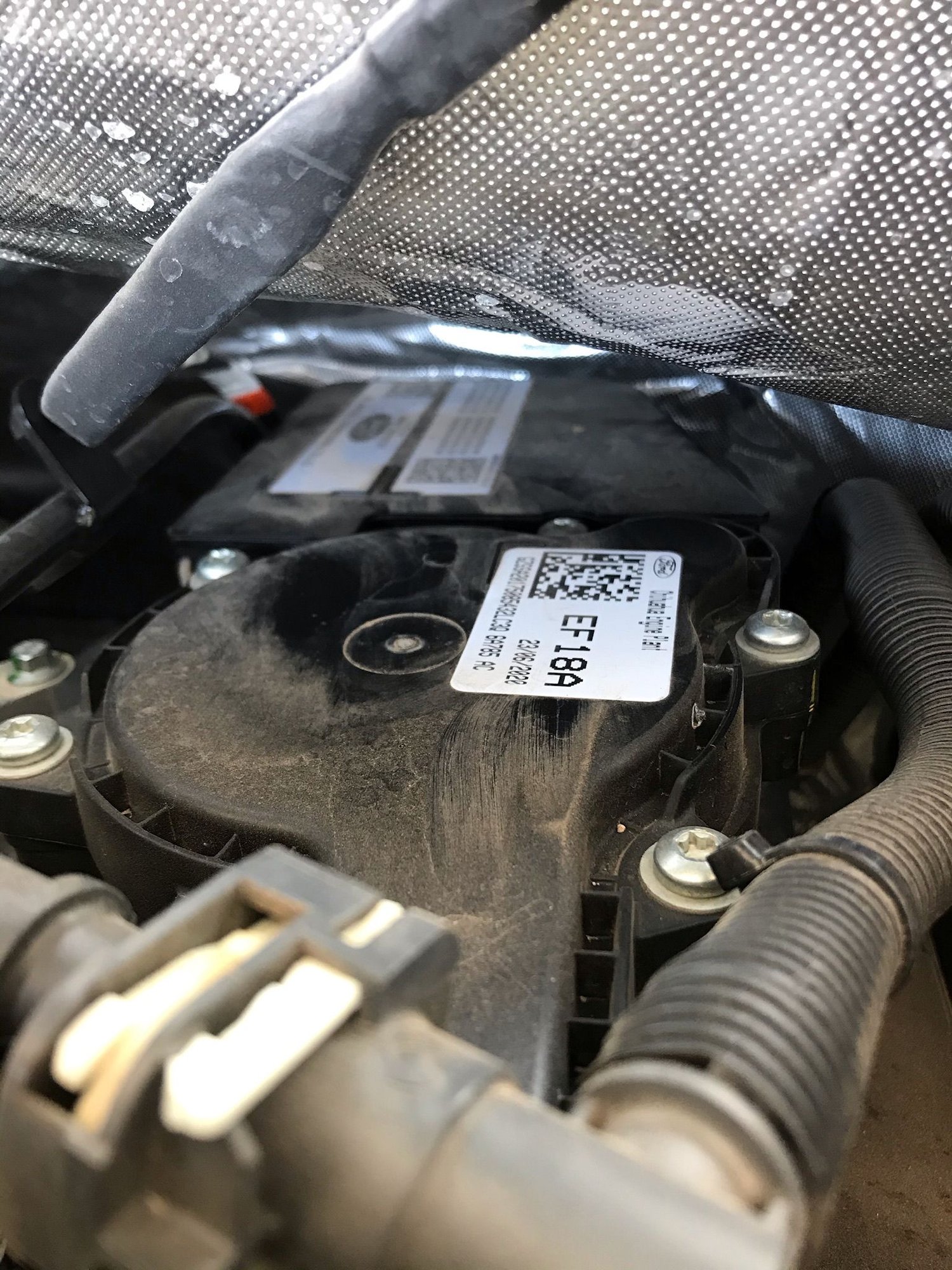

Here’s the one in my 2019. Appears No bolts
